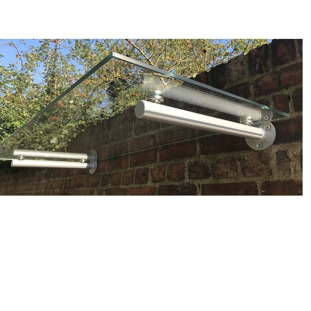

Dreadnaught Posted April 26, 2022 Share Posted April 26, 2022 Could do with a bit of guidance from the great people here 🙂 How do you secure a bolts in to a timber stud for a canopy? I've bought my entrance-door canopy (to comply with Part M, stock photo below), which takes 3x bolts for each of its two brackets. I am wondering how to attach the canopy in to the timber stud to above my entrance door. I will be screwing into a triple stud of 45 x 240 structural timber. The fixings will go through the cladding (brackets > brick slips 15mm > backing board 10mm > batten 19mm > sheathing 9mm). I am thinking of stainless m8 boltsfor a strong fixing into the studwork: 120mm, countersunk stainless steel. Do I glue in the bolt in to the stud? Any help much appreciated. Link to comment Share on other sites More sharing options...

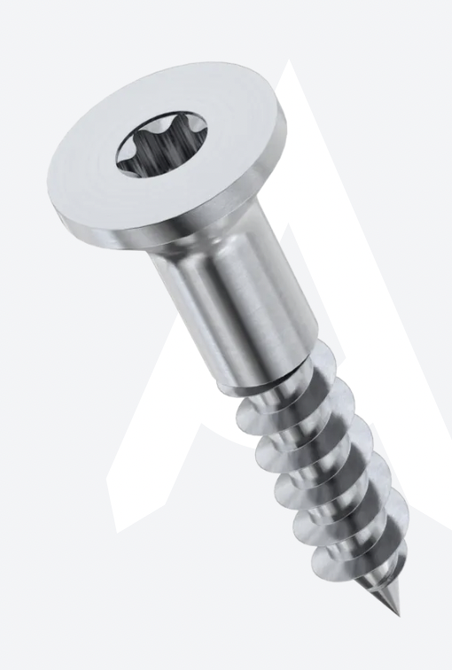

Dreadnaught Posted April 26, 2022 Author Share Posted April 26, 2022 Thanks guys! Does anybody glue their screws/bolts, belt & braces? I found these online. 120mm long, 8mm (size 16) thread, stainless steel. https://www.accu.co.uk/torx-countersunk-chipboard-screws/68993-SHKC-8-120-A2 What do you think? Link to comment Share on other sites More sharing options...
Temp Posted April 26, 2022 Share Posted April 26, 2022 They look perfect if the heads fit the brackets. I would buy a few spares and drill holes in some scrap wood of same type to work out what pilot hole to use on the real thing. Don't want them to be so tight you shear off a head when in the wall. Link to comment Share on other sites More sharing options...
Dreadnaught Posted April 26, 2022 Author Share Posted April 26, 2022 24 minutes ago, Temp said: shear off a head when in the wall Good point. I have found other stainless steel screws to be quite soft and its easy to sheer off the head with an impact driver. Link to comment Share on other sites More sharing options...

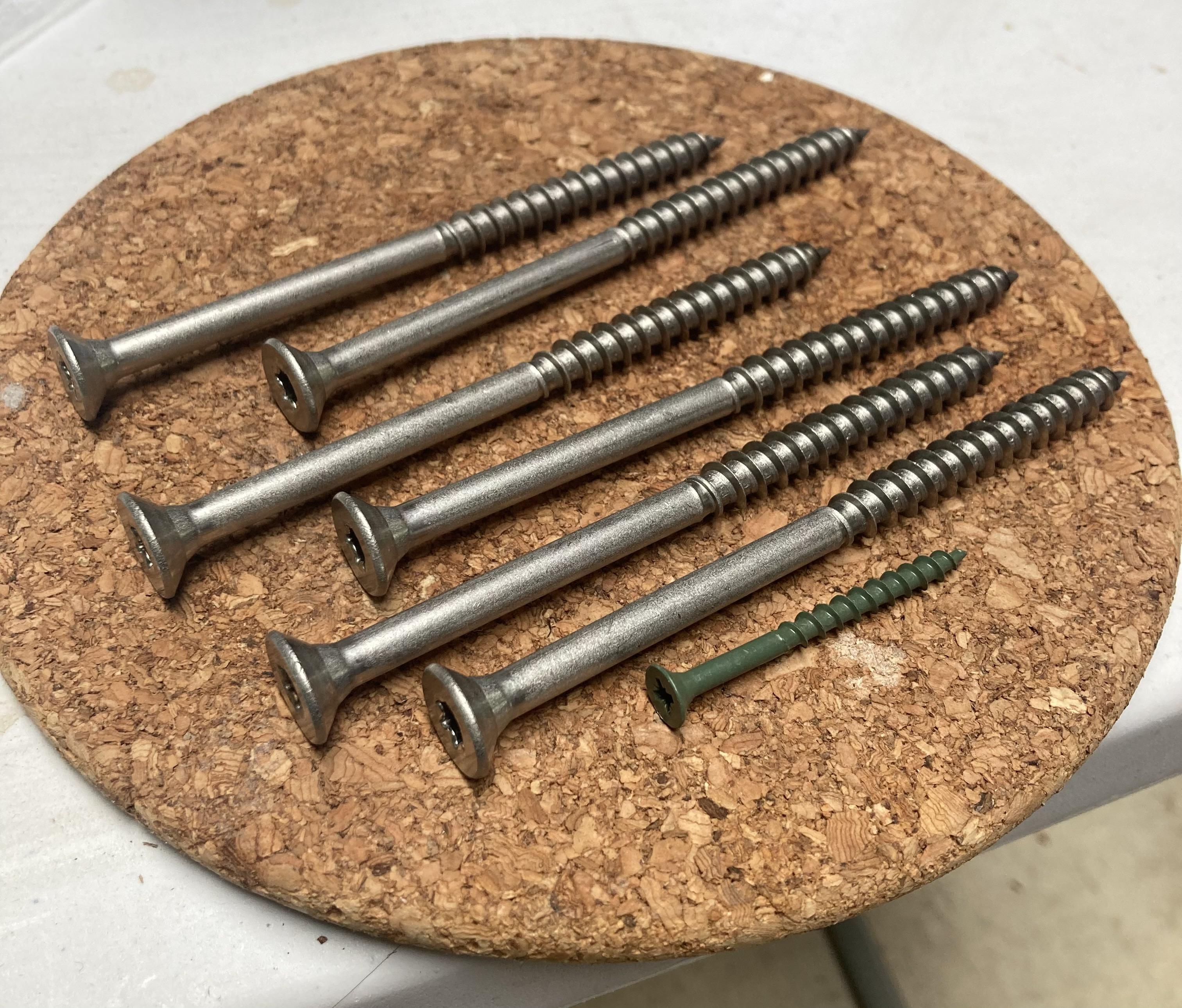

Dreadnaught Posted April 27, 2022 Author Share Posted April 27, 2022 (edited) These big boys arrived today (normal 50mm screw included for scale) … should do the job I think … Thanks for all the advice. Edited April 27, 2022 by Dreadnaught Link to comment Share on other sites More sharing options...
