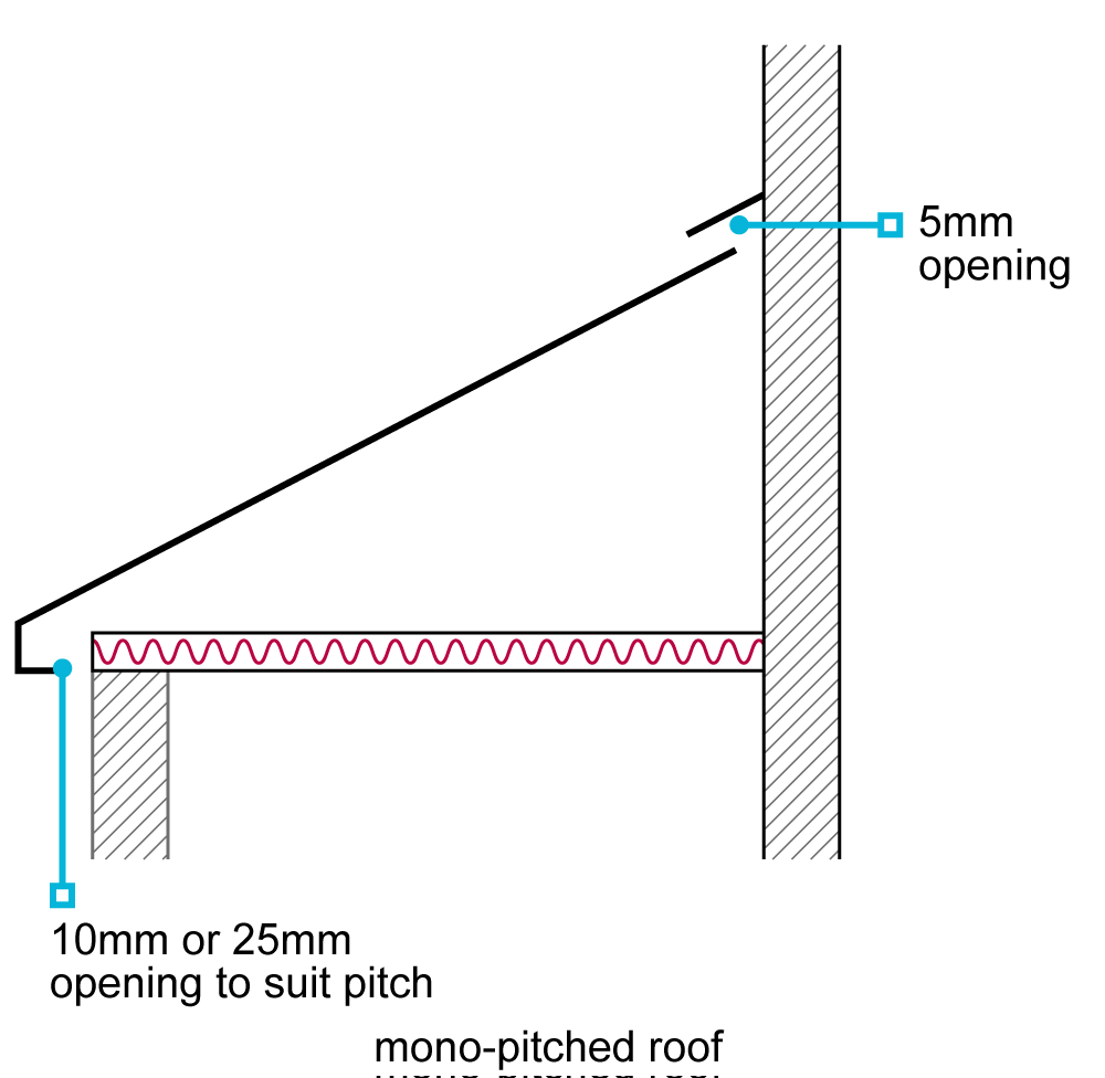

Temp Posted April 23, 2022 Posted April 23, 2022 If its a cold roof (insulation between/below rafters) the top edge should be ventilated. Is that why they left gaps under the lead? Not the best/correct solution.  Google Abutment ventilation or roof ti wall ventilation.  Example ventilation system..  https://www.wienerberger.co.uk/products/roof/systems-and-accessories/top-abutment-ventilation.html   1
notreadyforthis Posted April 23, 2022 Author Posted April 23, 2022 2 hours ago, Temp said: If its a cold roof (insulation between/below rafters) the top edge should be ventilated. Is that why they left gaps under the lead? Not the best/correct solution.  Google Abutment ventilation or roof ti wall ventilation.  Example ventilation system..  https://www.wienerberger.co.uk/products/roof/systems-and-accessories/top-abutment-ventilation.html    Thanks for the image. For our build, the internal ceiling is sloped to match the pitched roof angle and we have three Velux windows installed. The red squiggly line on your diagram doesn’t exist for our structure. Â
