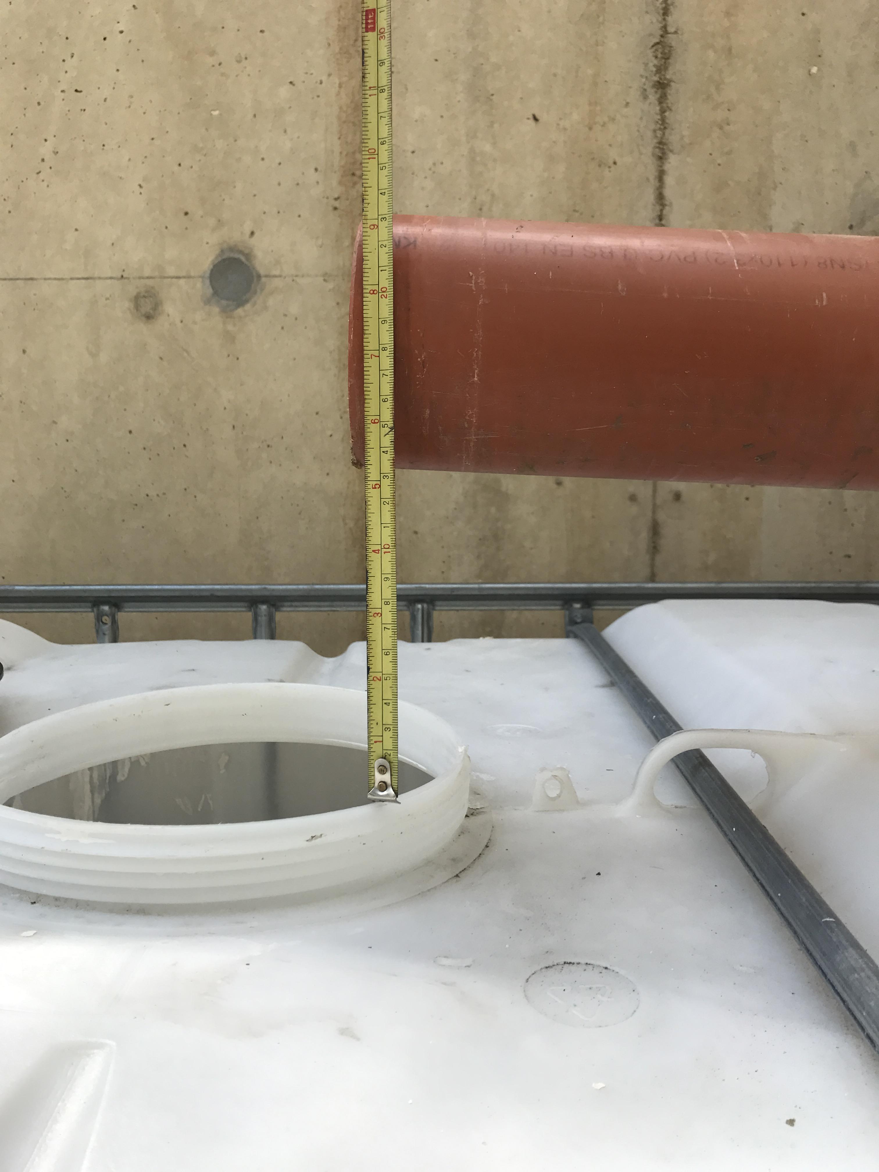

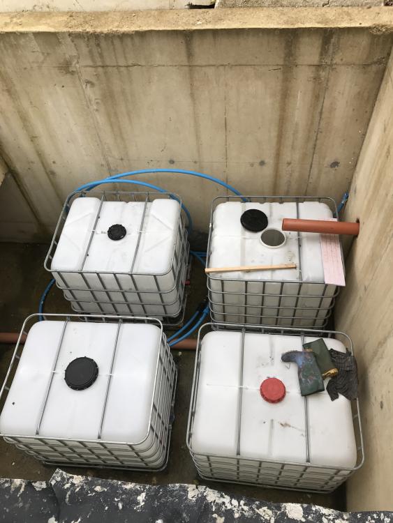

Bitpipe Posted July 24, 2017 Author Share Posted July 24, 2017 I've got this far - tanks were cheap but needed some cleaning (had PVA glue residue). One has a wooden base which I'm not crazy about but forgot to mandate plastic/metal. I have all the bits aside from the incoming filter, the one I wanted to get (that has a side access to clean the filter) is too tall so going to get a shorter 90 bend and just undo it and flush out every now and again. The incoming pipe has settled and now slopes about 2-3 deg the wrong way, we dug out on the other side to see if we could fix but it's been cased in concrete and this has obviously settled. Still works fine, quite an impressive flow when it rains and on one day last week, the tank was almost full after a few hours. Link to comment Share on other sites More sharing options...
Nickfromwales Posted July 24, 2017 Share Posted July 24, 2017 Another 2 degrees and you could connect an outside loo to that Link to comment Share on other sites More sharing options...
Onoff Posted July 24, 2017 Share Posted July 24, 2017 Could you maybe slip a 3" pipe inside that 4" one to get the fall the right way? Link to comment Share on other sites More sharing options...
Vijay Posted July 24, 2017 Share Posted July 24, 2017 How deep did you dig for the chamber?? Link to comment Share on other sites More sharing options...
Bitpipe Posted July 25, 2017 Author Share Posted July 25, 2017 There's an IC just out of shot at the top right corner where all the rainwater pipes (house and garage) converge. The outflow then descends to the pipe you see in the picture - needs to be at that level to allow a deck to run above it and be inline with a window into the basement. The jaunty angle means that there is some rain water retained in the pipe but it doesn't seem to impede the flow at all, it fairly pelts out when it's raining. Link to comment Share on other sites More sharing options...

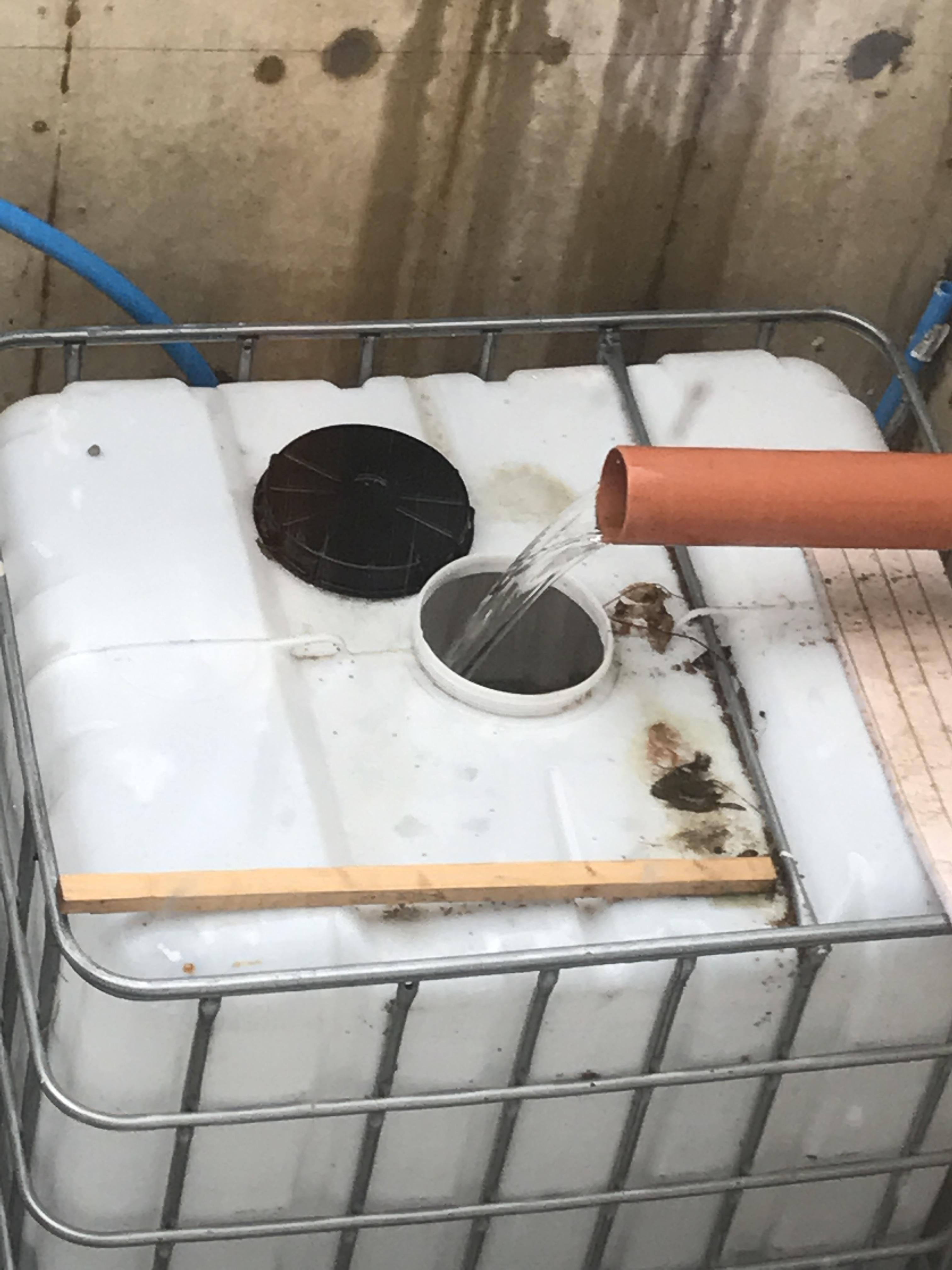

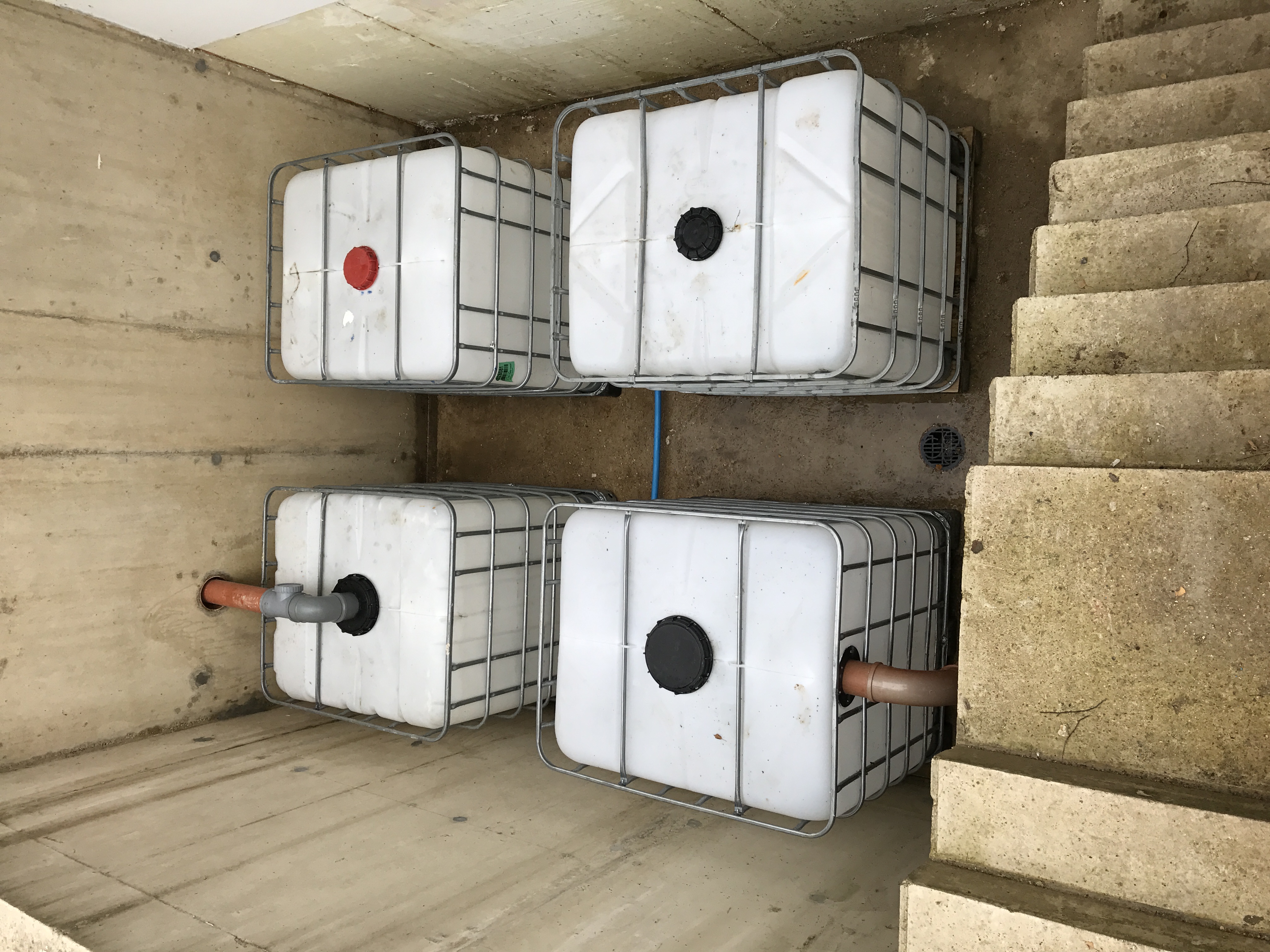

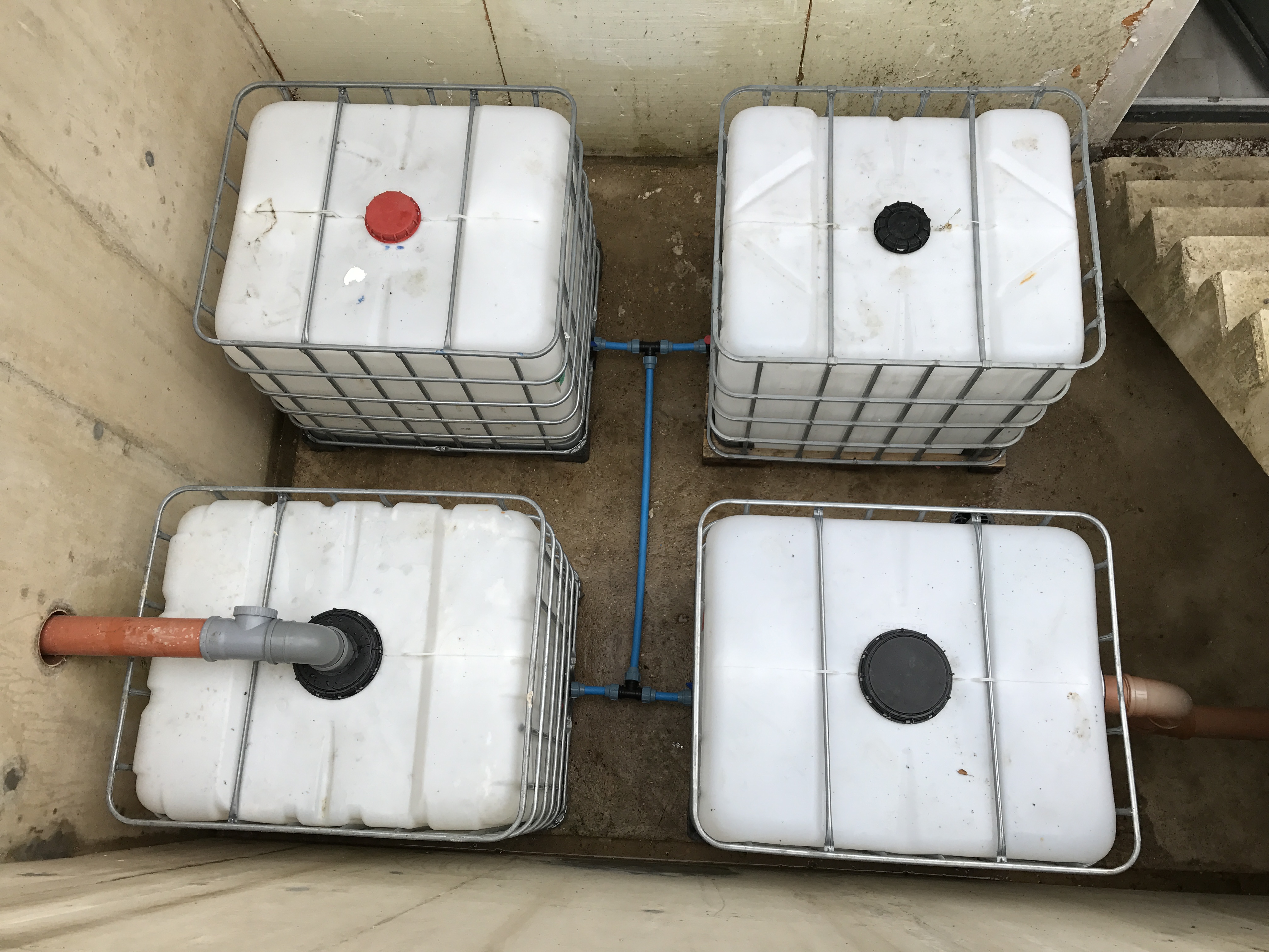

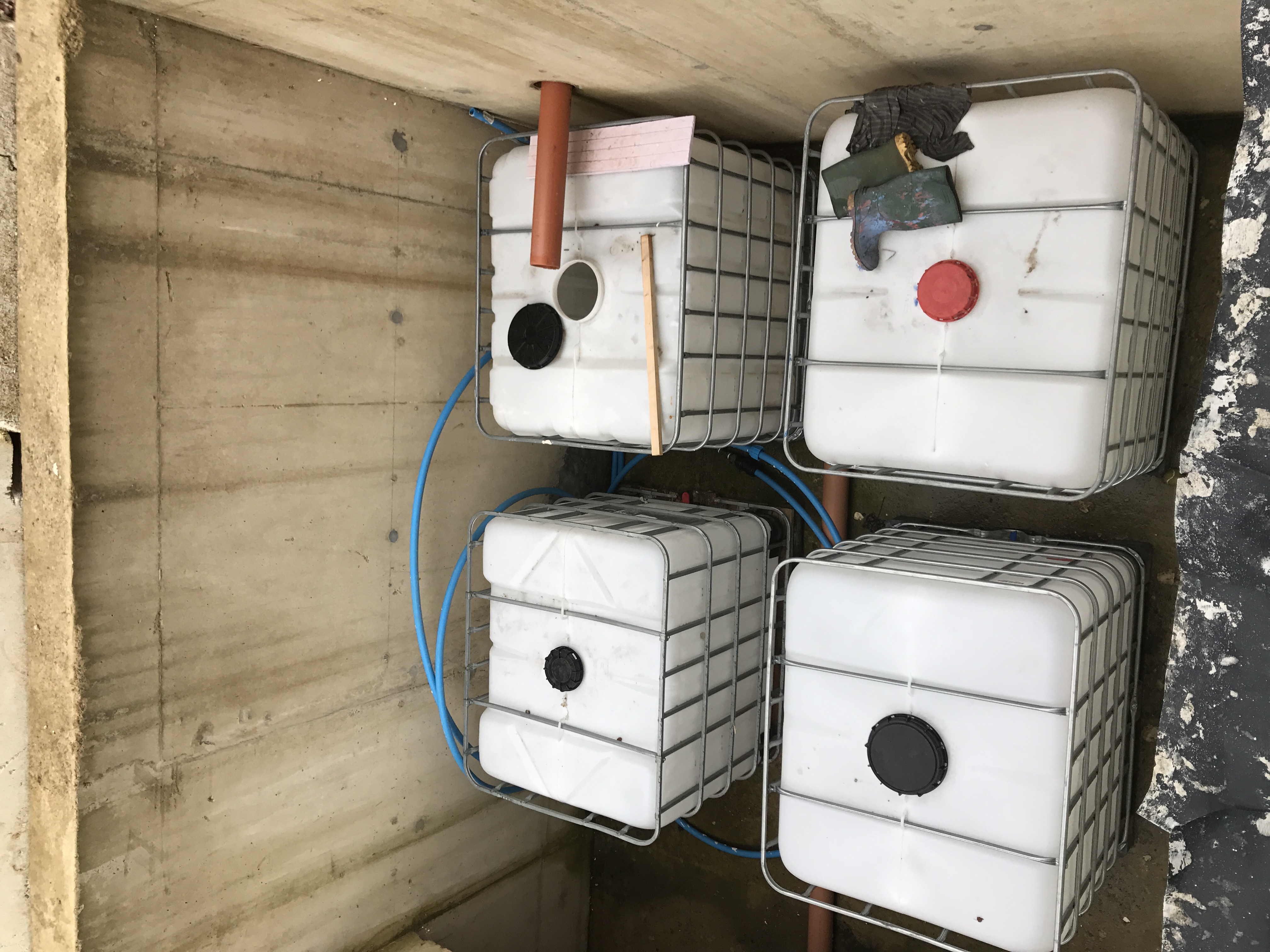

Bitpipe Posted October 9, 2017 Author Share Posted October 9, 2017 (edited) And we're done. I was waiting on the grey inlet filter and fitting from Germany - the combined fitting with the vertical terminal was too tall for me so I went for the inline (with sock inside) and the adjustable height inlet. Frank at fn-technik.de was super helpful, highly recommend his fittings. Only took a day of messing about to do all the fittings - seeing how watertight it is now. Just need some rain.... although the first pic shows how much I can collect during a good downpour - won't take long to fill them! Next job is the waterproof socket for the pump and the pump itself. Will extract from the tank with the red top. One last challenge is getting the extract hose out of the concrete box - may just have a wall mounted tap on the inside. Then I can get the deck built on top. Many thanks to @PeterW for all the advice and links! Edited October 9, 2017 by Bitpipe 4 Link to comment Share on other sites More sharing options...
