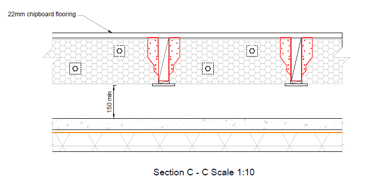

As part of installing IWI to our house, we're thinking about what we can do with the first floor joists that are currently pocketed into the external walls. We're considering shortening them by fitting a wall plate and hangers to bring them within the thermal envelope. Something like this;
Compacfoam-in-intermediate-floor-detail-
From what I understand the new plate should be bolted through the wall to the outside, which I'd rather not do. Are there any other options?

Probably a fair few more bolts than that. Your SE will need to look at the load rating for the fixings when put into the wall type you have. I'd happily bolt a ledger plate direct to the wall - but I assume in that photo they had internal wall insulation to run down behind.

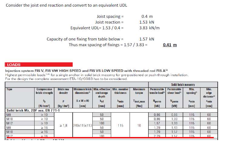

For a bit of fun here is a real world example of how you design the fixings. I have screen shotted parts of the design.
Let's take a house extension to a 1930's house.. old bricks, maybe some soft mortar. The key point is that for the fixings to realise their capacity they must be fixed nearly the centre of the brick and well away from the mortar bed. You can't control the floor height and you can't be certain that the brick coursing will be level. Thus you have to make sure that luck is on your side and you do this by adding in extra fixings. It gives the builder (maybe you) a fair chance to get it fixed safely, not slip later cause cracking, squeeky floors and so on. Remember that the new timber will shrink so while it may appear "rock solid" at the install it won't be quite so when it all dries out in a year or so.

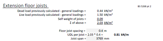

Example: Floor joist span 3769mm, joist spacing 400 mm
The above gives the load on each joist. 0.81 kN/m is about 80 kg/m run of joist. Each end of the joist is supported by a hanger attached to the wall plate. The dead load is the self weight of the floor. The live load is you, furniture, book cases, having a party and this equates to about 150 kg per square metre of floor This is a code requirement that BC expect to see.
The above works out the maximum spacing of an M12 fixing in a typical 1930's brick with the plate hard against the brick face.  Each fixing can carry a permissible shear load of ~ 157 kg. But the test data is based on a European masonry size, not an imperial size! Thus while we can adjust do other calculations we apply some conservative Engineering judgement. The result is a detail like this. The detail below is a ground floor, vented solum below with PIR insulation.
You can see that in actual fact you need quite a lot of fixings to make it fly and safe for the design life of the building.
