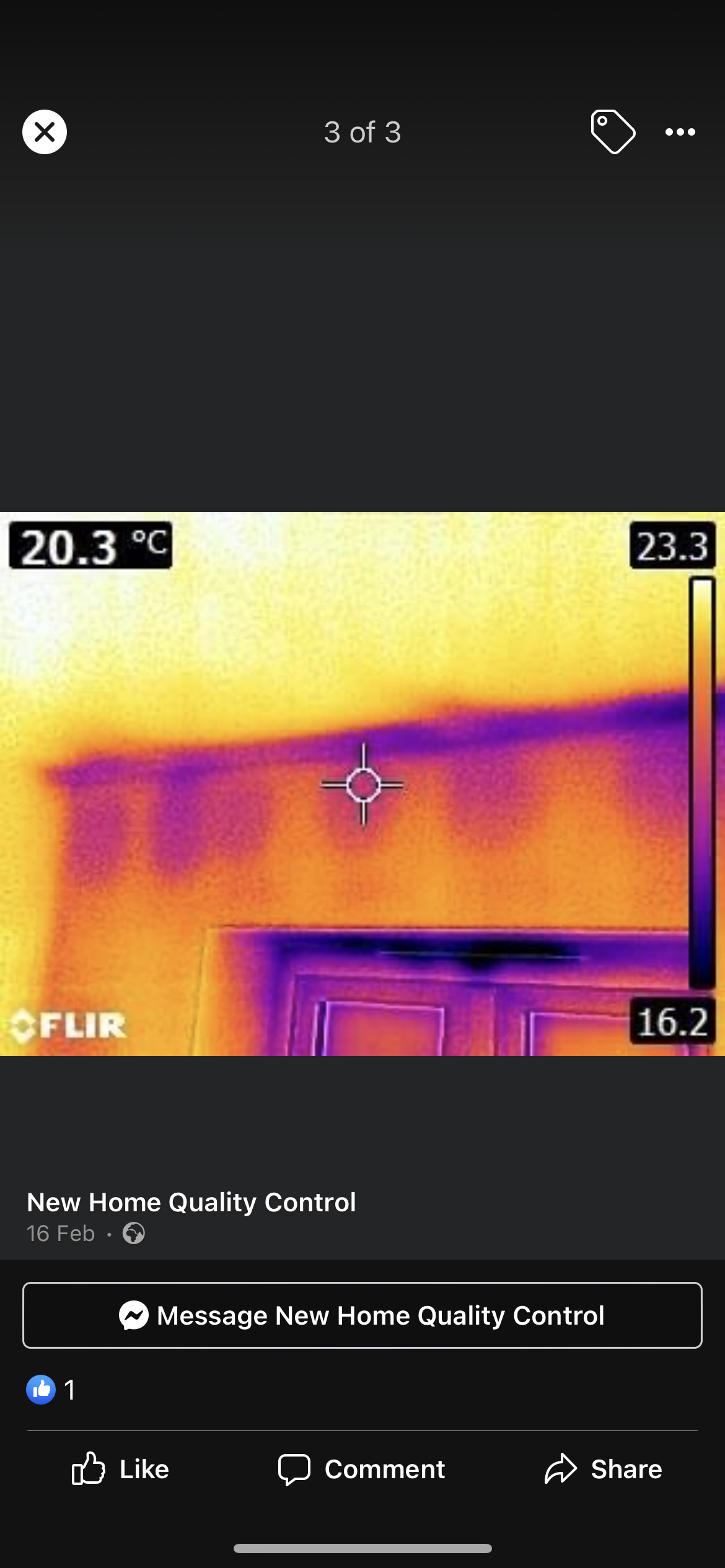

Littlebig Posted February 27, 2023 Author Share Posted February 27, 2023 In all fairness this was the first time a someone has given such a detailed explanations about his findings. He also mentioned that instead of 8 bags of insulation material(as per specification) the used 9 so he was very confident in saying there is no problem with insufficient insulation. I also mentioned he suggested draughts as the main issue, this was after he finished his inspection and the 2 main points of draughts was the main front door and the loft hatch and this was concluded after the thermal imaging survey and it was obvious on the pictures. Also in the small bedroom and bathroom was noted that the loft insulation has been pulled too far back to unblock the vents and has caused an issue where cold air could penetrate the cavity and all it needs doing is to fold the loft insulation into the cavity. (The attached picture is just an example of what I was able to see on his camera.) But I’m not sure this is the reason for the cold air in there, so again someone knowledgable maybe will be able to say what is the cause. Link to comment Share on other sites More sharing options...

Littlebig Posted February 27, 2023 Author Share Posted February 27, 2023 4 hours ago, MikeGrahamT21 said: Thats an excellent thermal image of why dot and dab is so bad!! Without ripping it all off, you could drill holes along the perimeter all way round, but only where it sounds hollow, the solid bits will be where the dots are, and inject some FM330 airtight expanding foam, but not silly amounts, this should seal the gaps up. In my experience though, its slightly pointless, you would need to do top, bottom, and corners, but even then, a crack in the mortar or blockwork (very common with most traditional masonry construction methods), will again let air circulate in the cavity between plasterboard and blockwork. Its a very hard problem to solve without taking everything off and wet plastering. You may be lucky and get a parge coat which would possibly solve the cracking issue, but if its a developer house, i wouldn't expect that. Expanding foam top bottom and corners inbetween the dots may give you some resolution. I guess your explanation is confirming my first thought. The constant ribbon of adhesive along the top that should prevent airflow and thermal bypass is basically not there? Unfortunately like your saying not an easy fix and will have to contact the builder and see what their proposition will be to resolve it. Link to comment Share on other sites More sharing options...

MikeGrahamT21 Posted February 27, 2023 Share Posted February 27, 2023 1 hour ago, Littlebig said: I guess your explanation is confirming my first thought. The constant ribbon of adhesive along the top that should prevent airflow and thermal bypass is basically not there? Unfortunately like your saying not an easy fix and will have to contact the builder and see what their proposition will be to resolve it. absolutely, there should as a minimum be a continuous bead of adhesive along both top and bottom of the plasterboards, pretty sure that’s been the official guidance from PB manufacturers for a good while Link to comment Share on other sites More sharing options...

Radian Posted February 27, 2023 Share Posted February 27, 2023 Your thermal image appears to show a poorly sealed window trickle vent. I suspect that if you apply finger pressure to it, you'll notice a reduction of noise coming from outside. Maybe not fitted correctly, or in common with most trickle vents, just crap. Link to comment Share on other sites More sharing options...
AliG Posted March 7, 2023 Share Posted March 7, 2023 On 27/02/2023 at 13:16, Littlebig said: Also in the small bedroom and bathroom was noted that the loft insulation has been pulled too far back to unblock the vents and has caused an issue where cold air could penetrate the cavity and all it needs doing is to fold the loft insulation into the cavity. This is the problem with eaves ventilation, made worse by the house not being timber frame. At least that would ensure insulation to the top of the wall and not have dot and dab plasterboard. Looking at the picture, it appears that you have cold air getting behind the plasterboard at the top and the insulation ends before the end of the ceiling. The question is can you actually get it into the cavity without blocking the vents. Also if those vents were working you wouldn't;t have condensation in the roof. Sealing the top of the dot and dab should be relatively easy. If you can access the top edge of it you could seal it with spray foam from there or by drilling small holes and injecting foam. It won't be perfect but should make a big difference. Clearly the loft insulation has to extend to the edges also. Due to the issue with the eaves being ventilated, I wonder if cutting pieces of PIR to sit between the ceiling joists would be a better idea. Looking at the pictures it also appears that despite their claims there is not enough insulation in the walls. If there was you wouldn't be able to see all those voids. Link to comment Share on other sites More sharing options...

j_s Posted March 17, 2023 Share Posted March 17, 2023 If youve got scaffolding up, can you remove/push up the first row of tiles and fix the entire perimeter of wallplate to ceiling junction and cavity to loft insulation join. I did this when we were replacing the soffits and facias. Hell of a job but worth it. I taped and used airtight expanding foam between wall plate and plasterboard. We then added Dritherm 32 cavity batts to the cavity where it was missing as well as enough to over lap the wall plate. We used wall ties to hold the insulation tight in those areas. In the hard to insulate areas where the hip sat on the wall plate I added pir board and foamed it in. We took all the plasterboard off the external walls and used airtight paint and foam from below and overboarded the ceiling. All made a massive difference. Link to comment Share on other sites More sharing options...
