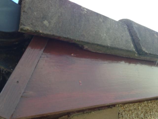

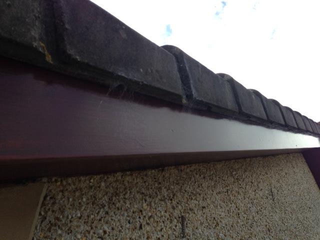

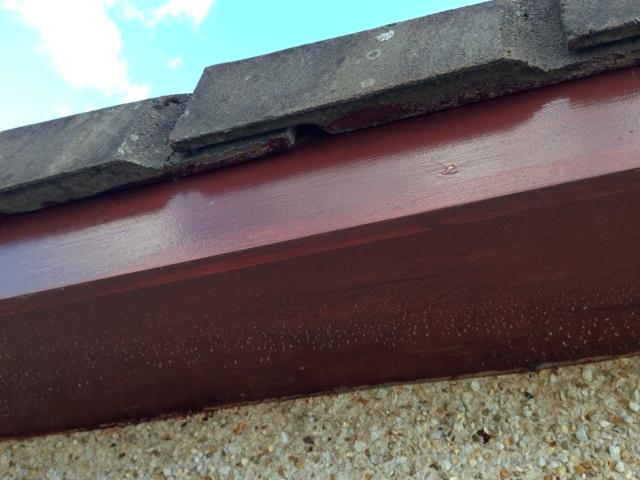

B52s Posted June 11, 2017 Posted June 11, 2017 I'm looking to (DIY) install uPVC over-cladding on top of existing sound fascia boards in order to reduce future high level maintenance (re-painting every 3 years or so). I'm looking for some advice on how to finish off the over-cladding on the gable-ends where the over-cladding will butt against the underside of the concrete roof tiles. I see this as potential weak point which could result in rain ingress due to the uneven profiles on the underside of the roof tiles. I was considering a line of silicon mastic where the two surfaces meet, but I am not sure if this is the best way to tackle this issue, particularly given that mastic should be replaced every 5 years to maintain integrity, which seems to defeat my goal of having zero high level maintenance. For information, I have attached some photos which shows the existing timber facia and the underside of the roof tiles.
PeterW Posted June 11, 2017 Posted June 11, 2017 Any chance you can move the tiles ...? It's an unusual design as you would normally have a cloaking board but it looks like the tiles are laid on the top of the wall ..?
Jeremy Harris Posted June 11, 2017 Posted June 11, 2017 (edited) I think the easy solution is to use powder coated, or anodised, aluminium cladding, rather than uPVC. I think you could probably slip that up under the tiles and just bond it to the fascia, perhaps with screws into the soffit. It might cost a little more in materials, but would be a lot quicker to fit, which may offset the extra cost. You can get aluminium folded, with a drip rail, into an L shape, to clad the soffit as well, and make for a neat looking job that then would be maintenance free. Edited June 11, 2017 by JSHarris
B52s Posted June 11, 2017 Posted June 11, 2017 On 11/06/2017 at 15:10, JSHarris said: I think the easy solution is to use powder coated, or anodised, aluminium cladding, rather than uPVC. I think you could probably slip that up under the tiles and just bond it to the fascia, perhaps with screws into the soffit. Expand JSH, that sounds a good option that I hadn't considered! ...I would be grateful if you could you point me to any websites where I can purchase the required materials? I don't really want to cover the existing soffit boards, as over the 20 years + I have been in the house, they have shown no signs of deterioration, albeit I did re-paint them 2 years ago, although i didn't feel this was necessary at the time. I just want a returned lip on the over-cladding that returns about 20mm neatly under the bottom edge of the fascia board. PeterW, I don't want to touch the roof tiles as I feel this could lead me into problems that would be beyond my capabilities, also, I have this issue on all four of the gable ends so I feel this would be a mammoth task, for me anyway.

B52s Posted June 12, 2017 Posted June 12, 2017 On 11/06/2017 at 13:59, PeterW said: Any chance you can move the tiles ...? It's an unusual design as you would normally have a cloaking board but it looks like the tiles are laid on the top of the wall ..? Expand PeterW, I'm swinging back to your suggestion of moving the tiles. After doing a little digging I believe the tiles on the gable end are called concrete cloaked verge tiles. Do you think it would be possible to prise (drag) the tiles away from the current timber fascia board (gently using a bolster or pinch bar) by about 7mm to allow a 9mm uPVC fascia overcladding to slip underneath, or would I be in danger of stressing the tiles which might result in hairline fractures at some future date? Your further thoughts would be appreciated.
ProDave Posted June 12, 2017 Posted June 12, 2017 On 12/06/2017 at 10:25, B52s said: PeterW, I'm swinging back to your suggestion of moving the tiles. After doing a little digging I believe the tiles on the gable end are called concrete cloaked verge tiles. Do you think it would be possible to prise (drag) the tiles away from the current timber fascia board (gently using a bolster or pinch bar) by about 7mm to allow a 9mm uPVC fascia overcladding to slip underneath, or would I be in danger of stressing the tiles which might result in hairline fractures at some future date? Your further thoughts would be appreciated. Expand The tile is almost certainly nailed down and there won't be that much movement in a nail hole. Also if you could move it, you would be parting the interlocking joint to the next tile. I echo the suggestions above to use aluminium which I am sure would slip between the tile and fascia.
B52s Posted June 12, 2017 Posted June 12, 2017 On 12/06/2017 at 11:15, ProDave said: The tile is almost certainly nailed down and there won't be that much movement in a nail hole. Also if you could move it, you would be parting the interlocking joint to the next tile. Expand I don't think the concrete interlocked tiles are nailed down. It was my understanding that the tiles are merely laid (interlocked) on the roof? Because the gable end tiles are cloaked verge tiles I assumed that they were designed to suit various roof sizes and therefore will have a degree of tolerance/float to enable the cloaked verge tile to be positioned to suit each particular roof. But perhaps the interlocking tile profile does not provide the movement that I was expecting.
ProDave Posted June 12, 2017 Posted June 12, 2017 The tiles are all fixes width with interlocking tiles. There is about 1 or 2mm "play" in the interlocking joint, so over the width of a typical roof you cam get a bit of adjustment. Half width tiles are also available to get you closer. But you wont get much movement at one joint. The tiles should by current standards be hailed at the top and clipped at the bottom, but in years gone by it was common practice not to nail them.
B52s Posted June 12, 2017 Posted June 12, 2017 On 12/06/2017 at 12:51, ProDave said: The tiles are all fixes width with interlocking tiles. There is about 1 or 2mm "play" in the interlocking joint... Expand Okay, that takes me full circle back to aluminium as suggested by JSH.
