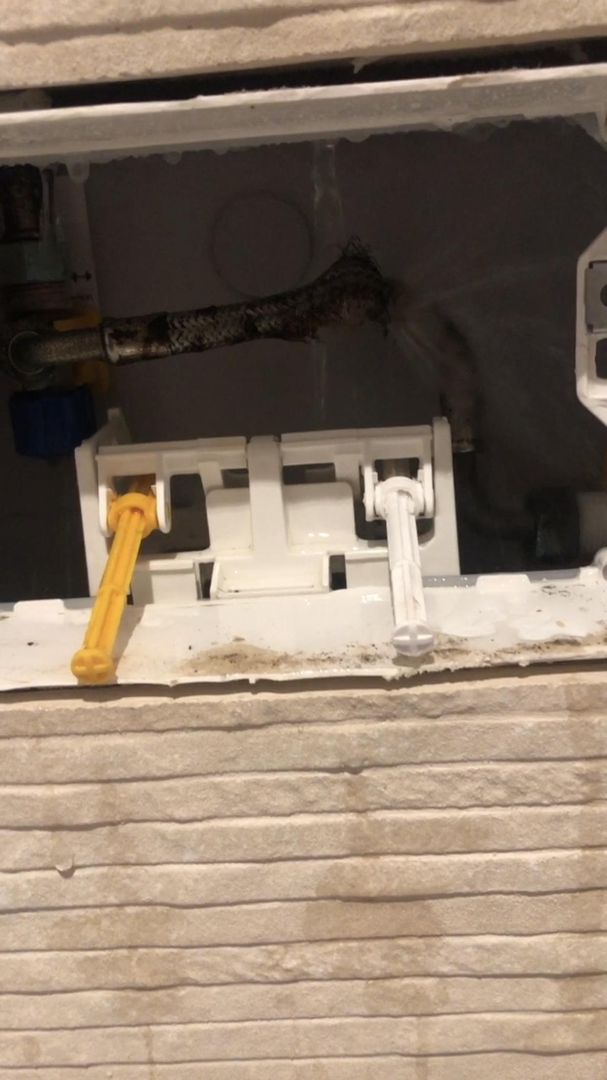

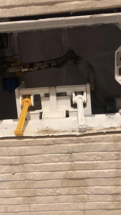

AliG Posted March 27, 2022 Posted March 27, 2022 This morning I thought I could hear water running somewhere but didn’t investigate. Just went into the pool room to change the timer on the filters and found this- Should I get the original pipe? It is a Noken Smart Line cistern and I probably could get one in a week. Or could I just use any braided pipe that fits? Always been suspicious of these concealed cisterns built into the wall but this seems an easy enough fix. IMG_0280.MOV

AliG Posted March 27, 2022 Author Posted March 27, 2022 I think I have found someone who sells the correct part, although it has a different part number. Seems a bit odd that the pipe would blow, do you think the plumber damaged it installing it?
Nickfromwales Posted March 27, 2022 Posted March 27, 2022 Christ, that's hard to track a part for. Porcelanosa should be able to get a direct replacement though. That's cranked both ends so you will likely need the right part. One of the reasons I stick to fitting Geberit and nothing else.
PeterW Posted March 27, 2022 Posted March 27, 2022 Needs to be the one for the cistern as they have a flanged end and a weird fitting from memory if it’s the same as the Porcenelosa one (which is a rebrand)

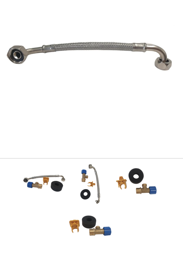

PeterW Posted March 27, 2022 Posted March 27, 2022 Here you go https://www.bathroomspareparts.co.uk/porcelanosa-flexi-hose-100041333-189125-p.asp 1
Nickfromwales Posted March 27, 2022 Posted March 27, 2022 Just now, PeterW said: Here you go https://www.bathroomspareparts.co.uk/porcelanosa-flexi-hose-100041333-189125-p.asp 3 minutes ago, Nickfromwales said: Christ, that's hard to track a part for. God, I hate you some times Peter........ 1 1

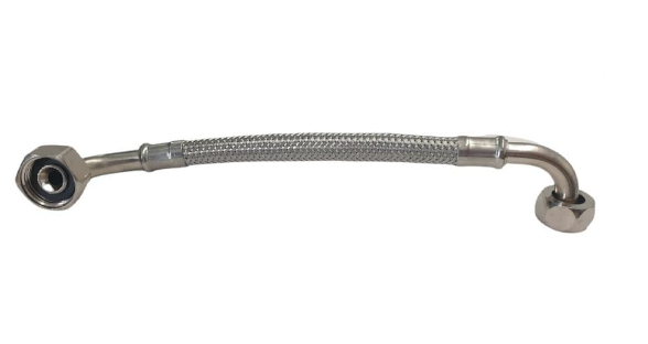

AliG Posted March 27, 2022 Author Posted March 27, 2022 This looks like the right part, but it has a different part number from the installation instructions. https://www.bathroomspareparts.co.uk/porcelanosa-flexi-kit-100306654-189163-p.asp
AliG Posted March 27, 2022 Author Posted March 27, 2022 Haha, yeah that was the one I found, looks like that is it even if the part number is different
Nickfromwales Posted March 27, 2022 Posted March 27, 2022 5 minutes ago, Nickfromwales said: That's cranked both ends so you will likely need the right part In your face @PeterW
Nickfromwales Posted March 27, 2022 Posted March 27, 2022 4 minutes ago, AliG said: Haha, yeah that was the one I found, looks like that is it even if the part number is different TBH, because it's not a Geberit, you may be better off using a far more reliable item, perhaps one of THESE. Better be safe than sorry 1

Nickfromwales Posted March 27, 2022 Posted March 27, 2022 1 minute ago, AliG said: We're not sort of other working toilets thankfully! Yes, very claustrophobic at yours......... Get the correct part, you may just find it was twisted during fitting which would have been the beginning of the end for that flexi.
AliG Posted January 27, 2023 Author Posted January 27, 2023 Another one of these pipes burst today. At 430am I thought I could hear my daughter taking a shower, then I realised after about 20 minutes that didn't make any sense. I got up and the en suite was busy flooding. Figured out another one of these had gone, but this time instead of spraying into the cistern it was spraying against the flush plate and coming out. Got soaked with my finger in the hole while I switched it off. Then went downstairs to find enough water had got out around the flush plate into the wall that it had started to drip down through the kitchen ceiling, so now that will need fixed. Luckily just a small area. It was around the edge of the cooker hood, so I will wait a bit to allow that to dry out before trying it. Hopefully the water will dry out inside the bulkhead as there is no way to get in there easily. Further investigation suggests that flexi pipes may only be good for 5-10 years which scares me as we have quite a lot of them connecting things up. I am going to buy a load of these ones that go in the cisterns and replace any that look dodgy. I checked two out, one looked like new, the other was covered in rust spots. Not sure what the difference between them was as they were in almost identical bathrooms.
