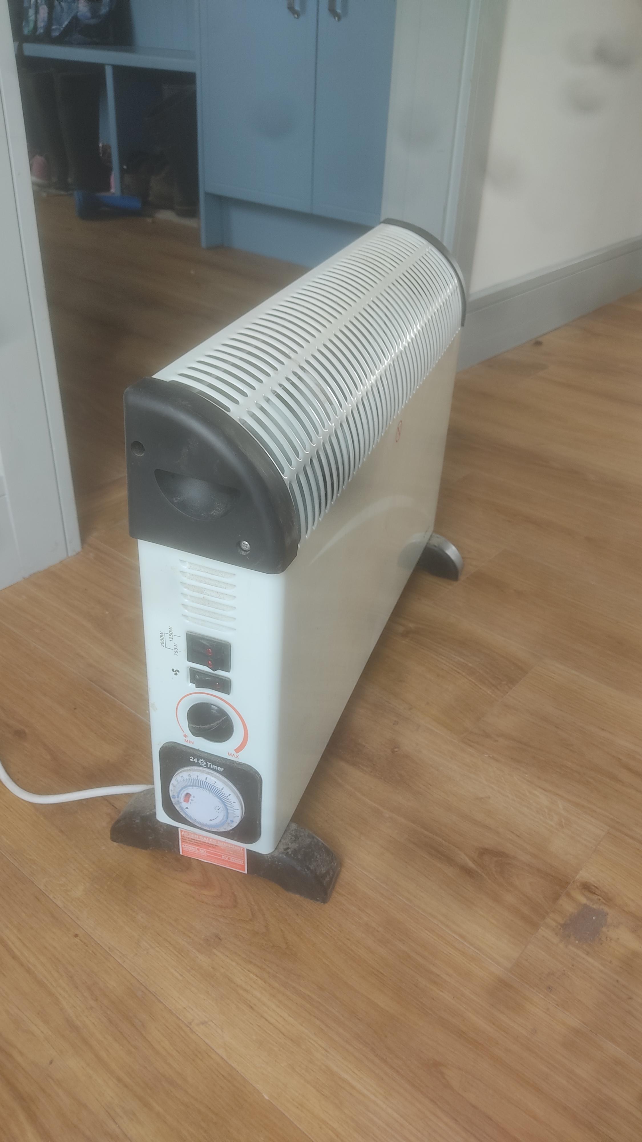

That is why I suggest that you invest in a second rad, and as Nick suggests more child-safe digital timers.  (Masking tape over controls to denote "do not touch" and whatever your favourite admonishment techniques should be effective with tinies.)  A good location for the rad is a hallway, and leave some adjacent doors open.  The MVHR can help circulate the heat throughout the house as well.
I suspect it'll be next winters task at this stage.  I'll probably screw it to the wall of the utility out of harms way, maybe with a digital electricity meter in the fuse box too. A part of the experiment was to see where the best spot was for a single heat source. As you say it doesn't make much of a difference so long as you don't choose too small a room and close the door.
I use a Sonoff Power-usage plug that I can control with my Home Automation system, but you can also get Android timer apps and they are also programmable with Google Home if you are happy letting Uncle Google control your devices.
Living quite too much of my life in hotels with unusably complex automation systems I was determined to have as little as possible in the house. A light switch by the door of every room and a couple of mechanism timers.  ( I lie, we have a robot vacuum too)
In good news I went to the dump today and found this fine article someone had disposed of. Not too often you find a fully working entire "central heating" system for free!!!
Gotta love low energy demand houses😁
