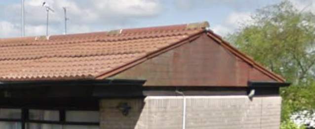

Ferdinand Posted May 8, 2017 Share Posted May 8, 2017 (edited) As an example of what you can do with GRP, this is an example of an experimental GRP pantile-like roof made from approx 8x4 workshop made GRP panels. They built a section of roof in the factory. This is an example of one of my father's (architect turned GRP specials manufacturer) projects. This is a 2009 (ish) photo of a roof installed in the early 1980s. As you can see the individual panels work well, but the connections - while being acceptable in practice (it was a pitched roof on a previous flat roof so there was a waterproof layer underneath) - are not good enough aesthetically after the time. To work long term it would require better waterproofing and better attachment to a structure. The issue is resilience of the shape under environmental influences. The individual panels are ideal for eg porch canopies, cost considerations aside - would be a good solution where you need a lightweight roof section which would be suitable for a conservation area or similar, if you can get the Conservation Officer out of the coma they may enter when you suggest GRP. This bungalow was completely renovated in about 2011 with the roof off, with the roof being taken to traditional pantiles. I wrote a blog about that here back in 2014. I would be interested in @SteamyTea thoughts, but if no one ever tried this kind of thing, we would lose some of our innovative new ideas. Edited May 8, 2017 by Ferdinand 1 Link to comment Share on other sites More sharing options...
