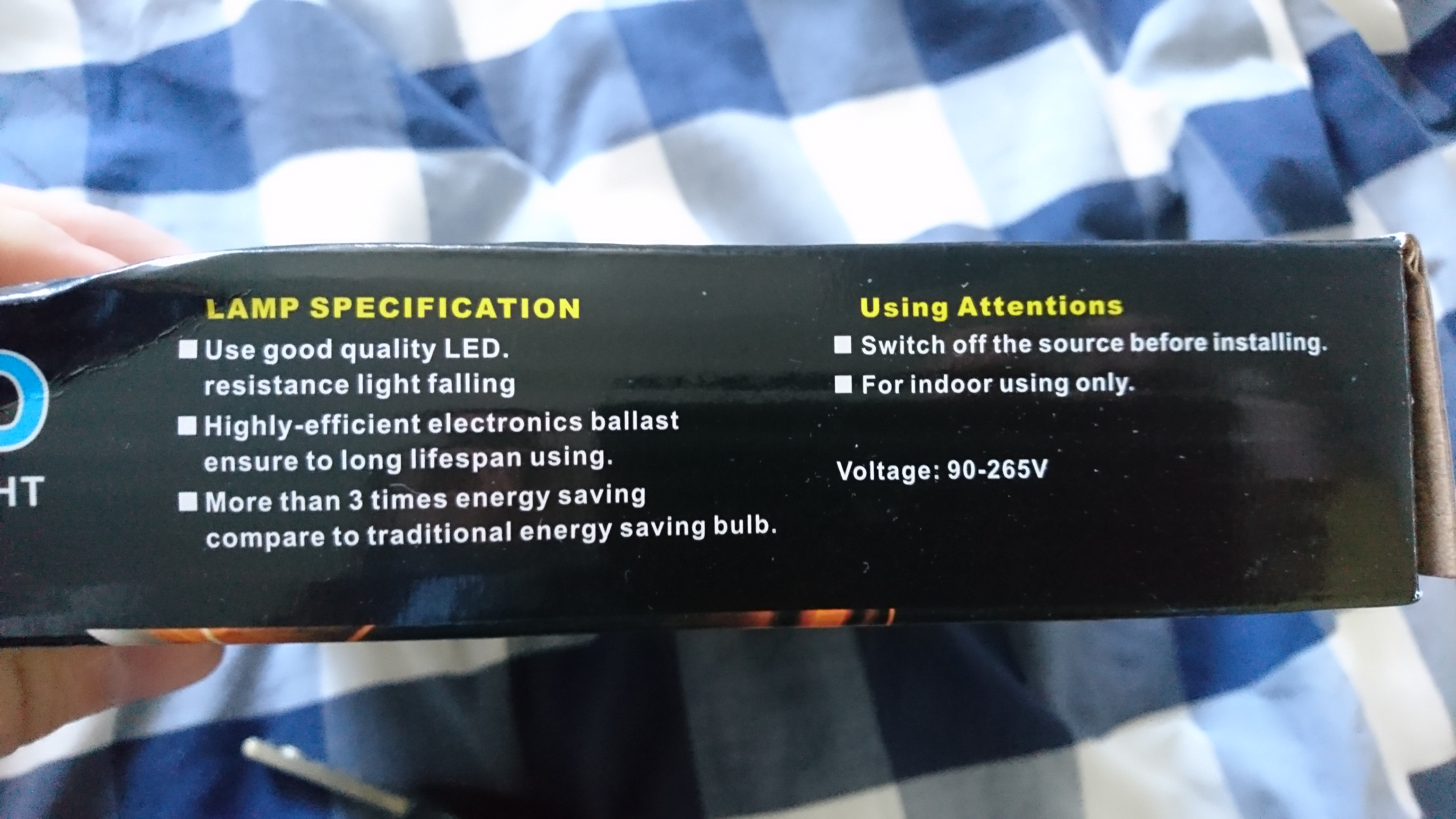

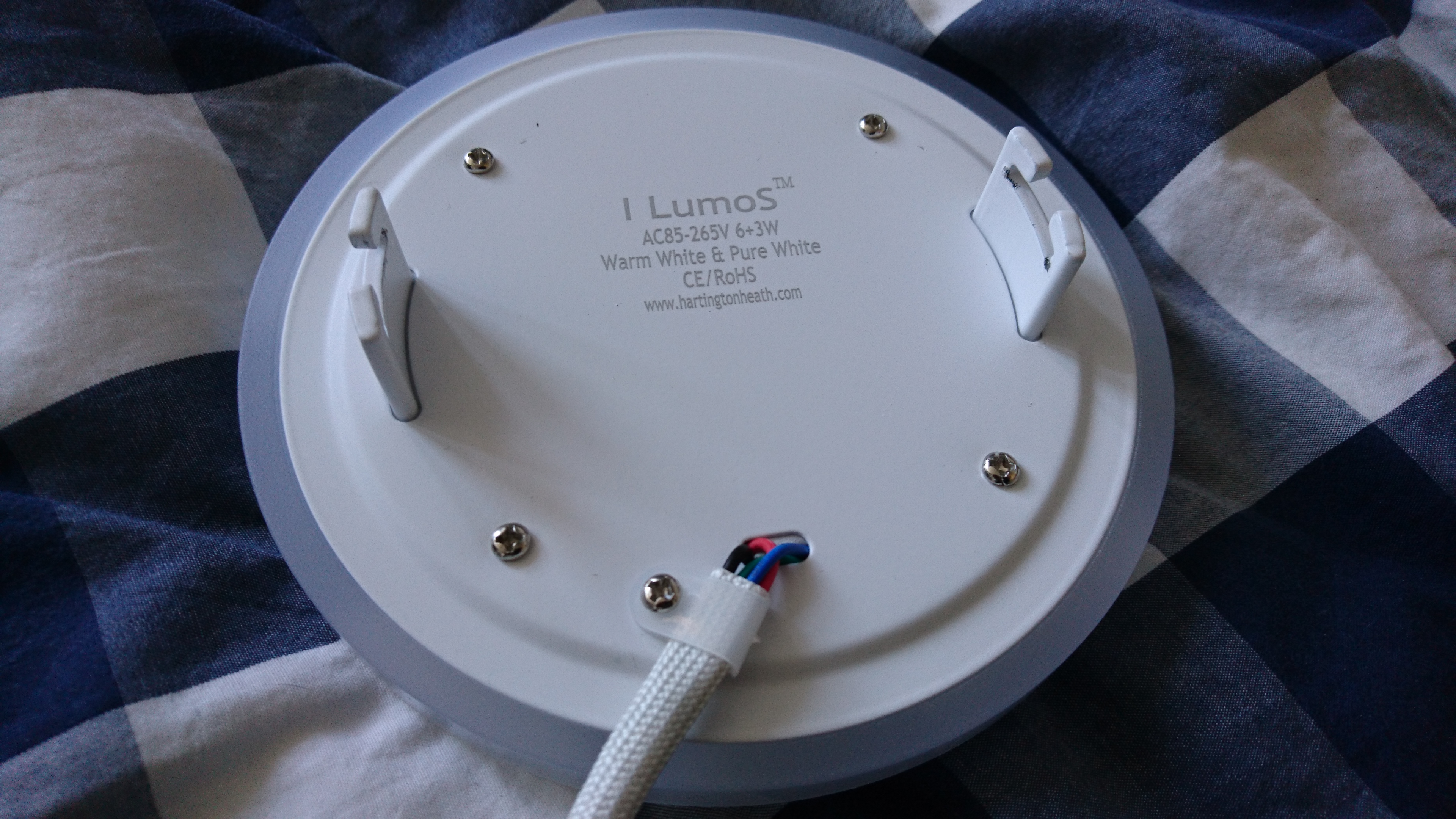

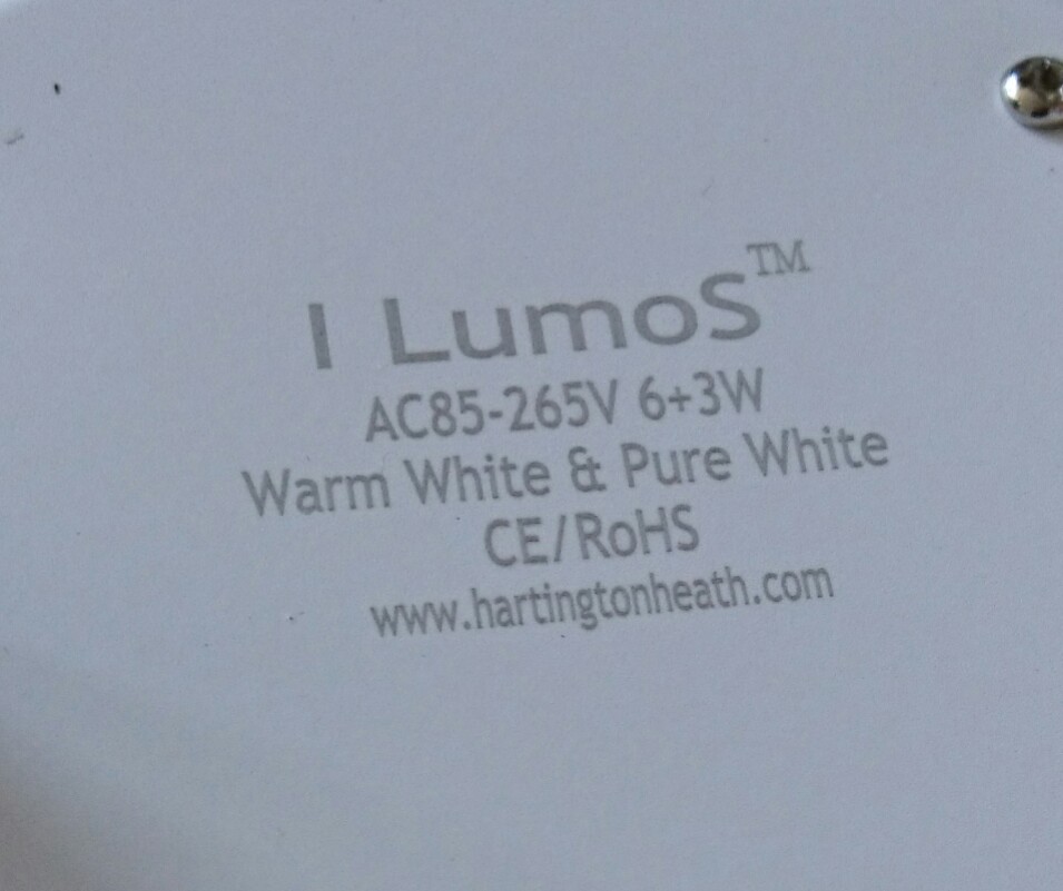

jamiehamy Posted May 7, 2017 Share Posted May 7, 2017 Hi all, I'm still looking at light switches, sockets etc. I've got a quote from Mk for glass effect hardware, all matching that is eye watering. I've also ordered various other similar products to try, a nameless one, Retro touch and Ilumos from Hartington Heath. The iLumos range is really nice, the switches and funky Led downlighters feel like good quality.. Except. For all, the packaging gives the game away that these are made in China. One states this on the box in fairness. But the spelling on the boxes and instructions is appalling, and the packaging is as l ways very generic and not brand specific in some cases which leads me to question whether the CE or Rohs stamp is valid. Is there an easy way to validate this? They are all being sold as compliant but the crappy packaging makes me wonder. Thanks, Jamie Link to comment Share on other sites More sharing options...

jamiehamy Posted May 8, 2017 Author Share Posted May 8, 2017 Pic of downlight... Link to comment Share on other sites More sharing options...
jamiehamy Posted May 8, 2017 Author Share Posted May 8, 2017 Pic of box! Decision made - MK. Link to comment Share on other sites More sharing options...

Onoff Posted May 8, 2017 Share Posted May 8, 2017 Chinese Equipment. Chinglish instructions! Link to comment Share on other sites More sharing options...
jamiehamy Posted May 8, 2017 Author Share Posted May 8, 2017 My friend says the Chinese claim it stands for Chinese Export. How wholesalers interpret it is their lookout! Link to comment Share on other sites More sharing options...
Onoff Posted May 8, 2017 Share Posted May 8, 2017 48 minutes ago, jamiehamy said: Pic of box! Decision made - MK. So sad isn't it. The kit might in fact be fine but when the discerning buyer sees that inattention to detail you can't help but worry it's carrried through to the actual kit. Link to comment Share on other sites More sharing options...
Onoff Posted May 8, 2017 Share Posted May 8, 2017 3 minutes ago, jamiehamy said: My friend says the Chinese claim it stands for Chinese Export. How wholesalers interpret it is their lookout! Hence my highlighting the C & E! Link to comment Share on other sites More sharing options...

Jeremy Harris Posted May 8, 2017 Share Posted May 8, 2017 (edited) Often the Chinese stuff, as in the pic in the example here: doesn't even pretend to use the correct CE mark, in that pic they've just used the letters CE in a normal typeface, so the item has never been properly designed, tested or approved. Edited May 8, 2017 by JSHarris 1 Link to comment Share on other sites More sharing options...
jamiehamy Posted May 8, 2017 Author Share Posted May 8, 2017 4 minutes ago, Temp said: Anyone would think the similarity was deliberate. Goodness knows what mine is! I'll check the others when I get home. Link to comment Share on other sites More sharing options...
Temp Posted May 8, 2017 Share Posted May 8, 2017 As I recall the use of the correct CE mark is itself a requirement of CE marking. So if the mark is incorrect it doesn't comply for that reason alone. Seems the China Export mark is bogus.. https://en.wikipedia.org/wiki/CE_marking China Export[edit] A logo very similar to CE marking has been alleged to stand for China Export because some Chinese manufacturers apply it to their products.[17] However, the European Commission says that this is a misconception. The matter was raised at the European Parliament in 2008.[18] The Commission responded that it was unaware of the existence of any "Chinese Export" mark and that, in its view, the incorrect application of the CE marking on products was unrelated to incorrect depictions of the symbol, although both practices took place. It had initiated the procedure to register CE marking as a Community collective trademark, and was in discussion with Chinese authorities to ensure compliance with European legislation.[19] Link to comment Share on other sites More sharing options...
