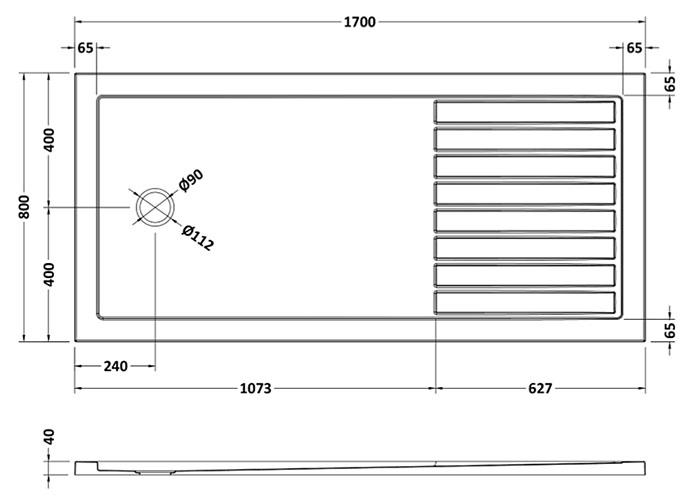

Chris HB Posted March 17, 2022 Author Posted March 17, 2022 Not this one, but this sort of idea where you get a 1700 x 800mm Walk In Shower Tray With Drying Area - does this drying area aspect count as activity space in terms of the regs? 🤔 https://www.victorianplumbing.co.uk/saturn-walk-in-shower-tray-with-drying-area-1700-x-800mm
AliG Posted March 17, 2022 Posted March 17, 2022 This is partly covered in the regs - An accessible shower room should be of a size that will accommodate either a level-access floor shower with a drained area of not less than 1.0m x 1.0m (or equivalent) or a 900mm x 900mm shower tray (or equivalent). The drained area of a level-access floor shower may overlap with activity or manoeuvring spaces where access to other sanitary facilities is not across the drained area. So the drained area of the shower can be in the activity space. I think I would read this as the activity space could be in the shower as there is room for this plus a 900x900 tray. However, another part of the regs supersedes this - except where reduced by projection of a wash hand basin, unobstructed access at least 800mm wide to each sanitary facility, So you could have what you show, but only if the entrance to the shower has to be at least 800mm wide. I don't think you can have an accessible shower with a 627mm wide entrance. It is also worth noting, in case this is the plan, that an accessible shower cannot be an en suite. 1

Chris HB Posted April 6, 2022 Author Posted April 6, 2022 6 hours ago, AliG said: Not sure on the activity space on a quadrant shower. However I don’t think they qualify as accessible if that is also required as the entry is too narrow. accessibility is not essential in this case, but nice to have I’m exploring all options to see if I can get a WC, basin and shower into what is proving to be a very tight potential space for a small bathroom!
