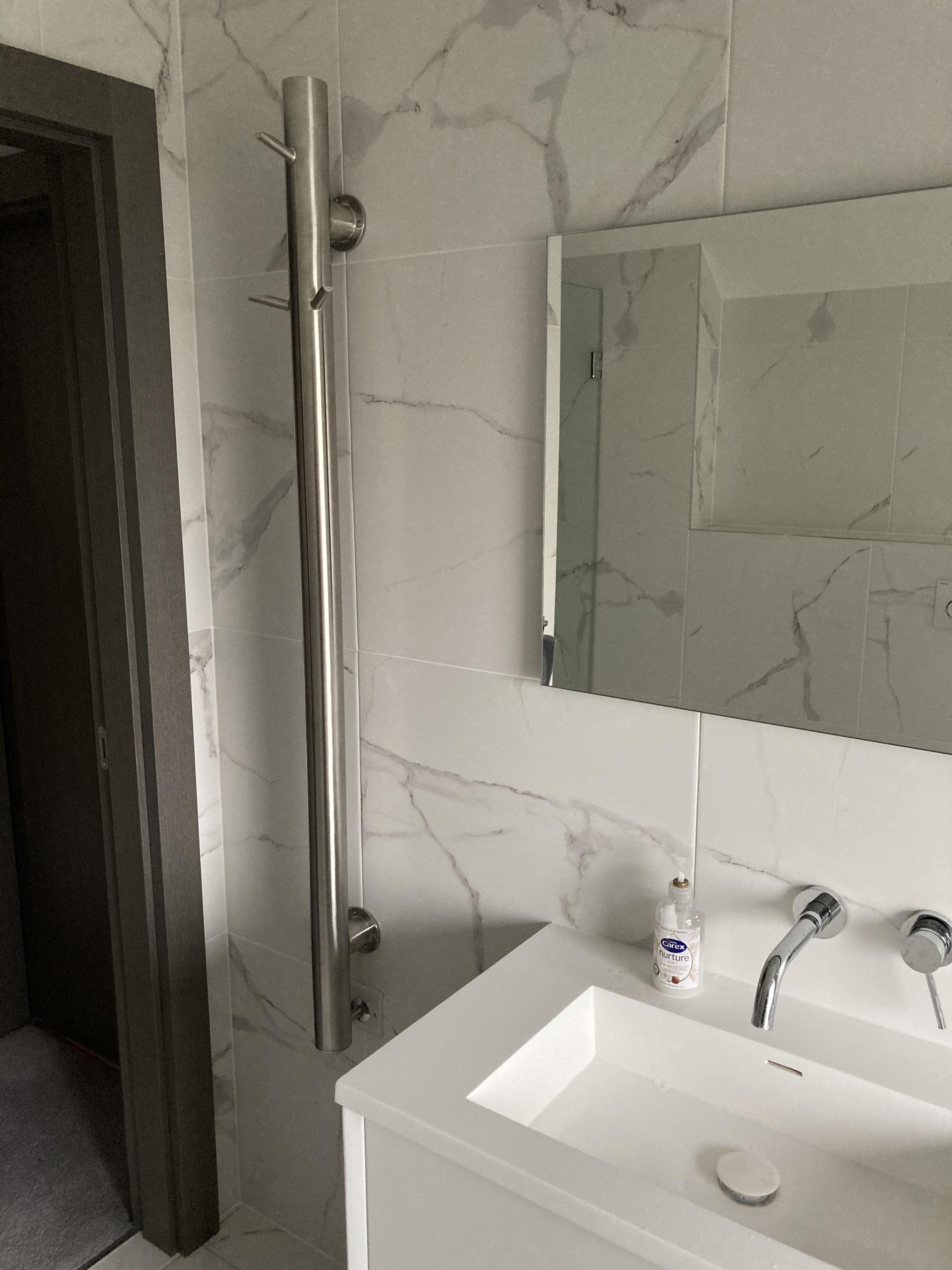

@Tadpolewe have a similar set up to you. We went with electric UFH for both bathrooms with their own controllers and used independently timed ‘towel trees’ as space was limited. Bath sheets dry quickly.

@Russdl especially that towel tree.
