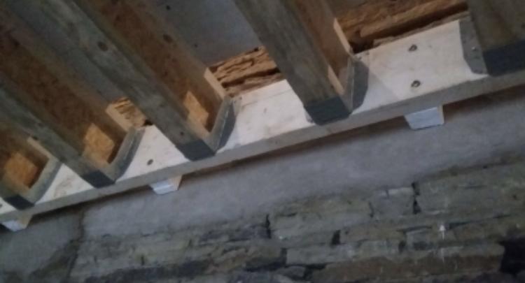

Rishard Posted March 3, 2022 Share Posted March 3, 2022 I’ve often fitted ledger boards using resin anchors to the masonry. You can set them in to a lazer for perfect flatness. I then flush up joist tops with the ledger then attach the hangers. Even I joists seem to have some variation in height. Good practice to Parge the wall behind the ledger for airtightness. I’ve not done this part before but I’ve not been air testing my projects. New to passive but fitted plenty of joists/floors. You’ll need restraint straps for structural approval. These often used to be notched in joist tops and sailed into the cavity to be built in with the block. This method is obviously no good for thermal bridging : air tightness or your joist height not matching your block courses but the could be mechanically fix to the inner skin. 400mm spacing is better, 22mm flooring, glue and screw it down and it’ll never squeak, or come up again. I’ve done some at 300mm centres on shallow joists to be sure they won’t flex. Get plenty of noggins in and you’ll have a good stiff structural floor. 1 Link to comment Share on other sites More sharing options...

ruggers Posted March 3, 2022 Author Share Posted March 3, 2022 30 minutes ago, Rishard said: I’ve often fitted ledger boards using resin anchors to the masonry. You can set them in to a lazer for perfect flatness. I then flush up joist tops with the ledger then attach the hangers. Even I joists seem to have some variation in height. Good practice to Parge the wall behind the ledger for airtightness. I’ve not done this part before but I’ve not been air testing my projects. New to passive but fitted plenty of joists/floors. You’ll need restraint straps for structural approval. These often used to be notched in joist tops and sailed into the cavity to be built in with the block. This method is obviously no good for thermal bridging : air tightness or your joist height not matching your block courses but the could be mechanically fix to the inner skin. 400mm spacing is better, 22mm flooring, glue and screw it down and it’ll never squeak, or come up again. I’ve done some at 300mm centres on shallow joists to be sure they won’t flex. Get plenty of noggins in and you’ll have a good stiff structural floor. Some good info. there Rishard. I've used a ledger board on one side before and the other end build into the inner leaf but it was over a decade ago using solid joists and I'd never heard of airtightness back then. What are the restraint straps you refer to, are they part of the hanger or an additional brace? How have you seen services like cables and pipes pass the ledger board between ground floor and first floor? I've noticed they do a green glue 3mm joist tape now that you can apply to each joist top and screw down through the 22mm board into the joist. It's supposed to offer some acoustic seal and prevent squeaks the same as glue. Looks good but not seen any reviews yet. Link to comment Share on other sites More sharing options...
Rishard Posted March 4, 2022 Share Posted March 4, 2022 Restraint straps are much the same as wall plate straps. 5mm thick steel straps usually with 100mm bend and come in a variety of lengths. These are often part of your floor plan spec. They sit 1/3rd the span of the joist perpendicular to the span. They need solid noggins between the joists to fix the straps to. I cut these in to the joist top and set noggins low so the strap doesn’t foul the flooring. In the past I’ve stood the ledger off the wall at the fixing points with timber to create a void for services to run. I’ve seen it done with compactfoam as an alternative to timber too. Before installing the joists I lay them all out side by side vertically supported at their end points and shuffle them around to get the tops in size order. Even PAR timber can vary by 6mm. Crown the timbers up at this point too. 1 Link to comment Share on other sites More sharing options...

Rishard Posted March 7, 2022 Share Posted March 7, 2022 I use m16 threaded bar resin anchored into the blockwork every other joist spacing. A small chase out of the blockwork would work but as you need to Parge the wall you would need to have your pipes in place. I’m sure I read somewhere about people using airtightness paint in their chases before running cables ect. 1 Link to comment Share on other sites More sharing options...

ruggers Posted March 7, 2022 Author Share Posted March 7, 2022 Thanks for the photo, appreciated. It certainly helps with that gap behind to run services as that was the only draw back I could think of. I need to discuss the 3 options with my architect, I've been back & forth between wall bearing using tony tray, masonry hangers or ledger board. The joiner I'll be working with & the Architect are most familiar with wall bearing joists but not so familiar with airtightness to a high level. The three options seem to be similar in cost. TT requires the membrane which I need to check which type is used & further info on installing end & corner detail. Ledger board requires cheaper hangers and resin fixings and masonry hangers are a little bit more expensive but probably the easiest install method. There doesn't seem to be a lot Link to comment Share on other sites More sharing options...
