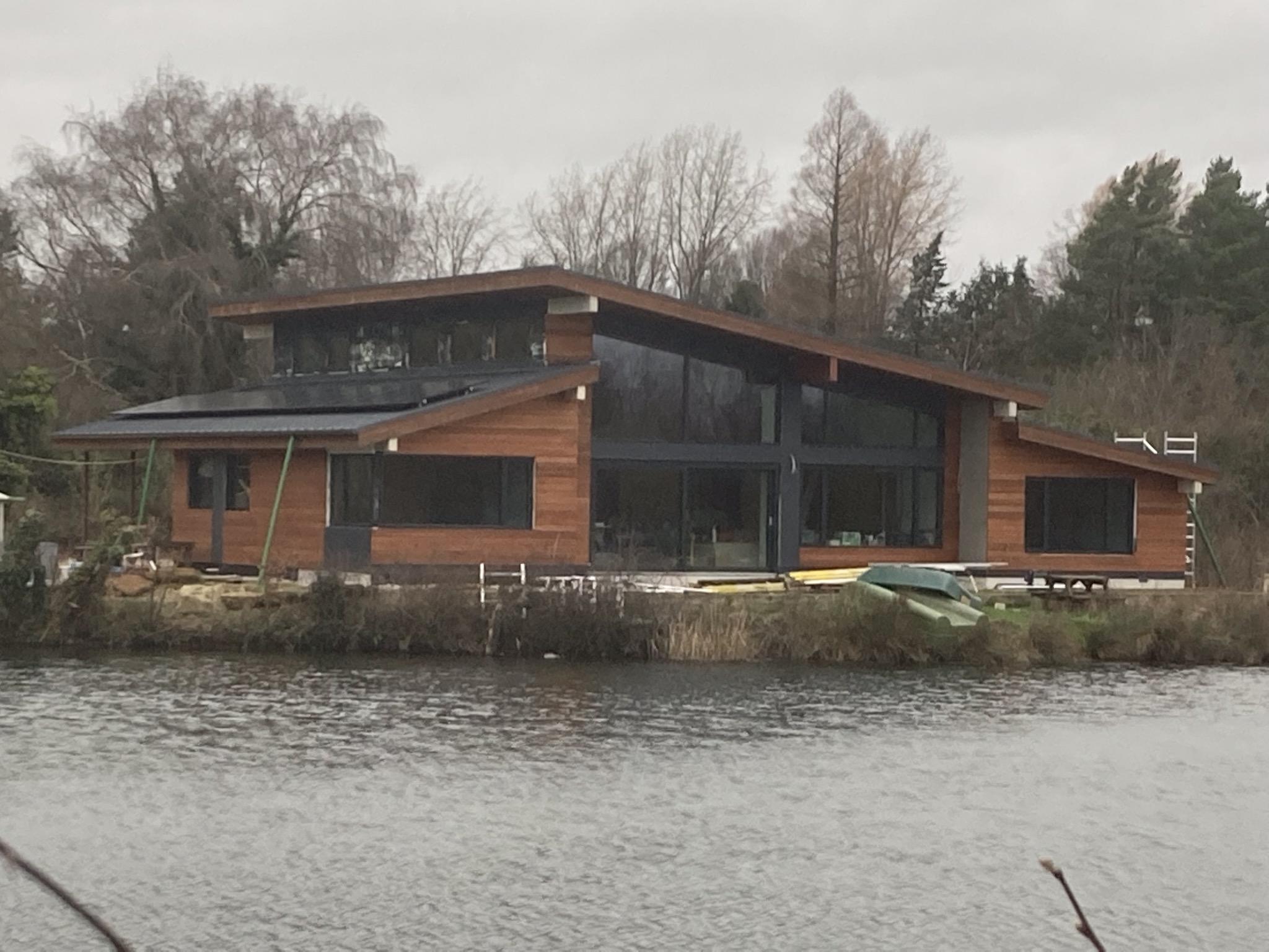

Russell griffiths Posted February 28, 2022 Posted February 28, 2022 Pick something cheaper than the cedar, I’ve just fitted mine and I cannot for the life of me work out why I didn’t have larch and save £4-5 grand, it looks ok now but in a few years time I think it could look like any old timber.
Thorfun Posted February 28, 2022 Author Posted February 28, 2022 4 minutes ago, Russell griffiths said: Pick something cheaper than the cedar, I’ve just fitted mine and I cannot for the life of me work out why I didn’t have larch and save £4-5 grand, it looks ok now but in a few years time I think it could look like any old timber. looks fabulous now though! and I know it'll silver like any other timber but there are much fewer knots in WRC so should look better as it ages, at least that's how I'm justifying it to myself. what widths are those boards?

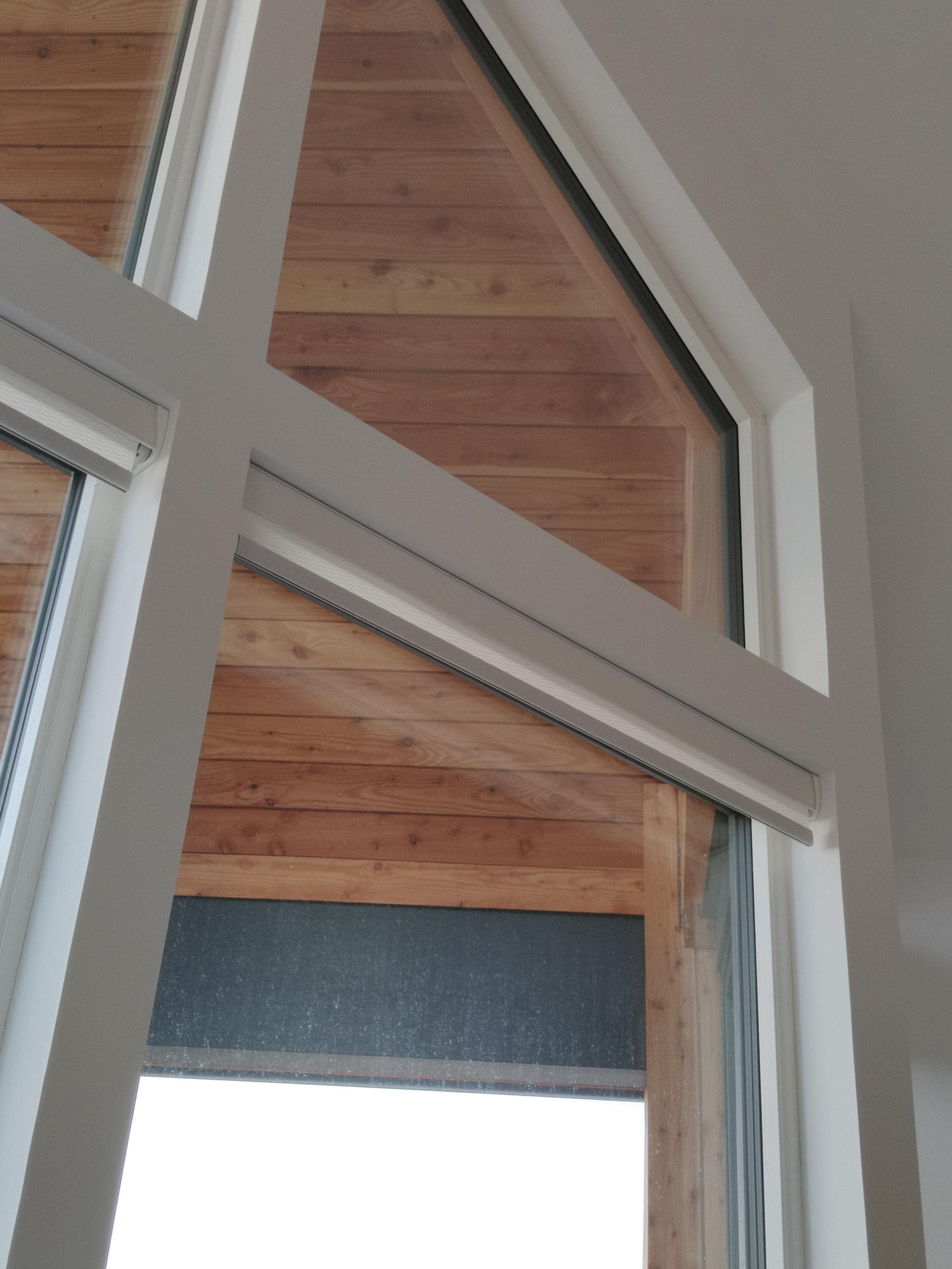

JohnMo Posted February 28, 2022 Posted February 28, 2022 You may be over thinking it, I doubt you will really notice the difference in width once finished. Wester red cedar? Scottish Larch on ours - will be treating with cedar oil. 1
Thorfun Posted February 28, 2022 Author Posted February 28, 2022 24 minutes ago, JohnMo said: You may be over thinking it, I doubt you will really notice the difference in width once finished. Wester red cedar? Scottish Larch on ours - will be treating with cedar oil. yeah, I've seen your cladding before. looks very nice but your picture shows it at sunset/sunrise so the larch has a reddish tint to it that isn't there normally. ?
ToughButterCup Posted February 28, 2022 Posted February 28, 2022 @Russell griffiths, that looks fantastic : and perfect for you because I hear you are into wild swimming. I can just imagine it ; skinny dipping at dawn and (this time of year) wild ospreys sitting on your roof waiting their chance for a .... 1

JohnMo Posted February 28, 2022 Posted February 28, 2022 1 hour ago, Thorfun said: yeah, I've seen your cladding before. looks very nice but your picture shows it at sunset/sunrise so the larch has a reddish tint to it that isn't there normally. ? Photo taken just now, no sun, as just about to disappear, it is always red. 1
