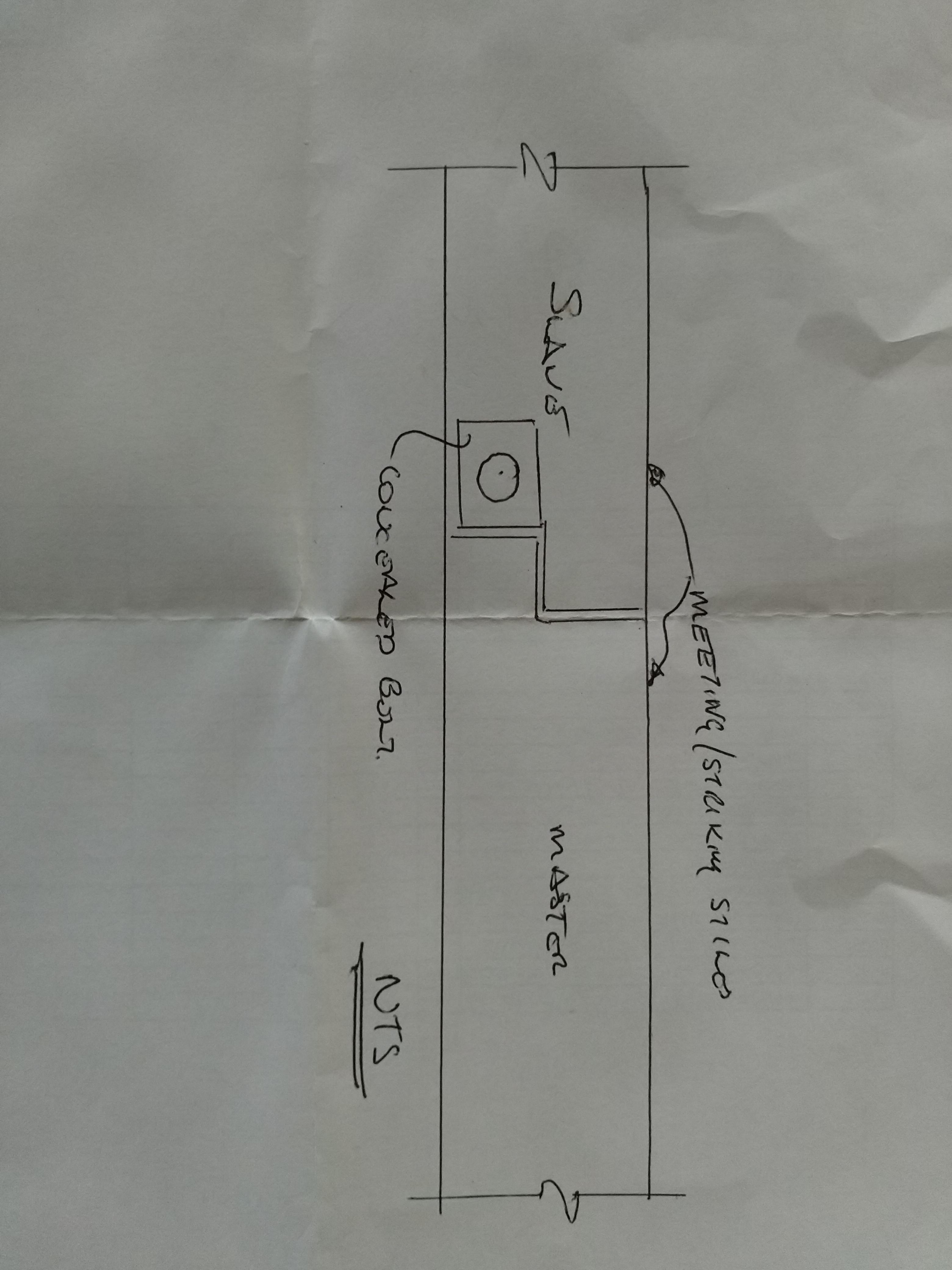

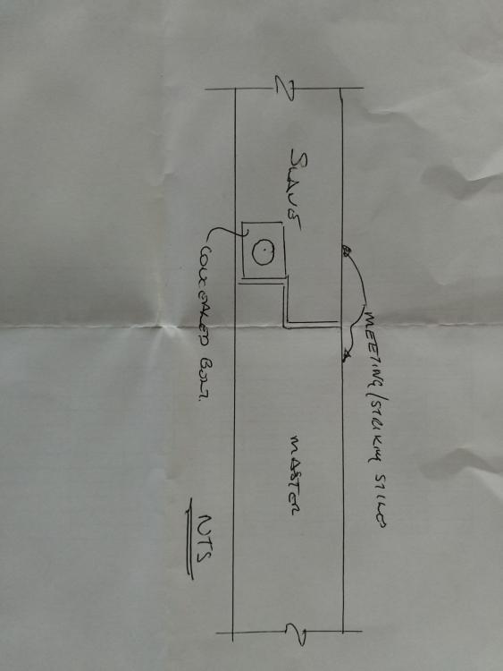

Simplysimon Posted July 3, 2022 Posted July 3, 2022 rebate both striking stiles, will make them slightly narrower. fit 2x concealed door bolts to the slave, intumescent strip to rebate on the master. when you have sign off, do the same to the oak doors and replace the FD30s.
Adsibob Posted July 3, 2022 Author Posted July 3, 2022 3 minutes ago, Simplysimon said: rebate both striking stiles, will make them slightly narrower. fit 2x concealed door bolts to the slave, intumescent strip to rebate on the master. when you have sign off, do the same to the oak doors and replace the FD30s. Not sure I follow this. Can you draw a sketch please?
Simplysimon Posted July 3, 2022 Posted July 3, 2022 (edited) If OCD kicks in someone can rotate it 90 deg! one of these for door bolt Edited July 3, 2022 by Simplysimon adding link
