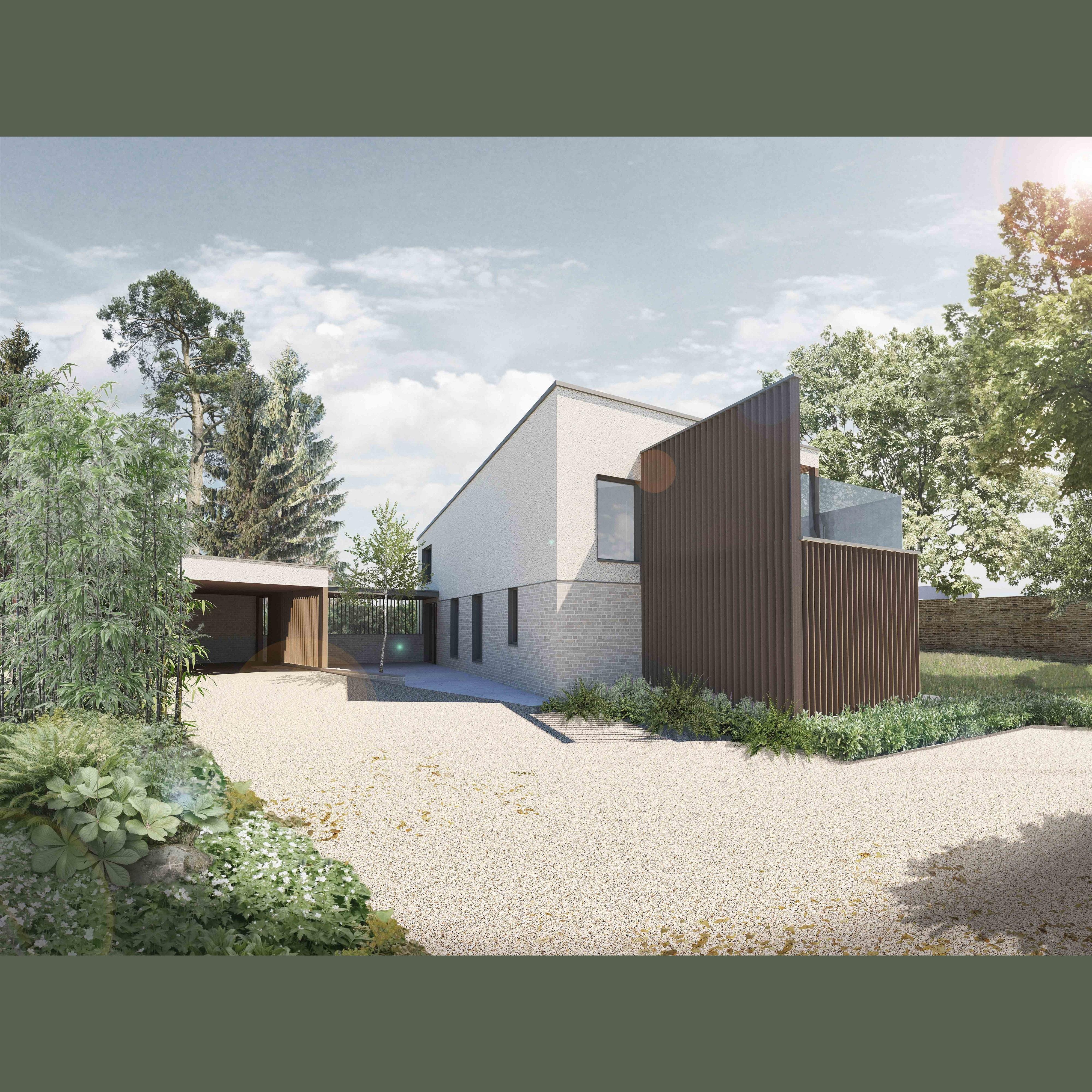

Mulberry View Posted February 25, 2022 Posted February 25, 2022 We've just had our initial Tech Drawing package from our Architect. Our understanding is that this should enable us to engage primary suppliers and provide a window of opportunity to tweak elements of the design according to specific systems before the final Technical package is supplied and a full Building Regs application is put forward. So, with this in mind, what should we be considering at this stage? We're engaging with ICF Suppliers (though Nudura are very likely), Window/Door companies, Metal Roofing. We're also expecting output from our Structural Engineer soon, so I guess we can make progress with Pozi Joists, Foundation design, Concrete requirements etc. Anything else we should be thinking about at this stage? Very keen to move forward in earnest in the Spring, but time is slipping away. As keen as I am to get cracking with the physical stuff, I feel as though I'm procrastinating a little.
