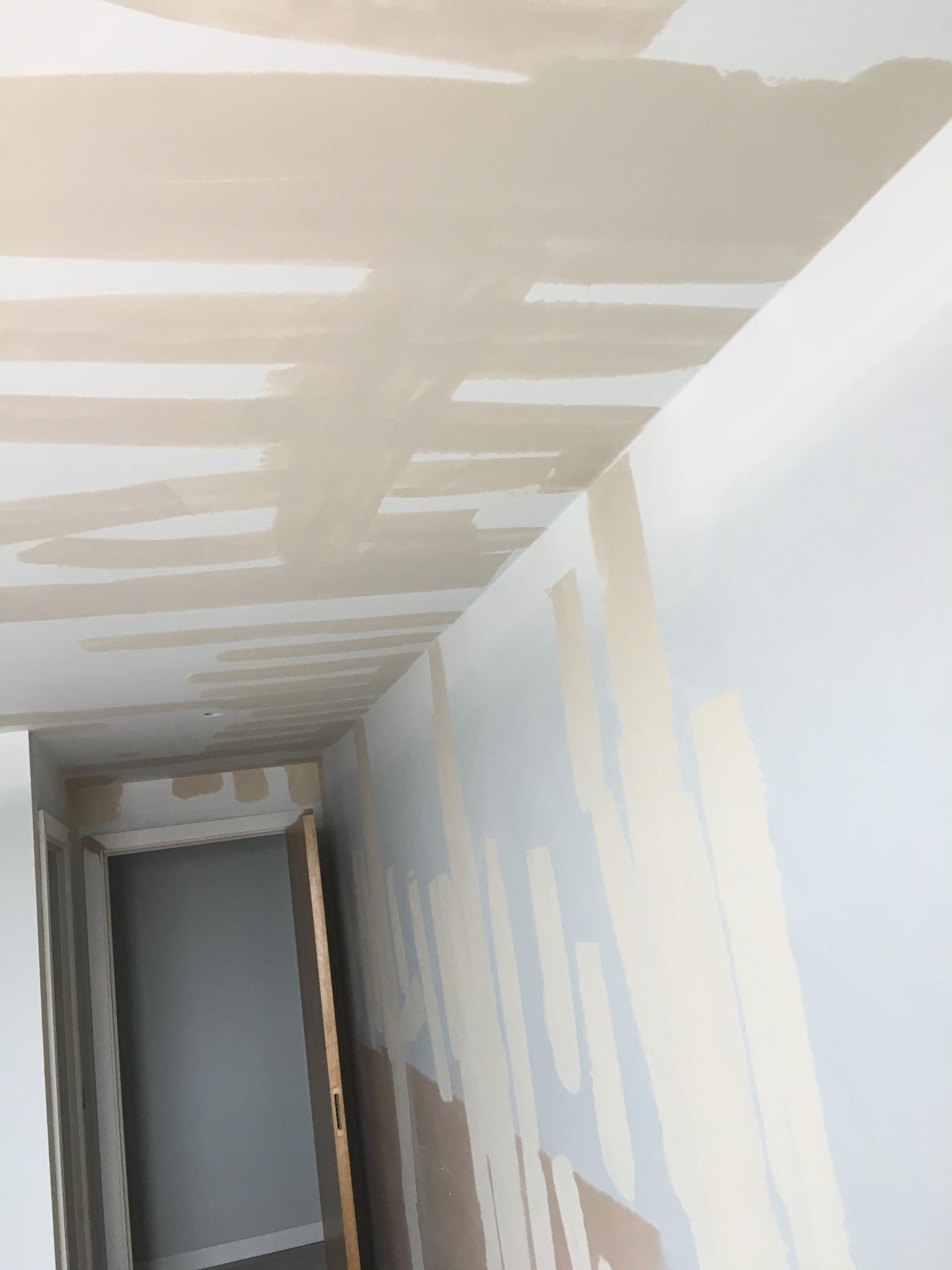

Porthole Posted February 22, 2022 Share Posted February 22, 2022 Hello Our solid walls have Thistle Hardwall and Finishing plaster skim on them. They are however quite bumpy and I would be grateful for any tips on how to smooth these out. Our decorator isn't part of the contractor's team and blames the plastering for poor quality work. In our old house, our builders did the decorating and I do remember them sanding furiously for a day with masks on, after the first coat of white paint. The end result was quite good and the sanding compensated for poor plaster work. I need to suggest that our current painter does this but not sure what type of sanding, grit rating etc to use. Please can you advise. He won't be happy me asking him to do this though. Is this the best approach? Also before bring up the poor plasterwork with the contractor can someone please tell me if it is common to have more uneven plasterwork when hardwall is used as opposed to plasterboard. Thank you!! Link to comment Share on other sites More sharing options...
markc Posted February 22, 2022 Share Posted February 22, 2022 Sounds like you need to get it skimmed by a decent plasterer. you could sand with a big drywall sander but it’s a horrible job even with good dust extraction Link to comment Share on other sites More sharing options...
Onoff Posted February 22, 2022 Share Posted February 22, 2022 (edited) Depends how big an area but the (handraulic ?) Mirka sander with dust extraction attachment is a joy to use: https://www.toolstation.com/mirka-dust-extraction-handy-sander-kit/p86220 Edited February 22, 2022 by Onoff Link to comment Share on other sites More sharing options...
nod Posted February 22, 2022 Share Posted February 22, 2022 They will need a coat of carlite bonding Then re skimmed Anything else will be a waste of time Link to comment Share on other sites More sharing options...

nod Posted February 22, 2022 Share Posted February 22, 2022 (edited) 31 minutes ago, Porthole said: Thank you - the decorator has got this sander but I think he may need something more industrial. I remember previous decorators using a circular type of sander You will do all that Then either live with it or end up Bonding and skimming it all Speaking from experience It’s like the old poly cell add which showed a lady covering artex with a tub of filler then sanding It doesn’t work Filling and sanding will cover infections in skimming But not backing plaster Plus cost a fortune Edited February 22, 2022 by nod Link to comment Share on other sites More sharing options...

Jenki Posted February 23, 2022 Share Posted February 23, 2022 As @nod Said, it will need undercoat plaster to flatten the wall first using a Darby or screed beams (if these are big undulations) then skim. otherwise the skim coat will follow the base and still be bumpy - better but bumpy. 11 minutes ago, Porthole said: What is the rough cost of a plaster - is it £200 a day? I thought you had rough plaster? Link to comment Share on other sites More sharing options...
nod Posted February 23, 2022 Share Posted February 23, 2022 (edited) We where ask to put eight poorly skinned apartments right I did advise replastering But they decided we should fill and sand to save money We finished up re skimming after it had been painted AGAIN This was just bumpy 3-5 mil finish Very difficult to get it looking right with filler Edited February 23, 2022 by nod Link to comment Share on other sites More sharing options...
