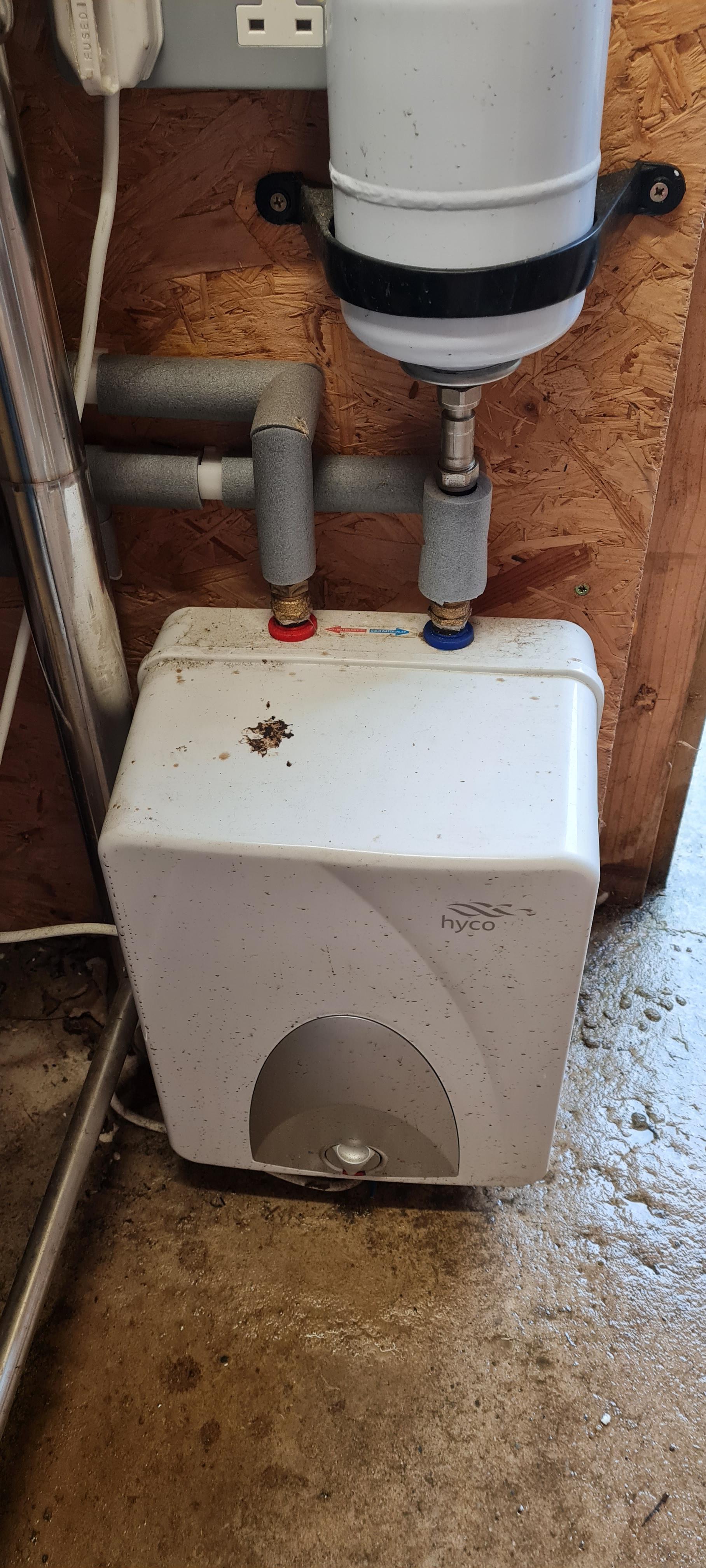

ToughButterCup Posted February 20, 2022 Share Posted February 20, 2022 This is how we have solved the problem, @MrH Exactly the same specification as you have given above..... Link to comment Share on other sites More sharing options...
ProDave Posted February 20, 2022 Share Posted February 20, 2022 That's a storage water heater, not instant. That will do it but will maintain a tank of water all the time which might not be very efficient if only used occasionally. Link to comment Share on other sites More sharing options...
