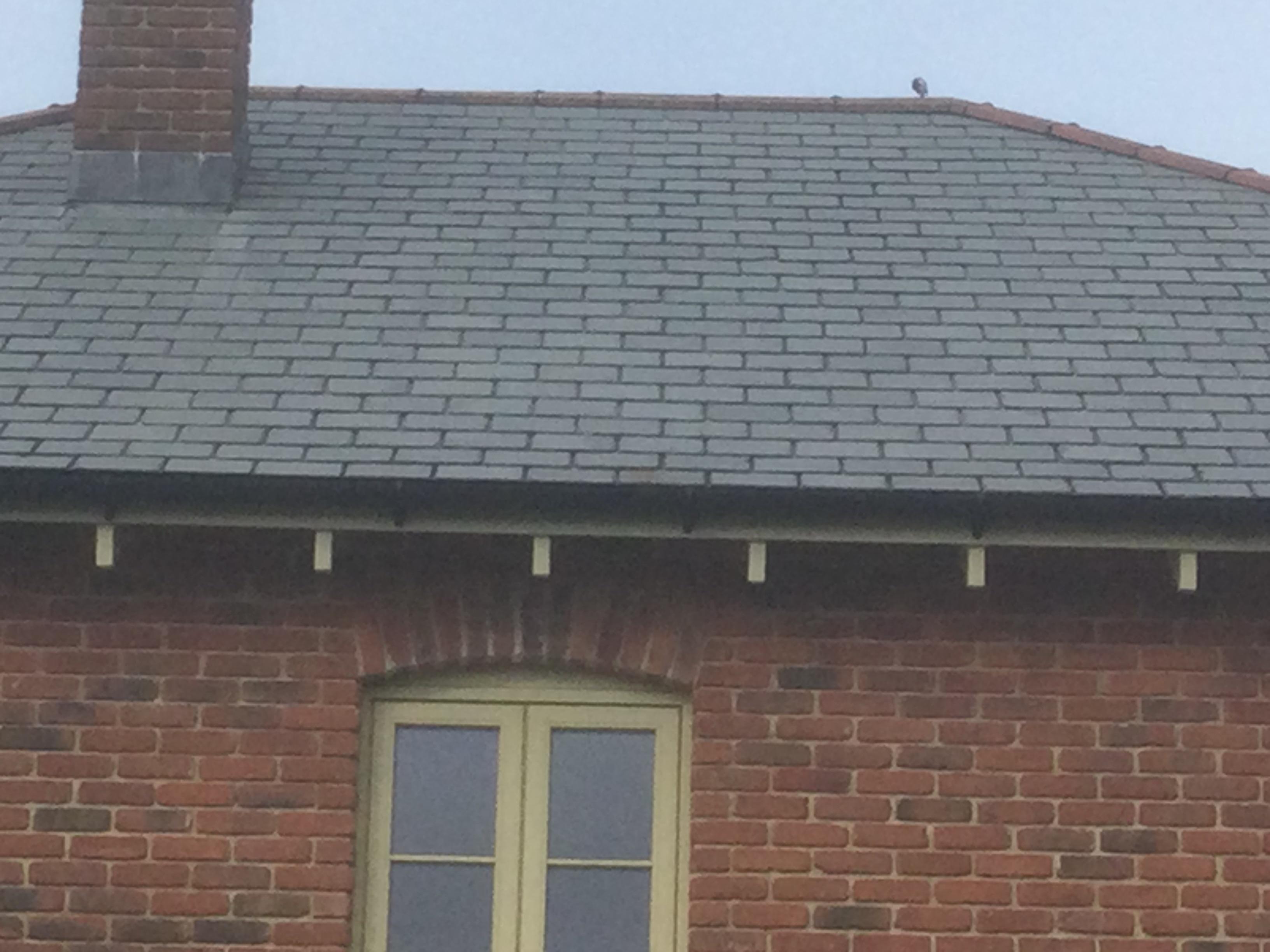

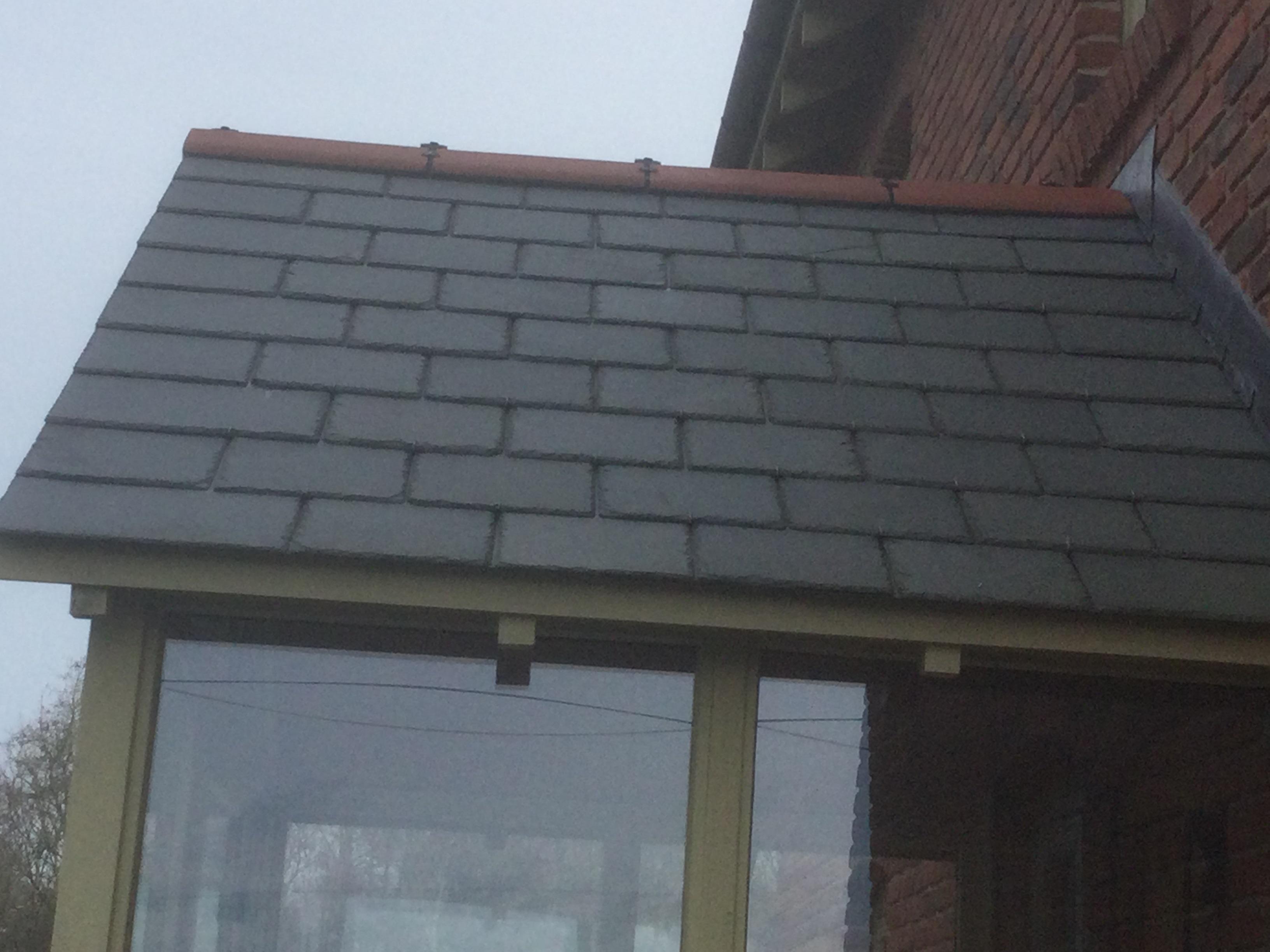

joe90 Posted February 11, 2022 Posted February 11, 2022 (edited) My natural (Spanish ) slates are fixed with hooks and looks great, you have to look really hard to see the hooks and broken slates won’t fall off the roof and can be replaced without awful lead/copper strips. I would always use hooks in future. Edited February 11, 2022 by joe90
nod Posted February 11, 2022 Posted February 11, 2022 18 minutes ago, joe90 said: My natural (Spanish ) slates are fixed with hooks and looks great, you have to look really hard to see the hooks and broken slates won’t fall off the roof and can be replaced without awful lead/copper strips. I would always use hooks in future. 18 minutes ago, joe90 said: My natural (Spanish ) slates are fixed with hooks and looks great, you have to look really hard to see the hooks and broken slates won’t fall off the roof and can be replaced without awful lead/copper strips. I would always use hooks in future. Plus 1 we fixed ours with nails But our next will probably be with hooks due to exposed area I think hooks look fine A quick snap from ground level might help clear this up Joe
joe90 Posted February 11, 2022 Posted February 11, 2022 (edited) Surely , with close up of porch roof. Spot the hooks??? Edited February 11, 2022 by joe90 2
