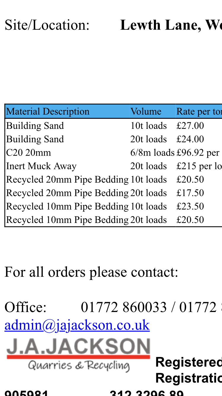

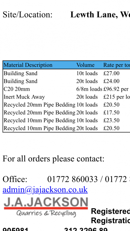

This may help
buy a mixer for under a thousand Sell on for about the same when finished
