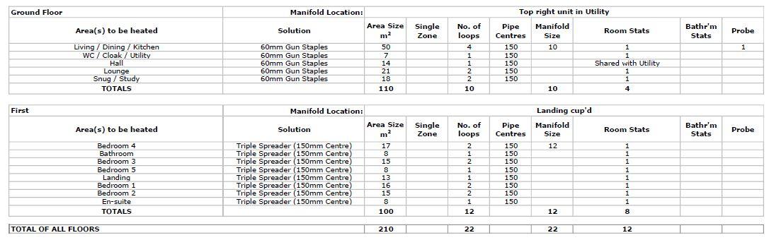

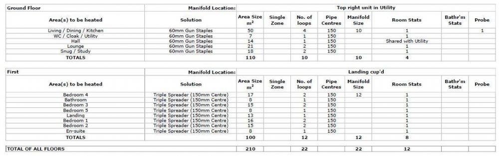

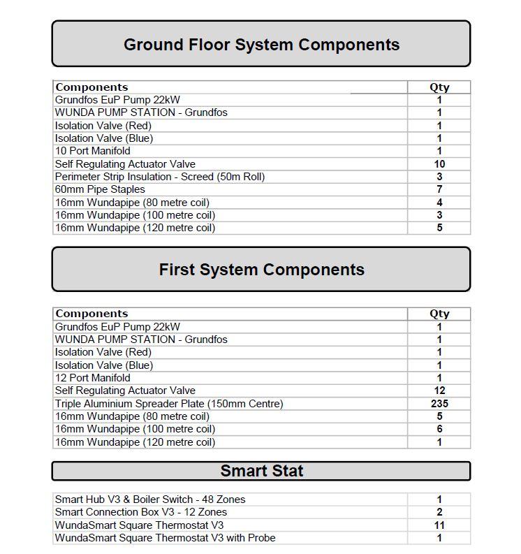

richo106 Posted February 2, 2022 Author Share Posted February 2, 2022 I have just had my quote from Wunda and now asked for a pipe layout etc Do this lists below make sense and look like everything I need is included? Where it says number of loops, what does that actually mean (sorry for the daft question) The guy whos installing my heat pump says I will not need a mixer valve on the manifold as the heat pump controls the flow temp Any body used the wunda wireless control set up before? Are they as easy to set up/install as described? Any opinions/info on what I have provided will be very much appreciated Link to comment Share on other sites More sharing options...
ProDave Posted February 2, 2022 Share Posted February 2, 2022 1 minute ago, richo106 said: The guy whos installing my heat pump says I will not need a mixer valve on the manifold as the heat pump controls the flow temp Yes and no. If you have an ASHP and use it just for UFH he is probably right. If you also heat DHW with the ASHP then no. the ASHP will heat the water to probably 55 degrees for DHW, and when it has done, it will switch back to UFH and the slug of 55 degrees water in the system will promptly enter your UFH. Fit the blending valve, as a precaution. Link to comment Share on other sites More sharing options...
SteamyTea Posted February 2, 2022 Share Posted February 2, 2022 3 minutes ago, richo106 said: Where it says number of loops, what does that actually mean (sorry for the daft question) It is what sets the power output for any given temperature. Link to comment Share on other sites More sharing options...
Nickfromwales Posted February 2, 2022 Share Posted February 2, 2022 13 minutes ago, richo106 said: Where it says number of loops, what does that actually mean (sorry for the daft question) It means each pair of pipes from / back to the manifold. So, one continuous piece of pipe has a flow connection to one manifold rail, and same for the return. Each pair of connections forms a "loop". 3 loops in your dining room for eg would require a 3 port manifold ( which would have 6 individual connections, 3 flow and 3 return ). Link to comment Share on other sites More sharing options...
richo106 Posted February 2, 2022 Author Share Posted February 2, 2022 I have just been told by my builder that he thinks the SE has specified joists at a mixture of 300 and 600mm centres. I was planning on using the spreader plates but they all seem to be at 400 centres. Have i any other options to use spreader plates? plates that fix underneath the floor? Batten out the joists perpendicular using 25mm battens at 400 centres? And this could help with pipe routing with posi joists Would welcome any ideas thanks again Link to comment Share on other sites More sharing options...
richo106 Posted February 3, 2022 Author Share Posted February 3, 2022 (edited) 15 hours ago, richo106 said: I have just been told by my builder that he thinks the SE has specified joists at a mixture of 300 and 600mm centres. I was planning on using the spreader plates but they all seem to be at 400 centres. Have i any other options to use spreader plates? plates that fix underneath the floor? Batten out the joists perpendicular using 25mm battens at 400 centres? And this could help with pipe routing with posi joists Would welcome any ideas thanks again I asked the SE and they said they can amend joists to 400 centers but obviously will affect joist sizes Edited February 3, 2022 by richo106 Link to comment Share on other sites More sharing options...
SteamyTea Posted February 3, 2022 Share Posted February 3, 2022 22 minutes ago, richo106 said: I asked the SE and they said they can amend joists to 400 centers but obviously will affect joist sizes Will that affect room heights? Link to comment Share on other sites More sharing options...
