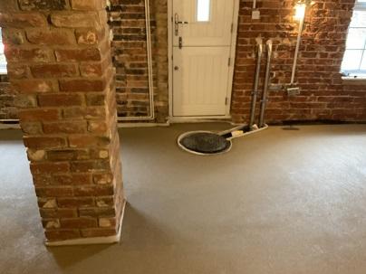

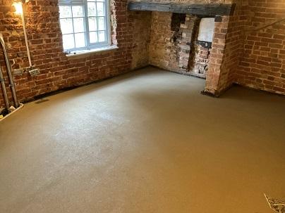

Roger440 Posted January 28, 2022 Share Posted January 28, 2022 43 minutes ago, Ben Weston said: It can be made of whatever we want! It's being dug up and started again. It'll have wet underfloor heating if that makes a difference but the construction just has to pass Building Control. It was clear to me in our house the concrete floor with plastic underneath was at least part of the damp issue. Moisture is effectively forced outwards, until it finds the wall. So we used a system like this in ours to avoid any repeat issues.https://www.lime.org.uk/products/sublimer-insulated-limecrete-floor.html Was it absolutely necessary? Cant be sure. But had we gone the modern route, then had damp again, bit late at that point! This effectively returns it to how it was built. And, in theory, isnt likely to cause any issues, bearing in mind that for several months until 2 weeks ago, it was bare earth. And completely dry. However moisture is still rising. Leave a piece of cardboard for week and it will start to form mould where it touching the soil. Humidity even with no floor is 60%. Link to comment Share on other sites More sharing options...
Ben Weston Posted January 28, 2022 Author Share Posted January 28, 2022 This is really interesting, Roger, and makes sense. Will look into it, thank you. I instinctively prefer natural materials and have always liked lime render. Wasn't aware of limecrete until now. Link to comment Share on other sites More sharing options...
Roger440 Posted January 28, 2022 Share Posted January 28, 2022 8 minutes ago, Ben Weston said: This is really interesting, Roger, and makes sense. Will look into it, thank you. I instinctively prefer natural materials and have always liked lime render. Wasn't aware of limecrete until now. The good thing with the system is the insulating layer is also the sub base. Total depth is 225,, Piccy of freshly installed floor. 1 Link to comment Share on other sites More sharing options...
Ben Weston Posted January 28, 2022 Author Share Posted January 28, 2022 Looks great! Could I ask how the pricing compares to a more traditional PIR + concrete slab floor? Link to comment Share on other sites More sharing options...
Roger440 Posted January 28, 2022 Share Posted January 28, 2022 21 minutes ago, Ben Weston said: Looks great! Could I ask how the pricing compares to a more traditional PIR + concrete slab floor? No idea! Didnt worry about it as using PIR and concrete was not ever a consideration. But expensive i think is the right answer. I prepped it, they put the glass and membranes down, i fitted the heating pipes, then they came back and laid the limecrete. With hindsight i could easily have done the glass and membranes too. Link to comment Share on other sites More sharing options...
