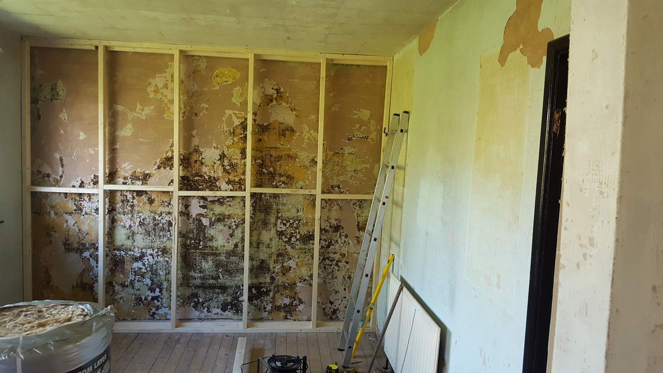

Ferdinand Posted April 30, 2017 Author Share Posted April 30, 2017 (edited) Thank-you for the comments. At present I have heating plumbing under the suspended floor, which I was hoping to reuse while replacing rads (which would give me effectively oversized rads when I improve the thermal envelope to let the new boiler run more efficiently). Not repiping the plumbing would save several hundred. I have an IWI acoustic wall on one side against the neighbour which is now at batten and noggin stage, and the property is compact. Services could go in there. But I am now thinking about organising my battens on the 'floating' floor to give me uninterrupted service voids along appropriate sides. You have reminded me that I did this several years ago under a floating floor in a conservatory, and it worked very well. Relocating pipework to be wiThin the thermal envelope (planning under suspended floor insulation too as above) is looking a better option. Far tidier than designing all those layers to be easily cut through. Very Occam. Ferdinand Edited April 30, 2017 by Ferdinand Link to comment Share on other sites More sharing options...

Ferdinand Posted May 1, 2017 Author Share Posted May 1, 2017 (edited) Thanks for the feedback so far @Onoff @ProDave @MikeSharp01 @Nickfromwales So, working with this, I get: 1 - No pipes under the suspended floor. 2 - My battens arranged such that there is a 63mm deep x approx 200mm void all the way round all the walls. Including battens round the edge at the base of the wall. 3 - All electric (except that in the loft for lights, fire alarms etc and a few bits in stud wall where appropriate and gas in that void. Also water pipe and signal cables where necessary. 4 - Void filled with insulation just like the rest of the floor where unused, but probably round the outside walls as far as possible. For future adaptability. 5 - Maintenance by raising a row of click-fit tiles and a panel of screw-attached osb. 6 - Battens screwed to each other rather than to the floor where possible, to avoid more punctures in the air membrane than necessary. Questions and details: Existing insulation is a filled 50mm cavity, and there will be 100 or 200mm of rockwool under the suspended floor. A - Water pipe penetrations to rad are just a 50mm notch in the floor against the skirting. B - Electric wire runs to sockets at 450mm are normal mini-chases behind skirting boards to be added as decoration. Sockets either sunk-in or surface mount depending. C - Is it worth putting 25mm insulation into the 63mm deep (CLS on edge) void and the pipes etc on top of that. Can one cable clip or similar to 25mm Celotex? D - If I am running cables around the void where it is unavoidably against the outside walls, I am thinking I want some insulation against the horizontal cold bridge - eg a 100mm strip of insulation on the outside edge of the void alongside cable runs. Necessary? E - When screwing down battens to the suspended floor is this a place for a blob of silicone on each screw as it is screwed down? Cheers Ferdinand Edited May 1, 2017 by Ferdinand Link to comment Share on other sites More sharing options...
