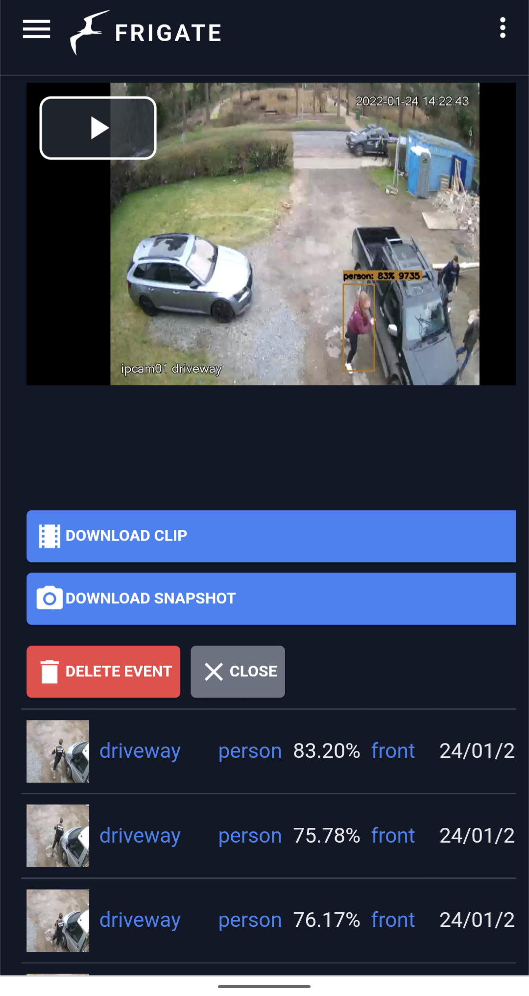

joth Posted January 25, 2022 Share Posted January 25, 2022 (edited) I recently set frigate.video up on the old server PC for CCTV recording and I'm very impressed with it. Planning to turn down my windows machine currently running BlueIris on. Frigate uses Tensorflow for real-time object detection, and works best with a coral.ai EdgeTPU. They're difficult to get hold of now (global chip shortages) but I did manage to but a M.2 PCIe one from RS. Two adapter cards later (M.2 R key to PCIe mini, and PCIe mini to PCIe standard!) and it's working very reliably. But for simplicity definitely get the USB Dev dongle if you can! Constant image detection hardly adds any power demand to the 50W this machine already draws (mostly on 6 spinning disk raid array) so I will knock 40W off my base load by turning down the other windows machine. Configuration took a bit of tuning, the cameras have substreams and it's best to use those for lower res feed for the image detection and then it will record clips from the corresponding high Res (8MP) feed when anything is detected. The built in webui is simple but very usable, far better than the clunky android app for BlueIris, or the QNAP NVR I briefly tried. Good MQTT support and a premade Home Assistant integration so easy to build into other use cases. I found the driveway PIR I installed was false triggering the front lights all night, so I've disabled that and instead use the "person" detector from the CCTV, covers a much larger area with so far (2 weeks) zero false positives. We have a shared driveway, with the zones and masks and detection I can easily set it to only trigger when someone walks on "our" side of the driveway. Great fun! I've set it to detect other interesting object types (car, bicycle, cat, elephant) but I think I'd need much higher res detection stream for cat detection to work, and our street is disappointingly devoid of wondering elephants. Edited January 25, 2022 by joth 1 1 Link to comment Share on other sites More sharing options...

AliMcLeod Posted January 28, 2022 Share Posted January 28, 2022 (edited) On 25/01/2022 at 08:25, joth said: ...our street is disappointingly devoid of wondering elephants. Nice set-up - i've still not gotten around to selecting cameras for us - have this great dream about doing number plate recognition and linking that in to our gate (which is electrified but not yet automated) so that it automatically opens for pre-defined friends/family. On a less serious note, how does Frigate Video work out the contemplative status of elephants? Edited January 28, 2022 by AliMcLeod 1 Link to comment Share on other sites More sharing options...
