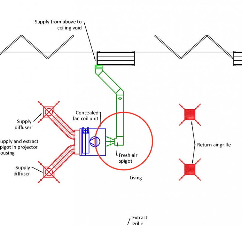

Critique my complex(ish) mech plan - 2 floor UFH, 2x ASHP, 2x dedicated ventilation..
puntloos
So - it has come to this. As I indicated a long time ago I wanted to be *sure* my house would not overheat, and I don't think I can safely do it with UFH (condensation) so at the end of the day, attached is my heating plan.. Would love to hear some feedback. There are a few things to note:
- 2 ASHPs side to side in the garden, one multi-split A2A, one A2W. Both mitsubishi.
- MVHR in loft, 5 FCUs that each can move about 2.5Kwh
- UFH everywhere too (eh why not)
- Solar is there but not indicated
- 400L standard tank - gledhill heatpump lite (I was debating an OSO but the 40W less loss amounts to like 1p a day.. not worth my while.
- Service shaft actually turns out not to be too used
- Both my boxed projector, and boxed network rack have dedicated air lines. Tied into MVHR (heating guy says it will not be a problem to beam 400 resp 1000W (peak) worth of heating into the MVHR
- No hot/cold buffers currently since these inverter-based devices can just run 'as much as needed' rather than alternating on/off but I could be persuaded
Looking fwd to hearing any further thoughts ;)

Certainaly very belts and braces! Unless the house is not particuarly well insulated and no shading?  Any summary info on the build relating to heating/cooling load, insulation, shading etc.
I don't follow this at all. What does "tied into" and "beam" mean? Additional fans to force air into? That will greatly unbalance the system and you'll probably just have the hot air blowing  back from other extract points.
At normal MVHR air movement rates, extracting an additional 1400W through  and MVHR is not going to happen.
Yeah I was wondering about this, but the guy said he accounted for it but I forget the detail. Let me ask.
Well, on the other hand e.g. cooking on a powerful hob would also generate an additional heat for a longish time. But yeah I will ask.

11 hours ago, puntloos said:
Quote
Yes but I don't put the hob in a small insulated box, and it is designed to deal with heat in a way that a rack of network equipment or a projector might struggle with, nor does it run for hours and hours at a time at full whack.
So long as there's a way to ventilate these electronics aside from the MVHR you'll be fine: worst case the respective rooms start to overheat and the FCU kicks in.

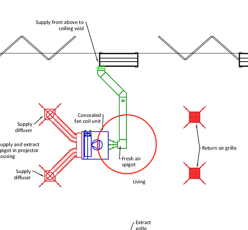

On the rooms with MVHR supply and FCU, will the MCHR "Fresh air spigot" be supply fresh air into the ceiling void (the -ve pressure supply plenum for the FCU) or into the room? If the former, you'll only get the fresh air supplied when the FCU is operating, which seems less than idea, but if the latter then I'd expect it to be nearer the "Return air grille" plenum inlets if the intention is to use the FCU to disperse fresh air (which appears to be the intent)
EDIT: looking at the first floor, it does indeed seem you only get fresh air supply when the FCU is running. I'm not sure how wise that is. The MVHR fresh air supplies are directly tied into the FCU supply plenum which might make balancing the whole system a lot more complex, and if you run any FCU at high speed it might suck air out of the MVHR network, pulling air back up out of other supply-side rooms. What I've read suggests it's easier to commission and operate if the two systems air kept independent, and I've generally seen the FCU acting as an optional agitator of the fresh air supply once it's already made it into a room (e.g. by positioning the supply vent somewhere near the FCU intake)
How will downstairs FCU be accessed for maintenance, filter changes?
If the ceiling void is being used as an open negative pressure plenum (which I think is the intent, as there's not pipework shown from the Return air grille to the FCU) then is any special allowance made to avoid trades leaving a lot of dust and plaster and general sh*te in the void that it will blow around? Is there no rockwool for sound insulation between ceiling and floor above,  to impede air movement in that channel?
Interesting point. Yes I think it is the former (into void only). I will ask to clarify. Perhaps the FCUs are intended to run permanently but even with the heat/cool off that sounds less than ideal.
The assumption is the ceiling void can be opened. But it will need to be designed to allow this of course. (and as.. I think you pointed out elsewhere) - I also need to make sure the downlilghters are designed around the FCU sections. will need some careful planning.
My understanding is that yes there is rockwool, and we need to understand how much air it will let through, and work out those details.
1535567340_Screenshot2022-01-19at12_47_26.thumb.png.96959b389f091ed8c176dc835580382c.png
Thank you for your comments, these are all very worth figuring out today rather than later...
