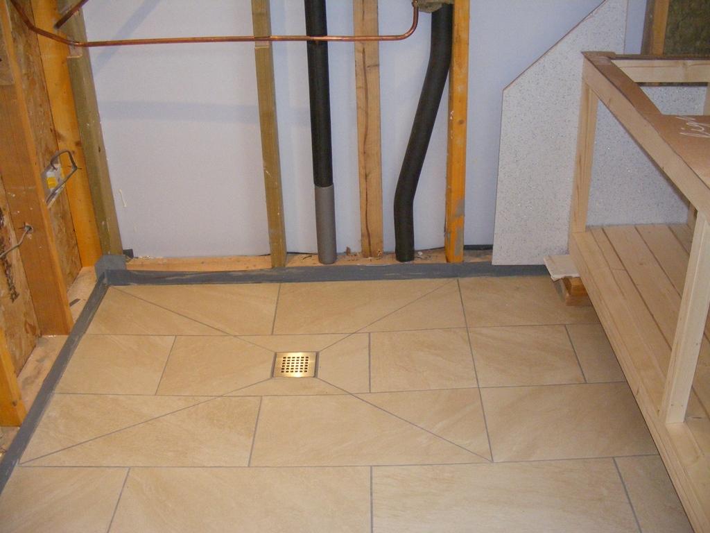

GaryM Posted January 16, 2022 Share Posted January 16, 2022 Hi I'm just about to start tiling the wetroom floor, I'm happy about the membrane and most things but never attempted the shower former before so does anyone have any tips or advice on the layout and cuts needed for the tiles. To make a life a bit more difficult the the drain is off centre. Thanks Gary Link to comment Share on other sites More sharing options...
ProDave Posted January 16, 2022 Share Posted January 16, 2022 It's called a "union jack" cut from the corners of the drain fitting to the outside corners of the shower tray. Cut the tiles and get the cuts right and neat before you even start mixing adhesive. Link to comment Share on other sites More sharing options...
Onoff Posted January 16, 2022 Share Posted January 16, 2022 First time I'd ever cut tiles and I decided to do tiles in the wet room corner! 1 Link to comment Share on other sites More sharing options...
saveasteading Posted January 16, 2022 Share Posted January 16, 2022 1 hour ago, ProDave said: cut from the corners of the drain If that is your work you will get a heart from me. Link to comment Share on other sites More sharing options...
ProDave Posted January 17, 2022 Share Posted January 17, 2022 9 hours ago, saveasteading said: If that is your work you will get a heart from me. No my tiler friend did that at mates rates. He has a better tile cutter than me. Link to comment Share on other sites More sharing options...

GaryM Posted January 17, 2022 Author Share Posted January 17, 2022 17 minutes ago, vala said: @GaryMIf you haven't purchased a former yet have a look at the infinity option from On the Level. This is what I have and it's just 1 slope to the wall so no cuts to make. Thanks for the reply The shower former is already installed, It needed to be robust and the same thinkness as the floor. I went for a impey aqua dec, found it new on ebay for a good price. I'm quite happy cutting the tiles, another challenge to conquer, just trying to find out the layout to use. Looking at replies i just need to do diagonals radiating out from the square waste. Link to comment Share on other sites More sharing options...
