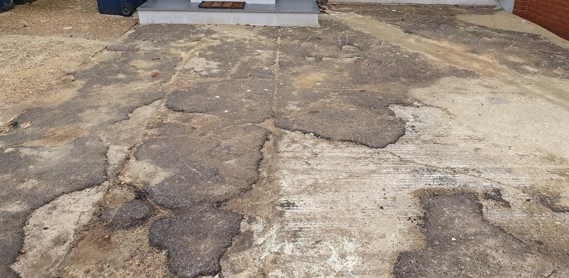

It is an existing front drive, 6m by 6m and around 5 degree slopped outward to the street side.
Existing build-up is around 250mm thick concrete + patchy lose tarmac. A flower bed is planned around the side and front edge, where water can be drain to.
I do not want to dig up the thick concrete in this scenario. I am thinking of
1. remove tarmac
2. repair existing concrete to achieve a smooth and sloped surface
3. Finish the surface with resin bound on top
May I ask if this is the best and cost effective option? Any other brighter ideas that you can share here?
Thank you

Tarmac the lot.
First clean the muck off.
Then get a specialist to do it, as they will fetch the material and lay it. It is a skill.
They should really fill up to existing tarmac level and roll, and then spread the whole area and roll again, to avoid bumps.
It needs a tack coat of bitumen first so that it stays stuck.
Tarmac remains flexible and will survive over the cracks, but resin won't.
That looks like it was concrete, and the passing  travellers put a very thin coat of tar on with no preparation and it has predictable failed.  As above get it done properly next time.
+1 to both of the above.
had the concrete been a single crack free slab then grinding would have been an option, but the cracks will come straight through a resin surface so it’s tarmac or dig up and replace.
Resin bound is strong but will heave / sink and crack if the substrate moves - it is not that thick itself, maybe 30mm.
Ours sits on 70mm porous tarmac which itself sits on a generous layer of compacted shingles and type 1.
After 5 years we have a few small cracks, all from the corners of a drain which must have settled over time.

Thus a proper tarmac contractor is the best way to go.
