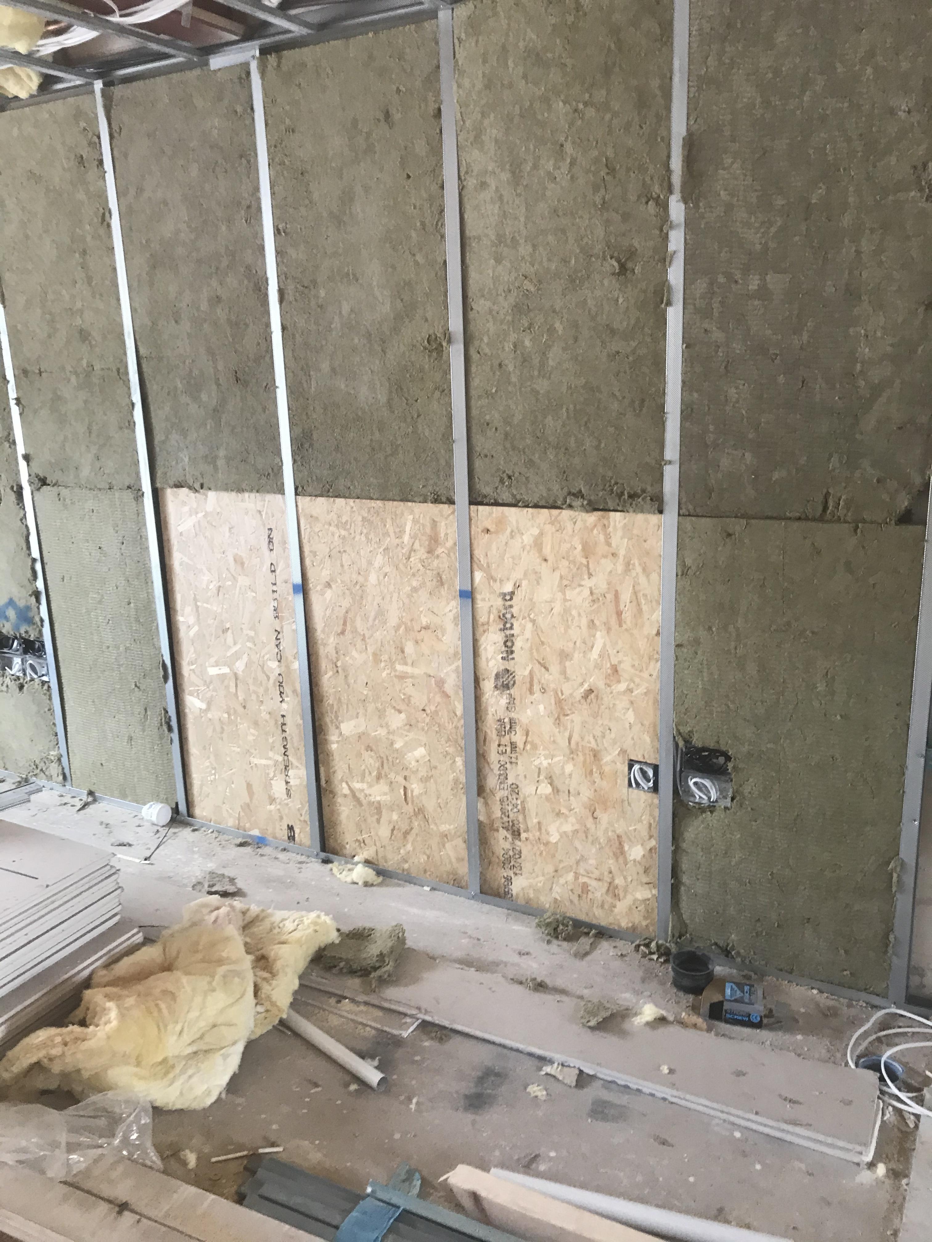

nod Posted January 9, 2022 Share Posted January 9, 2022 The ones that are pictured where put in for sound While pir stats may look slightly better The rock wool give a tighter fit Behind the gypliner and around the brackets 1 Link to comment Share on other sites More sharing options...

nod Posted January 9, 2022 Share Posted January 9, 2022 25 minutes ago, nod said: The ones that are pictured where put in for sound While pir stats may look slightly better The rock wool give a tighter fit Behind the gypliner and around the brackets You could always dab insulated pb directly to the wall Not as good as an air gap but easy option Link to comment Share on other sites More sharing options...
