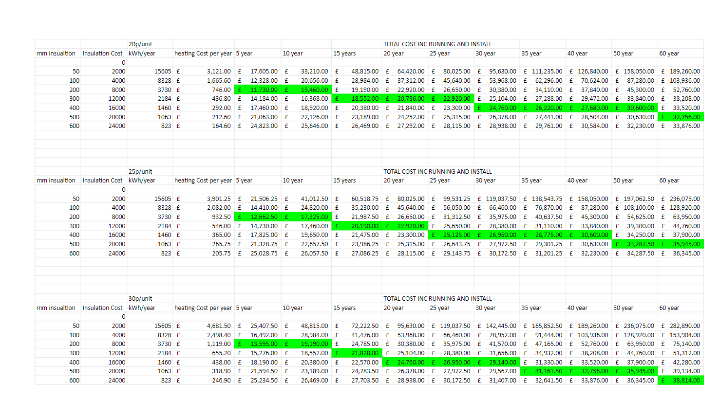

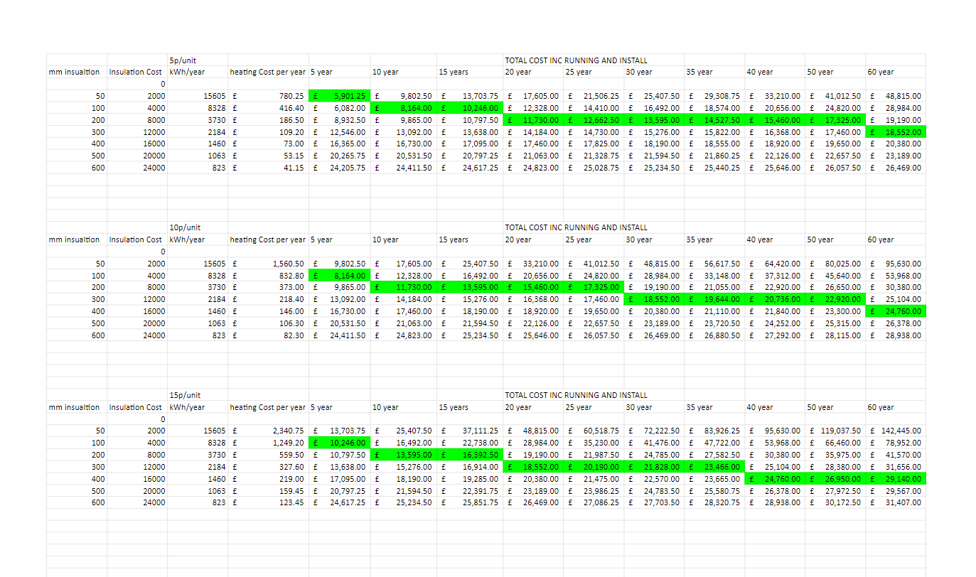

Iceverge Posted January 9, 2022 Posted January 9, 2022 It only depends on two variables. Unit price of energy and length of tenure. Here is a crude approximation with equal insulation roof, walls and floor. This is for our house using cheap insulation (0.037W/mK) in a mildish area in the South of Ireland. For most people building a futureproof house isolated from the worst energy price hikes to 20 years+ . Southern coastal areas 200mm is enough. Most of the British Isles 300mm is a solid bed. North of Scotland 400mm insulation is best. 1 1
Marvin Posted January 9, 2022 Posted January 9, 2022 Thanks for the info @Iceverge. It would be nice to have it broken down to cost per m2 so I can relate that to my home, and probably others would too. How many m2 was this over?
Iceverge Posted January 9, 2022 Posted January 9, 2022 Approx 200m2 wall, 100m2 floor and 100m2 ceiling. 400m2 envelope excluding windows. 185m2 floor area. At the moment floor insulation is about £35/m2 for a U value of 0.1W/m2K, much the same for cavity wall batts and loft roll is only £12/m2 for a flat ceiling. There's almost no extra labour cost increasing flat ceiling insulation to 400mm ( 2x200 mm loft roll) so I think that is really a no brainer. Going from Bregs backstop to 0.11W/m2k will cost £5/m2. Similarly floor insulation is really only a material cost so I would use 300mm EPS (2 x 150mm) To go from Bregs to 0.12W/m2K at a cost £15/m2. Both are peanuts over the scale of a project for something that will last the lifetime of the building. Unlike fancy heating devices or renewables, insulation will pay itself off at some stage. Guaranteed. Wall and pitched ceilings are more expensive to think about as they come with extra costs in footings, wall ties, window and door openings, timber costs etc but aim for a U value of 0.2 at the maximum. As usual this is in addition to the usuals about airtightness, MVHR and 3G. 1

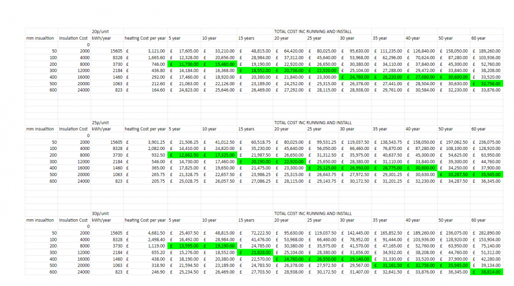

saveasteading Posted January 10, 2022 Posted January 10, 2022 22 hours ago, Iceverge said: It only depends on two variables A very interesting table thanks. looking at 20p/unit as an example it is shown that upgrading from........... 100mm to 200 costs £4,000 and saves £ 920 per annum. An impressive return BUT from ...500mm to 600 costs £4,000 and saves £ 48. per annum A payback of 80 years. In normal times you could invest (or not borrow) that cash at say 3% and earn £120. Guessing what energy will cost in 50 years ....well I can't. Maybe it will be cheap or maybe humanity will be dressed in pelts. Also, it is simplistic to only allow the cost of the insulation purchase. In the floor, the structure is being heightened by that amount. In the walls the lengths of the walls are being extended or the inner space reduced,. In the roof, 11 hours ago, Nickfromwales said: anything over 300mm of roll /wool insulation has more weight than it can support this creates a limit, OR we apply additional structure to support the extra. What this table does show is that the calculation assumes that the outer thickness of insulation is not doing anything like as much as the inner insulation. Which is what I speculated (no more than a hunch) many messages ago. Do you know what the assumptions are in these calculations? They appear to be more realistic than the manufacturers' or Building regulations imply/ assume. What an interesting table though.
