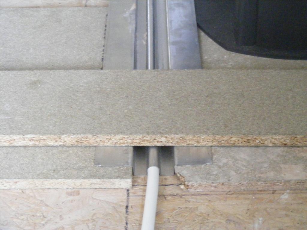

ProDave Posted December 26, 2021 Share Posted December 26, 2021 Do something similar to what i did in our utility room. This is just a mock up when i was working out the detail, I can't immediately find a picture of the actual thing. so you have a chipboard floor down screwed and glued. Cut strips of chipboard to match your pipe spacing and lay them across the floor so they are spanning joist to joist (on top of the chipboard. Under floor heating pipes with aluminium spreader plates laid on top. Final floor covering laid over that, shown in this mockup with a strip of chipboard, this will be your engineered floor boards. Link to comment Share on other sites More sharing options...

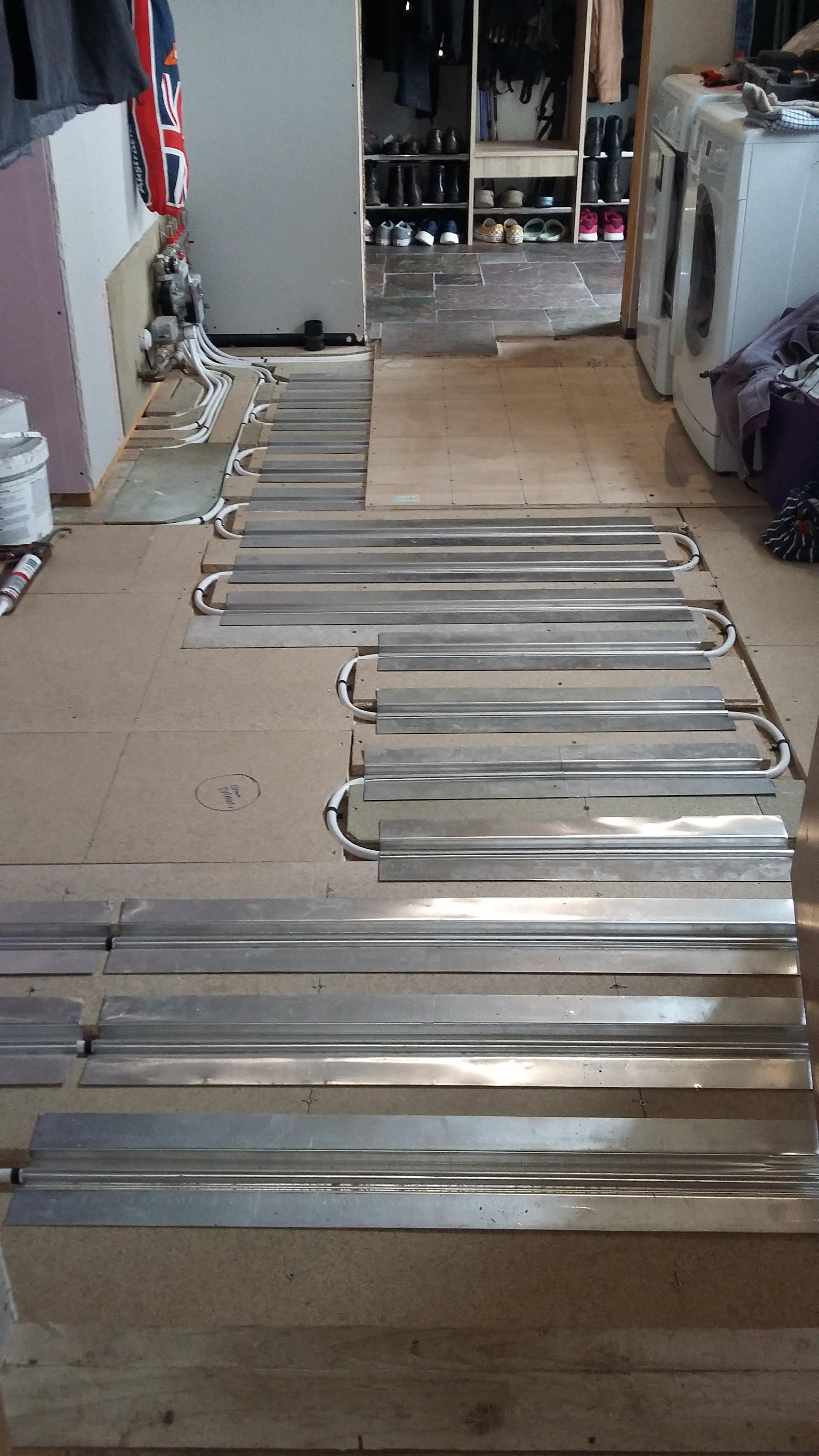

ProDave Posted December 27, 2021 Share Posted December 27, 2021 1 hour ago, markocosic said: What do you have over the top of it as a final finish, and how does it perform in terms of output and any clicking and clacking as the pipework expands and contracts? Here is a picture of it in progress. You see the UFH pipes with the spreader plates suspended on the strips of chipboard flooring, then on top was 18mm ply, glued and screwed to hell then the tiles. The bits with UFH missed out, on the right is where the row of units will go, and on the left, there is an area left out where there is provision for one day fitting a shower (and then dividing the room in two) so no UFH where the shower might one day be installed. Link to comment Share on other sites More sharing options...
