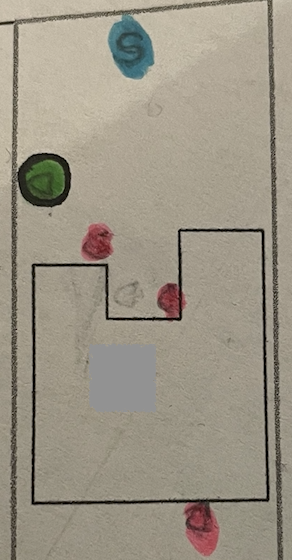

Mania Posted December 26, 2021 Share Posted December 26, 2021 Good morning! I hope you all had a good Christmas! Please can you help? I am looking to submit a Section 80 - Notice of Demolition to get this part of admin out of the way. I asked the Building Control team what they need in relation to "any drains and sewers to be sealed, disconnected or removed". So I marked them on the site plan as attached: Pink = Drain Green = Underground Drain Blue = Sewage Drain And sent the plan attached for feedback and received the following advice, "We require more information on the drawing showing the drain runs for the existing drains and sewers which are to be sealed, disconnected or removed. The drawing you submitted looks as though it shows just manholes and gullys" Does anybody have any tips or examples on how to present this information? This is a 1930's bungalow and I don't know if there will be any site plans anywhere. We will be able to work it out roughly but I have no clue on how to present this additional information. Do I literally just draw lines of the pipes? I am horrified that my husband has just told me that the manhole in our kitchen by the back door is to the sewage ? Thank fully I have never smelt anything. Thank you. Mania Link to comment Share on other sites More sharing options...
tonyshouse Posted December 26, 2021 Share Posted December 26, 2021 Mark the manholes and say that drains/sewer sealed temporarily in the manholes with drainage bungs and left ready for reconnection probably only need one of each pink are irrelevant if house being demolished 1 Link to comment Share on other sites More sharing options...
Mania Posted December 26, 2021 Author Share Posted December 26, 2021 22 minutes ago, tonyshouse said: Mark the manholes and say that drains/sewer sealed temporarily in the manholes with drainage bungs and left ready for reconnection probably only need one of each pink are irrelevant if house being demolished Thank you Link to comment Share on other sites More sharing options...
saveasteading Posted December 26, 2021 Share Posted December 26, 2021 3 hours ago, Mania said: The drawing you submitted looks as though it shows just manholes and gullys" I think they want to see the drain runs, ie lines showing the pipes to and from the manholes and gullies. 2 Link to comment Share on other sites More sharing options...

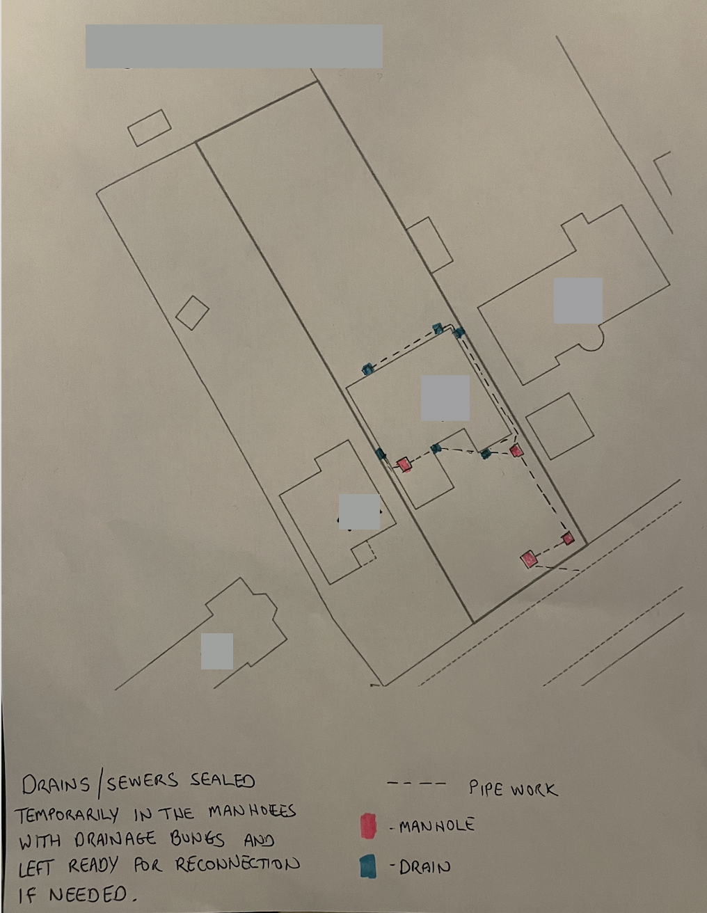

Mania Posted February 5 Author Share Posted February 5 Hi Thank you all for your help. After serving our Section 80 notice we received the counter Section 81 notice within a week. To help others I attach a sample of what we submitted: Link to comment Share on other sites More sharing options...
