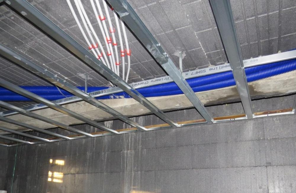

Nick Laslett Posted February 8, 2022 Share Posted February 8, 2022 On 07/02/2022 at 21:48, NickK said: @Nick Laslett, do you have MVHR? If so what is the total build up of first floor to allow for ducting? Thanks Good question. We will be having MVHR. There will be a suspended ceiling on the ground floor. For upstairs the ducts will run up through the floor, we put down small EPS blocks attached to the rebar when they did the first floor concrete pour. I have attached a picture from the manual. We are not at this stage yet. 1 Link to comment Share on other sites More sharing options...
NickK Posted February 9, 2022 Share Posted February 9, 2022 Thanks @Nick Laslett. I guess it wouldn’t be a best solution for when ridge height is restricted and you want decent ceiling height. This must 450mm total build up??? in comparison to posi joists which may be 300?? Link to comment Share on other sites More sharing options...
Nick Laslett Posted February 10, 2022 Share Posted February 10, 2022 19 hours ago, NickK said: Thanks @Nick Laslett. I guess it wouldn’t be a best solution for when ridge height is restricted and you want decent ceiling height. This must 450mm total build up??? in comparison to posi joists which may be 300?? The Thermohouse house ICF blocks are 250mm high. To not fight the system, we made our ground floor 2750mm, 11 blocks high. The Thermoboard used for the first floor is 160mm thick + 90mm concrete, 250mm in total. So the first floor is 3m from FFL. For the drop ceiling, I’m not sure of the building regs requirements, currently I plan to have a perimeter box section that drops 250mm to take most of the services and allow 2x90mm MVHR ducts to cross over. For the inside section of the ceiling I plan for a 150mm drop. A big enough gap for 1 duct and in ceiling speakers with fire hood. So ground floor ceiling height for most of the space would be 2600mm. In a few weeks I will be starting this process, so I might find I can gain 10mm - 25mm extra height. Link to comment Share on other sites More sharing options...
