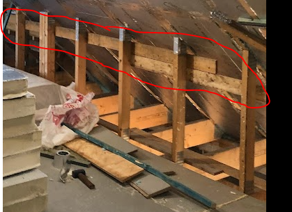

crispy_wafer Posted December 23, 2021 Share Posted December 23, 2021 Any tried and tested recommendations for multitool blades for wizzing through nails? Loads on Amazon, which makes the choice too difficult... Dewalt fitment, Link to comment Share on other sites More sharing options...
Conor Posted December 23, 2021 Share Posted December 23, 2021 Saxton are very good for the money Link to comment Share on other sites More sharing options...
ToughButterCup Posted December 23, 2021 Share Posted December 23, 2021 2 hours ago, crispy_wafer said: ... blades for wizzing through nails? ... Angle grinder. 3mm blades.... cheaper , quicker maybe? Link to comment Share on other sites More sharing options...
crispy_wafer Posted December 23, 2021 Author Share Posted December 23, 2021 sorry, my fault, I didn't give any context for use, I'm temporarily removing the bracing on the roof trusses as the spacing on the bracing is too tight between the uprights and chords So I can fit my inner layer of insulation. Link to comment Share on other sites More sharing options...
markc Posted December 23, 2021 Share Posted December 23, 2021 Mulitool is very slow cutting through nails even with expensive blades. Knock or bar the timber back as far as you can then get a hacksaw in. Much quicker and easier Link to comment Share on other sites More sharing options...
Tosh Posted December 23, 2021 Share Posted December 23, 2021 Multitool will be very slow........could you pry the timber slightly and use a recip saw Link to comment Share on other sites More sharing options...
