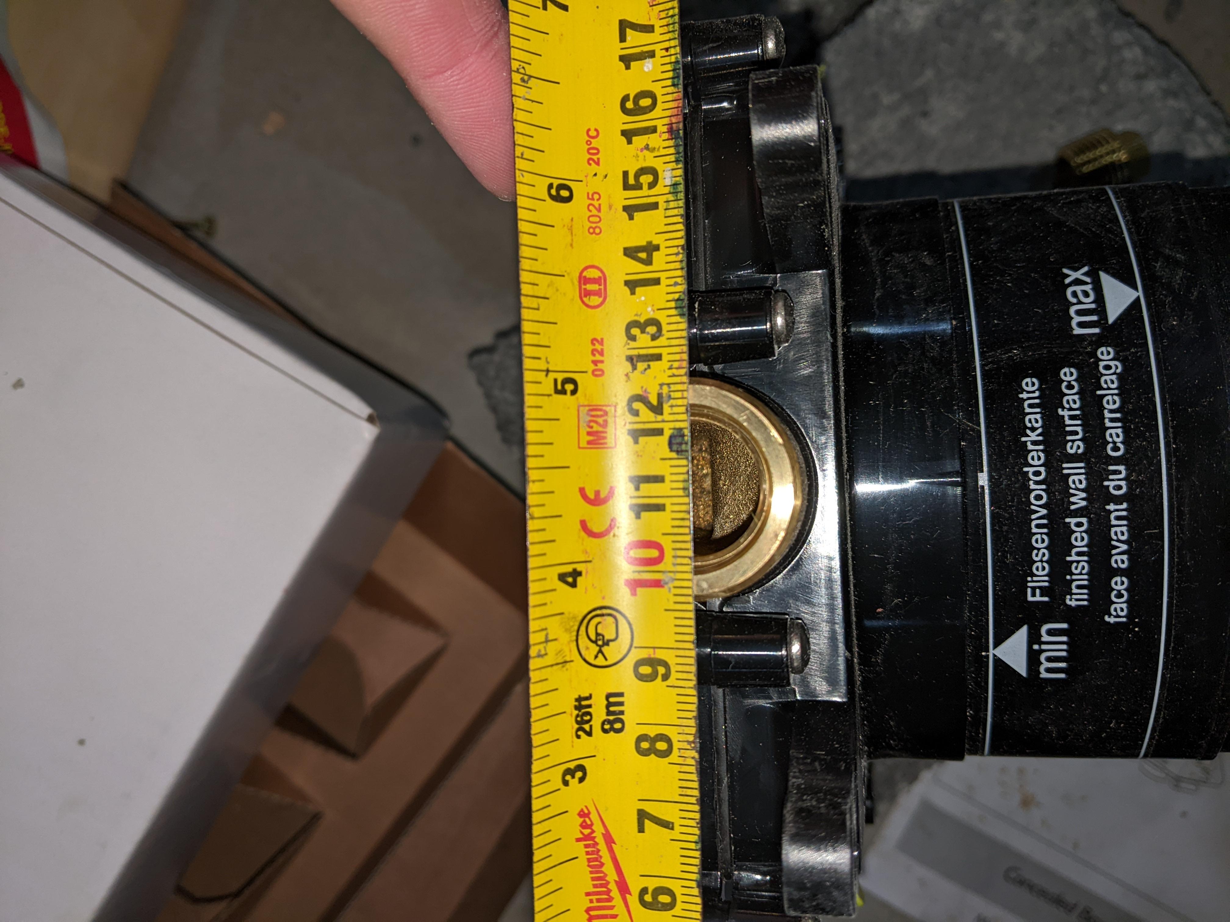

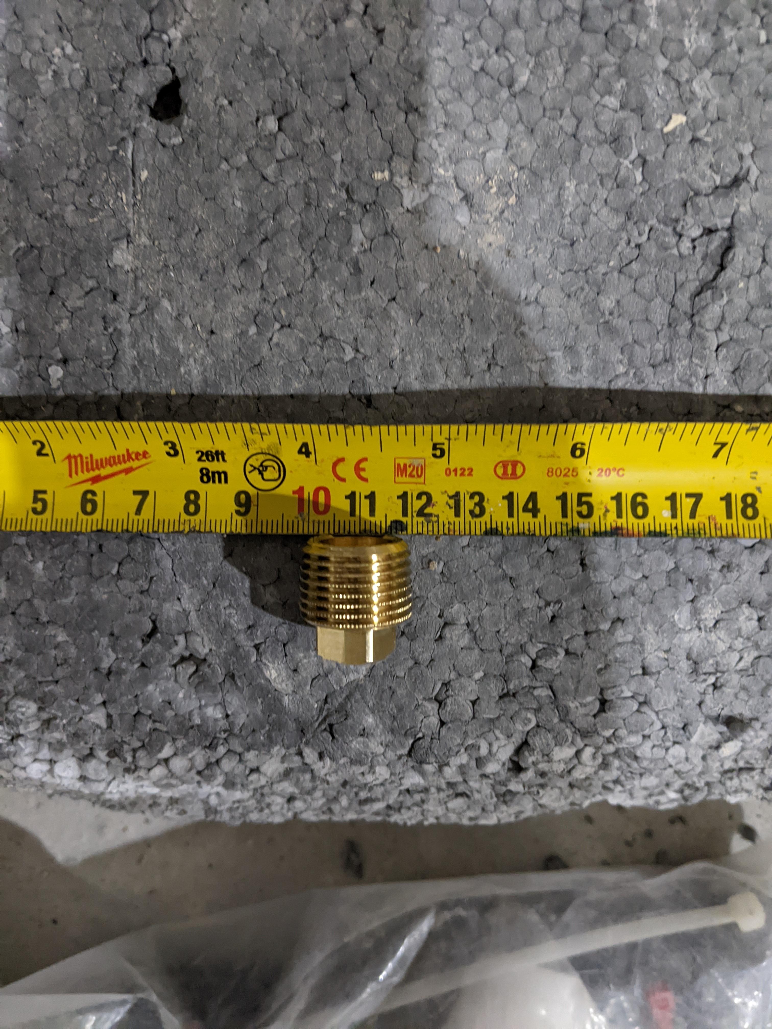

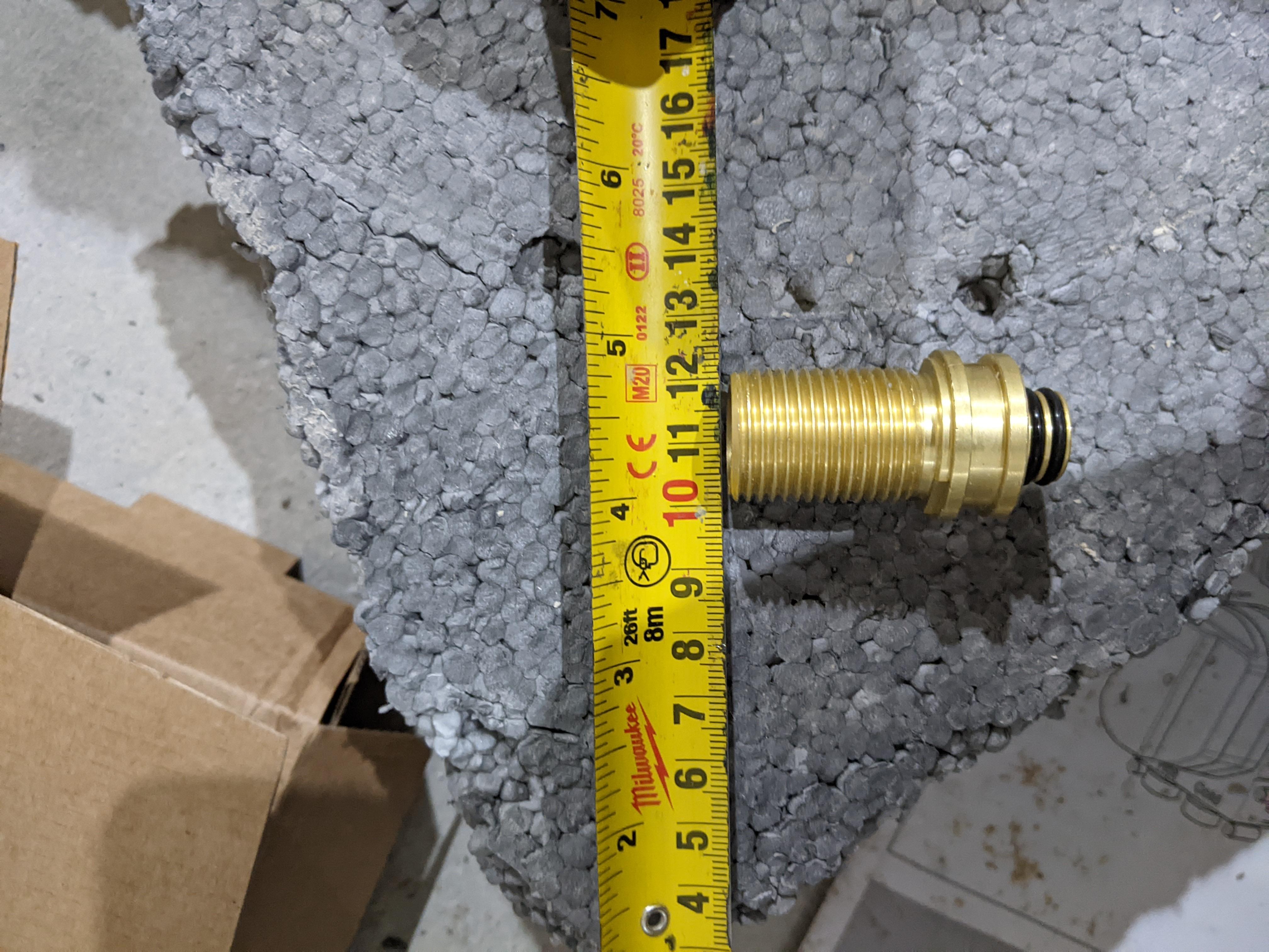

Conor Posted December 23, 2021 Share Posted December 23, 2021 (edited) My plumbing expertise stops at anything involving threaded fittings, basically anything that's not push fit. i'm forced in to the position of having to fit our cross water two way valve mixer, shower head and hand shower. All my pipework is 15mm PET. The valve box has threaded female brass ports: They seem to be about 18-20mm internally. 3/4" BSP? Blanking plugs that fit in to unused ports: I just need the right fittings to get from that too 15mm pipe Now, the shower arms. The are the same size thread as the ports. How do I fit these to the wall? A thin timber ground with backing nut? there's not much thread to work with and our stud build up is 18mm ply, 12.5mm PB, tanking, 12mm tiles. I'm thinking I'll need to put a strip of ply instead of PB Edited December 23, 2021 by Conor Link to comment Share on other sites More sharing options...

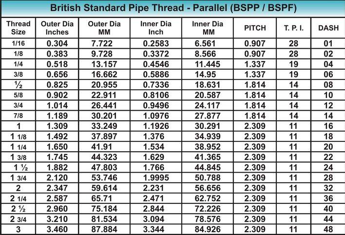

Onoff Posted December 23, 2021 Share Posted December 23, 2021 Those fittings are 1/2" BSP. Does this help 1 Link to comment Share on other sites More sharing options...
Conor Posted December 23, 2021 Author Share Posted December 23, 2021 Perfect. So can I assume mine is 3/4"? SO just need the wall plate elbows, short section of 22mm pipe then reduce to 15mm? I've already pulled the 15mm pipework through the studs so that can't change at this stage. Link to comment Share on other sites More sharing options...

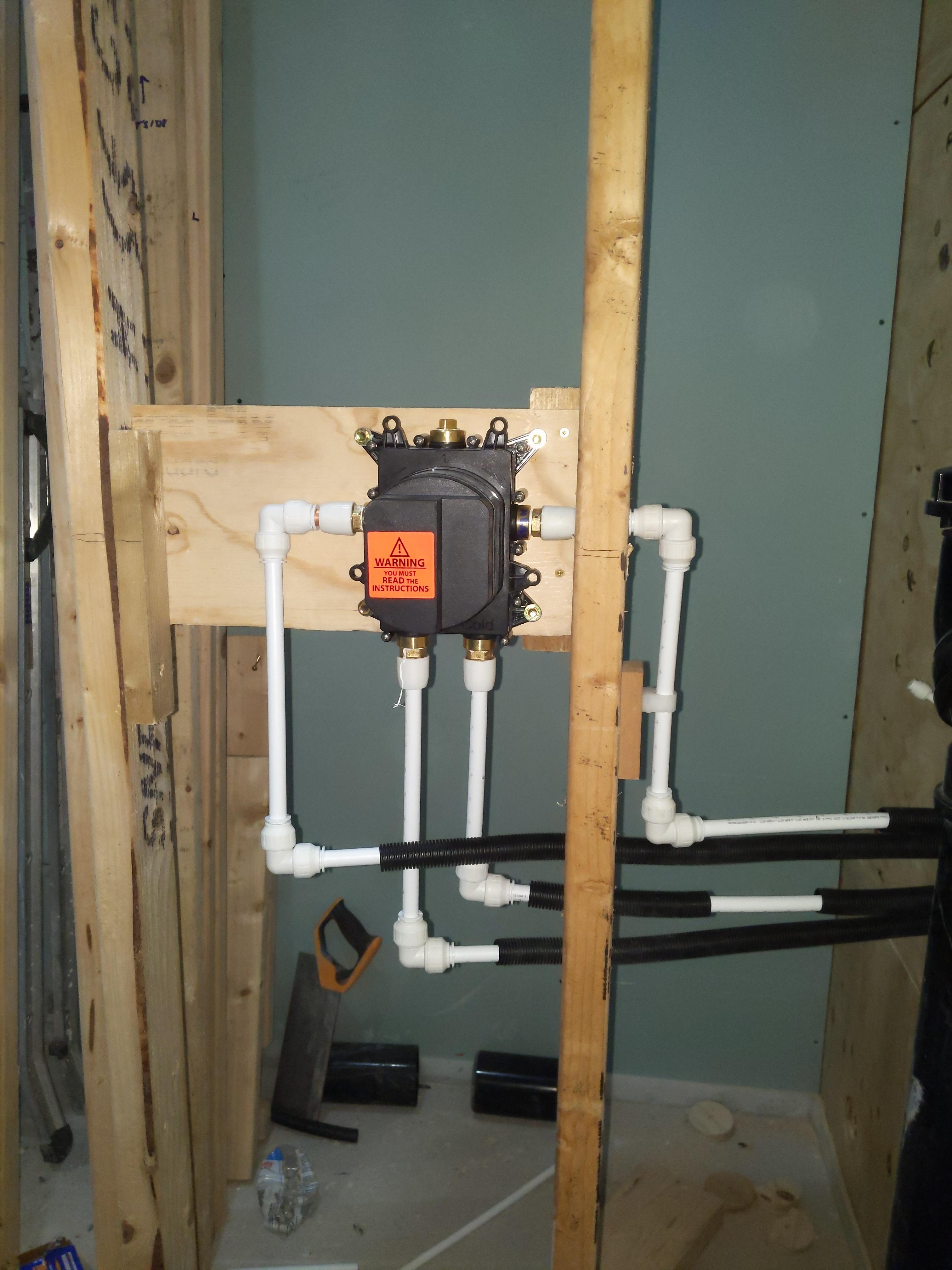

Conor Posted December 23, 2021 Author Share Posted December 23, 2021 Job done. Phase 1 anyway. Link to comment Share on other sites More sharing options...
Conor Posted December 23, 2021 Author Share Posted December 23, 2021 Next question. This is the hand shower and the wall plate elbow. I'm assuming the shower fitting will have to be fully tightened in to the elbow fitting for it to be sealed? So then I'd need to get the positioning of the elbow exactly right? Link to comment Share on other sites More sharing options...
Onoff Posted December 23, 2021 Share Posted December 23, 2021 11 minutes ago, Conor said: Next question. This is the hand shower and the wall plate elbow. I'm assuming the shower fitting will have to be fully tightened in to the elbow fitting for it to be sealed? So then I'd need to get the positioning of the elbow exactly right? See page 46 of my mega thread and what @Nickfromwales said on Jan 14: Link to comment Share on other sites More sharing options...
