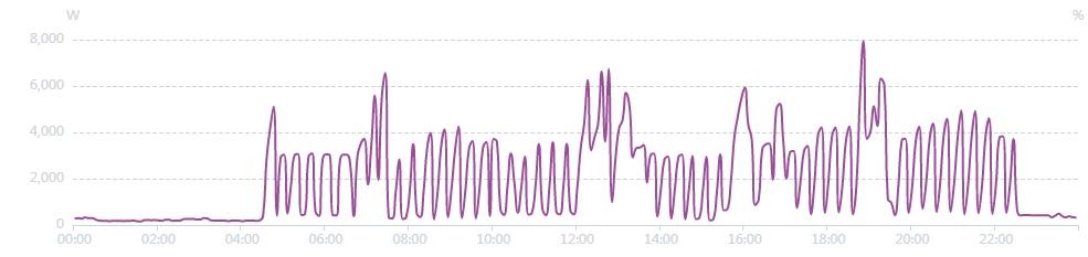

J1mbo Posted December 14, 2021 Share Posted December 14, 2021 41 minutes ago, ReedRichards said: I don't think my heat pump is capable of being fully optimised; is yours @J1mbo? It will either target a fixed output water temperature or it will target an output water temperature that varies according to the outside temperature ("Weather Compensation"). So my radiator surface temperatures vary as the heat pump cycles but the peak surface temperature only goes down if the outside temperature warms up. This was my entire house power consumption yesterday (relatively mild for December). Observe the time where the system has zero output. But the structure doesn’t magically have zero thermal loss in that same window, and that cumulative energy deficit has to be replenished by the ASHP during the next heating period, and to do that the radiators must produce more output than they would otherwise be needed to, meaning the surface temperature of them will need to be higher than if the structure were heated continuously. There is clearly a trade off in running cost between running hours, average delivered flow temperature, average outside temperature, and likely electricity tariff rates that make this all a bit of a judgement. 1 Link to comment Share on other sites More sharing options...
