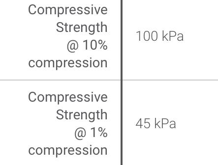

On our first and second floors, our build up is as follows:
1. 14mm engineered oak herringbone (small pieces) OR 14.5mm engineered oak long planks
2. 6mm ply
3. 25mm warmup branded expanded polystyrene foil faced UFH heating boards
4. 5mm dense rubber matting
5. 22mm Egger chipboard flooring
In the bathrooms we are actually using a Cellecta extruded polystyrene product that has a 250kpa compressive strength and can be tiled onto immediately, but for the hallways and bedrooms my builder said I could save money by going with the warmup product. The spec of this product says this
I tried squeezing it between my fingers and was surprised that I could reduce it’s thickness by 20% or 25% relatively easily, whereas I cannot do that with the Cellecta product. I told my builder to return it because I thought it was bad quality. He explained that in reality it will never be subjected to those sorts of pinpoint forces because the only and engineered wood will spread the loads. I’m sure he is right, to an extent, but I’m still nervous using something so flimsy feeling. I’m a heavy person 105kg, and I don’t want the floors to squeak underneath me.
Am I worrying about nothing or should I insist he return it? He has confirmed he can return it, but he thinks anything stronger is going to be significantly more expensive and that I’m wasting money on it.

100kPa is standard for under floor insualtion, you won't have any issues.

Being a bit more serious, and as much as I like SI units, some times it is easier for us to visualise things in imperial measurements.
45 kPa is 6.5 lb per square inch.
Now I have just measured my size shoe and estimated that the floor contact area is 3 inches by 9 inches, so two of them will be 54 inch2.
Now taking a mass of 105 kg, that is 230 lb.
Assuming that larger people have bigger feet, shall call it 60 inch2.
230 [lb] / 60 [inch2] = 3.8 lb.inch-2
Now on the face of it, all seems fine.  But is engineering, we don't work at the limit of the materials, and a safety margin is used.
A safety margin of 2 is not very large in my opinion.
I am also not sure if the @1% and @10% numbers are what happens when a load is applied, and it springs back, or after a load is applied and it is permanently deformed.  That would make a difference to floor movement.

I see a big flaw in you calculations lol. No one walks flat footed, they walk heal to toe and the pressure would be quite extreme at point of impact from the heal. Warm deck flat roofs have often be the subject of concern where infrequent pedestrian traffic happen ie window cleaning. The insulation can often be seen to have compressed where trafficked
but the 6mm ply will adequately spread the load so as not to deform insulation IMO.
Indeed. Another problem with @SteamyTea’s assumptions is that he forgets that whilst walking all weight will be oscillating from one foot to the other.

The hallway will take much more peculiar loads than a tiled bathroom floor, but I was really agreeing with you that a gut feeling is that it is not going to be robust enough.
