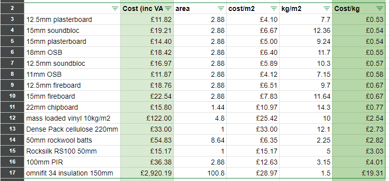

Iceverge Posted March 17 Share Posted March 17 You need to deal with 1. Airpaths - lots of acoustic mastic at any joints and at the walls. Seal all gaps. 2. Reverberation - A layer of fluffy stuff just to stop the drum effect.Thats why 175mm won't make much difference Vs 100mm here. 3. Impact noises - decouple the surfaces. You've done this with the resilient bars and to some extent the cork. 4. Add Mass. Plasterboard, standard or soundbloc or OSB is the cheapest way, more the merrier. (Insulation is a dear way to add mass) 1 Link to comment Share on other sites More sharing options...
Moonshine Posted March 18 Share Posted March 18 (edited) 7 hours ago, Iceverge said: Impact noises - decouple the surfaces. You've done this with the resilient bars and to some extent the cork. Agree which the process you outline, but the res bars don't do much to control impact noise. Not sure what the Cork product is? @SimonD can you give any more details of your floating ply floor (do the panels interlock) what is the cork product? I dont think this will do much for reducing impact noise. Also make sure you put a resilient flanking strip round the perimeter of the room for it to be truly floating. Also I presume your are not screwing the ply down. Also why wood wool boards under the joists? 100mm in the cavity is fine, you don't really need more there, just make sure it has a decent density (BG spec a min 12 kg/m3 though I feel 24 kg/m2 is a better min) Put some res bars under the joists and a layer or two of 15mm Soundbloc. Boards staggered, and different length screws for each layer of boars, tape and joint it, with flexible mastic at the perimeter BTW these sorts of build ups are more akin to floors separating flats and internal floors don't need so.much treatment for building regs (unless you want to do this and have the money too). Also any areas which are carpeted and will stay that way won't need a resilient layer as the underlay is it Edited March 18 by Moonshine 1 Link to comment Share on other sites More sharing options...
