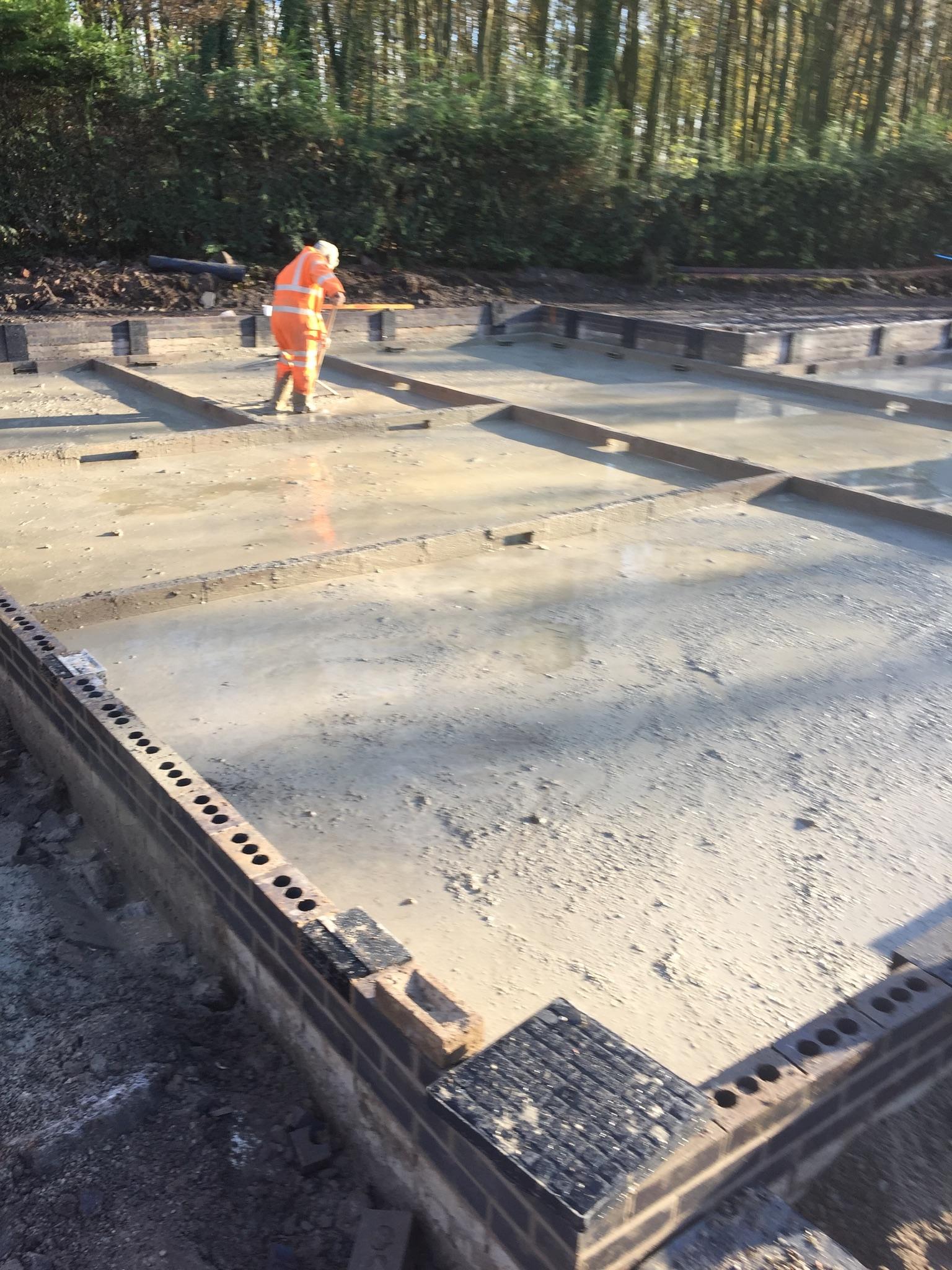

eandg Posted December 5, 2021 Posted December 5, 2021 Needing to confirm the number and location of periscopic vents asap before groundworkers' brickie is out. Scottish Building Regs require: Presume it's floor area for the ground floor only? A standard 220x215 vent like this appears to give 6600mm2 air flow so by my reckoning my 14m wide walls would require 4 on each side (1500x14/6600=3.18). Is that right?
nod Posted December 5, 2021 Posted December 5, 2021 I did ours at 1800 apart and left letter boxes out of the internal support walls
ProDave Posted December 5, 2021 Posted December 5, 2021 Our house has 8 along an 11M wall, so either mine is over ventilated, or yours will be under ventilated.
eandg Posted December 5, 2021 Author Posted December 5, 2021 10 minutes ago, nod said: I did ours at 1800 apart and left letter boxes out of the internal support walls Is the letterboxes just belt and braces good practice? Can't see anything on the regs but would appear to make sense and allow airflow through.
nod Posted December 5, 2021 Posted December 5, 2021 No you definitely need them to circulates the air and in case of flooding will stop the water getting trapped I also added a drain with a none returned valve Thatme looking miserable spreading four cube of concrete on my own in the rain Real simple I chopped a concrete lintel up and left a couple of bricks out 1
