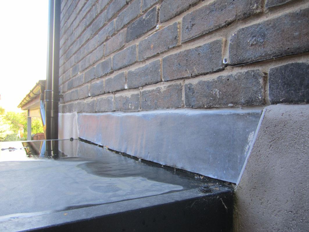

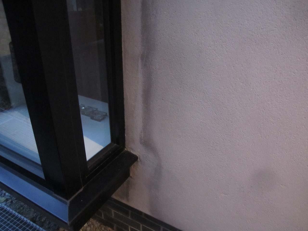

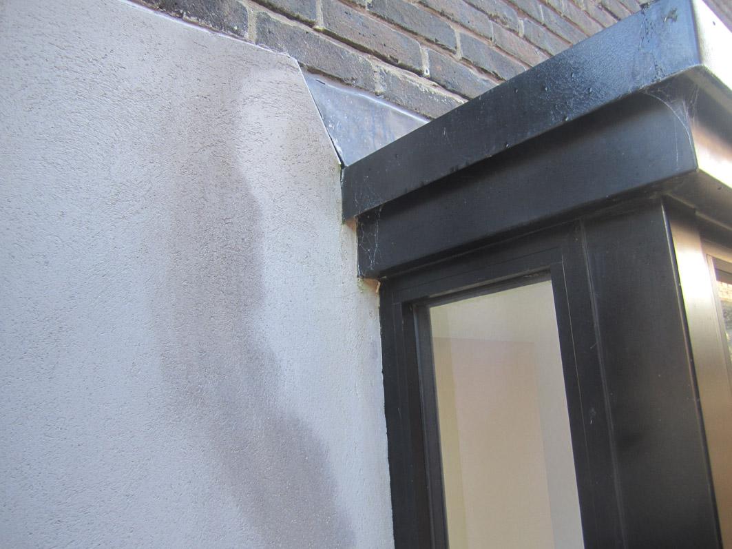

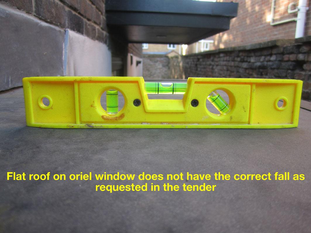

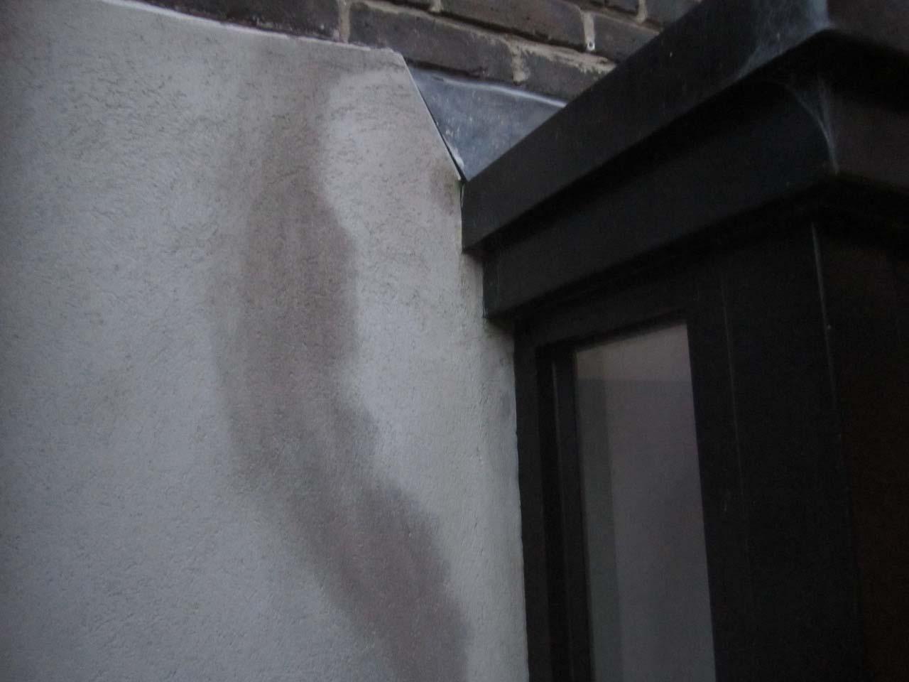

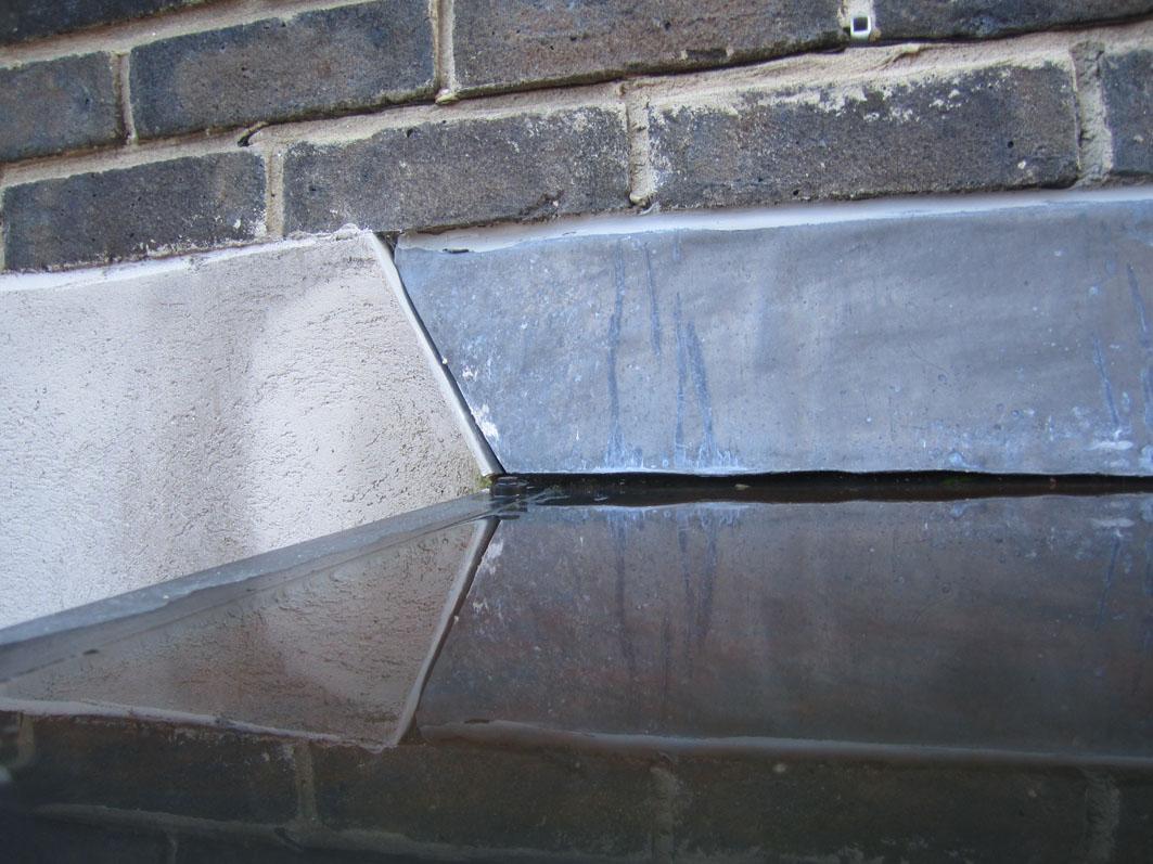

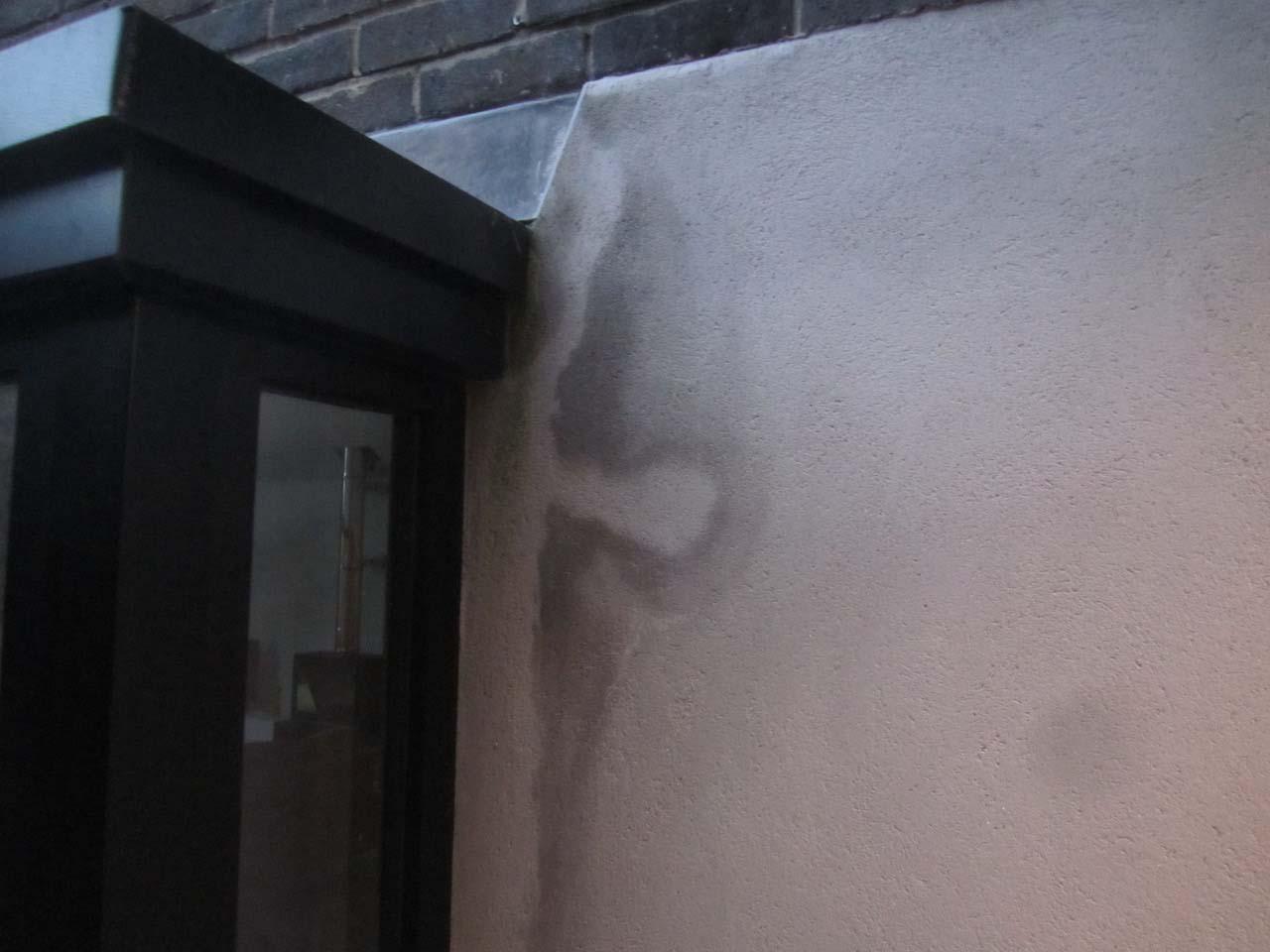

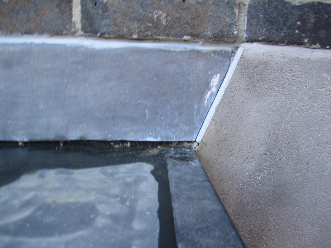

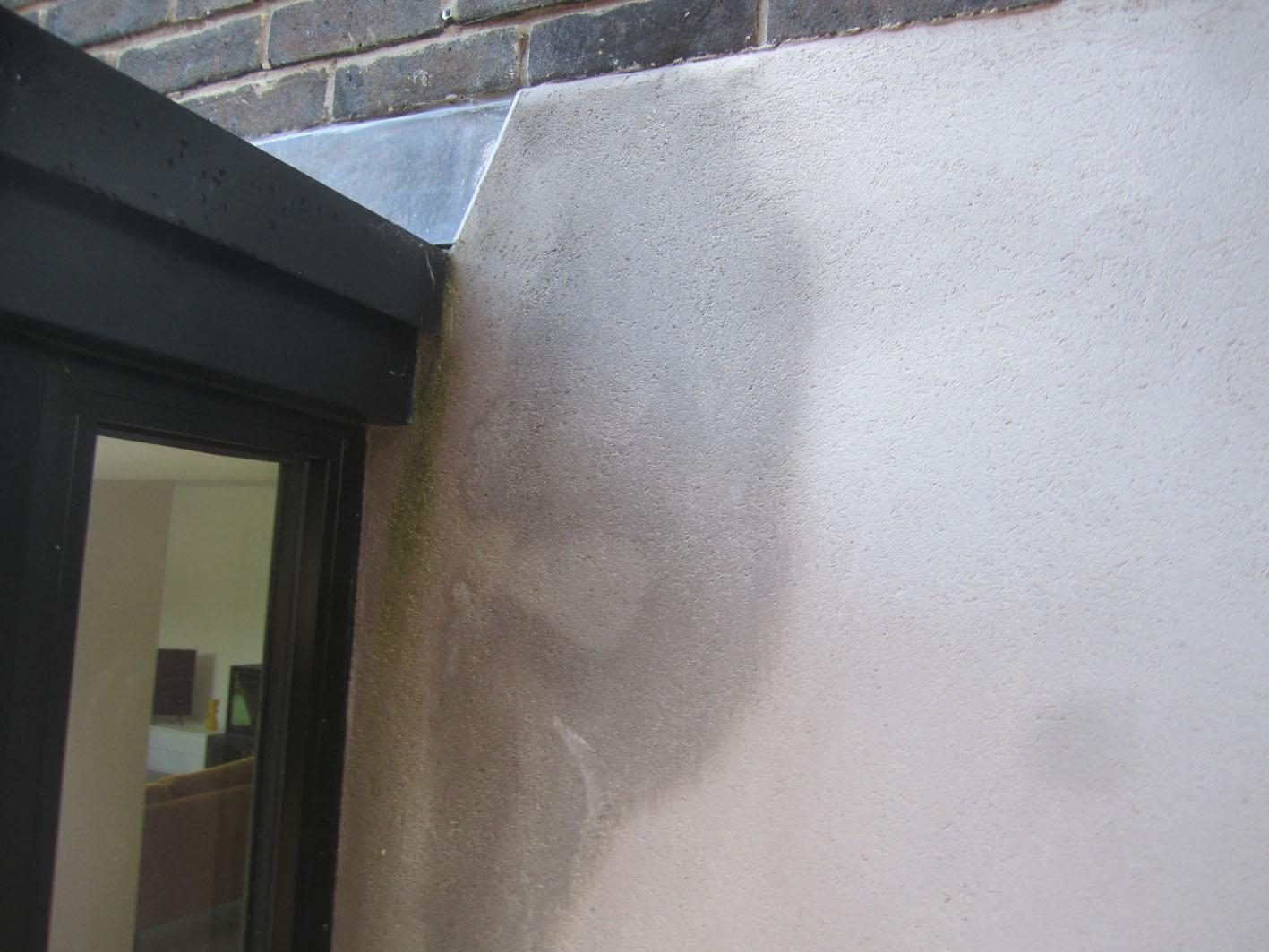

DeeCeeaitch Posted December 4, 2021 Share Posted December 4, 2021 (edited) One yEar into our new build and we have staining on the render - due to what I suspect is poor flashing. The flat roof angles towards the wall instead of away - the builder is saying there is nothing wrong with the flashing but the render is always patchy even in dry weather. - Your thoughts would be appreciated as we have reached a deadlock with the builder. Edited December 4, 2021 by DeeCeeaitch SPELLING Link to comment Share on other sites More sharing options...
joe90 Posted December 4, 2021 Share Posted December 4, 2021 That looks like damp to me, render experts will be along shortly. Link to comment Share on other sites More sharing options...
Mr Punter Posted December 4, 2021 Share Posted December 4, 2021 Poor detailing means water is soaking the render. Nothing at the top of the render to stop it and there is nowhere for the water from the roof to go. Link to comment Share on other sites More sharing options...
nod Posted December 4, 2021 Share Posted December 4, 2021 57 minutes ago, joe90 said: That looks like damp to me, render experts will be along shortly. Plus 1 Link to comment Share on other sites More sharing options...
TonyT Posted December 4, 2021 Share Posted December 4, 2021 Plus another 1 Link to comment Share on other sites More sharing options...
Dave Jones Posted December 7, 2021 Share Posted December 7, 2021 (edited) in the absence of any gutters where are you expecting the water to go ? Waterfall off front of window or dribbling down the render ? First job is to get water away from the structure as you don't want permanently soaked walls/render. Pointless worrying about any staining/damp until you have that sorted. Edited December 7, 2021 by Dave Jones Link to comment Share on other sites More sharing options...
tonyshouse Posted December 7, 2021 Share Posted December 7, 2021 Flat roof needs to slope away from the wall! Link to comment Share on other sites More sharing options...
tonyshouse Posted December 7, 2021 Share Posted December 7, 2021 I would tip the lead up, undo the fixings, lift off the roof panel, add thin ply sheet on firing pieces to give a 1:40 fall away from the house , then replace panel. Likely have to trim the upstand 1 Link to comment Share on other sites More sharing options...
Dave Jones Posted December 7, 2021 Share Posted December 7, 2021 4 hours ago, tonyshouse said: I would tip the lead up, undo the fixings, lift off the roof panel, add thin ply sheet on firing pieces to give a 1:40 fall away from the house , then replace panel. Likely have to trim the upstand so the rain would dribble down the front of the window. Better option would be to do it properly and fit a gutter and downpipe. Link to comment Share on other sites More sharing options...
tonyshouse Posted December 7, 2021 Share Posted December 7, 2021 I think that it would drip clear of the sill Link to comment Share on other sites More sharing options...
