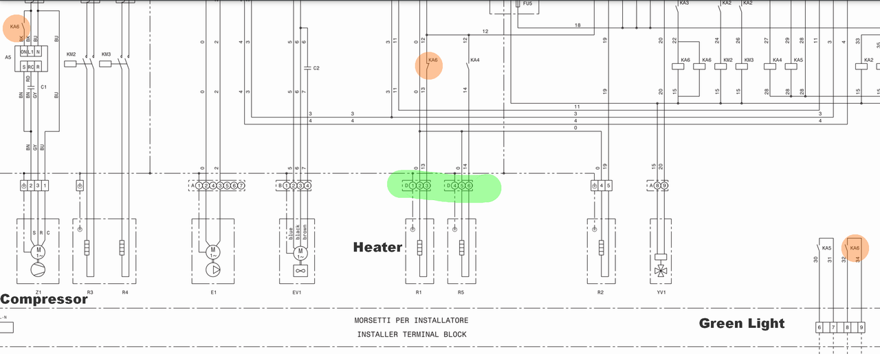

Radian Posted December 24, 2021 Posted December 24, 2021 Another KA6 shown `on the schematic powers a green light (compressor on) but it doesn't differentiate between KA6/1 or KA6/ 2. So far as I can see, three KA6 contact pairs separately switch on A5 (compressor starter), GN1 (green compressor on light) and R1 (crankcase heater) KA6/1 has been left in so that must have the compressor starter on it. KA6/2 has been removed and we know it connects the faulty heater. If the green light also comes on with the compressor then that will be on KA6/1 if not then its on KA6/1.

ProDave Posted December 24, 2021 Posted December 24, 2021 I think, according to the circuit diagram, R1 (the one we thought was the problem) and R5 share the connector "D" can you confirm that one is the one you unplugged? Looking again at the diagram, R1 is energised when the compressor is OFF presumably to keep a bit of background heat in it. We need to find what is connected to the normally open contact of KA6/1. The diagram does not help us as it does not make any distinction between KA6/1 and KA6/2 So looking for NO contacts on "KA6" one feeds the compressor, and one feeds a light that is connected via terminals 8 and 9. Can you clearly identify any of the terminal blocks as being labelled as 8 and 9? If so try removing the cables from one side of each and try again with KA6/2 plugged in? EDIT the terminals 8 an 9 I am looking for are on the "Installer terminal block" not any internal terminal block.
Radian Posted December 24, 2021 Posted December 24, 2021 (edited) @ProDave I think he's pulled out connector D - pins 1,2,3 go to R1 and 4,5,6 go to R5 It's looking like the IR breakdown is on the wiring going between KA6/2 and the mating socket D - probably the orange wire, as the R5 connections are switched by KA4 which is still in circuit without fault. Edit: crossover post missed your comment - so we're both thinking the green light? Edited December 24, 2021 by Radian

ProDave Posted December 24, 2021 Posted December 24, 2021 It's definitely that orange wire, that's why I suggested physically following it through the trunking, you might even find where it is pinched or damaged doing that. My suggestion was to eliminate the "external" wiring to the lamp as the cause. Yes I am thinking green light. If the compressor is running and it's working it can't be that. If the light is on the outside of the case, UV damage could have cracked the plastic and water got in? just a guess.
Chriswills Posted December 24, 2021 Author Posted December 24, 2021 I will check ASAP again the location of the orange wire. So.....this green light......where is it located?
Radian Posted December 24, 2021 Posted December 24, 2021 The green light is labelled as "ON compressore" I also wonder where it's located!

Radian Posted January 7, 2022 Posted January 7, 2022 No news on the "green light"? There seem to be three contacts (orange dots below) for KA6 but there are two KA6 and we don't know for sure which are feeding the circuit that trips. By unplugging connector D (green below) you've isolated the heater but it still trips so we shifted our attention to the remaining K6 circuit - the green light. This seems to be connected via the Installer terminal block but may not be fitted. However, terminals 8 & 9 in the terminal block is where its wires would go. See if you can identify any issues there.
Chriswills Posted January 7, 2022 Author Posted January 7, 2022 No I cant find the green light. Do you mean the connectors in the block 8 and 9 shown in attached? I have the KA6/2 re-fitted from this morning and is still working but maybe a fluke?
Radian Posted January 7, 2022 Posted January 7, 2022 9 minutes ago, Chriswills said: Do you mean the connectors in the block 8 and 9 shown in attached? Very likely - especially if 12/13 14/15 and 16/17 are all red link wires (can't quite see off edge of photo). If so there are no lamps connected and the mystery remains.
