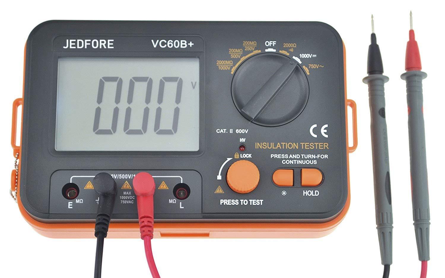

Radian Posted December 22, 2021 Posted December 22, 2021 59 minutes ago, SteamyTea said: Would it be worth putting an Ohm meter across the relay terminals and seeing what it reads. If the resistance can be established, it may indicate what sort of heating element is there. I would assume it is a fairly low powered one, 200W or something, so around 265 Ω Would be interesting I agree. However, for fault finding how about @Chriswills getting one of these OK, so it's xmas cracker grade Chinese instrumentation but £43 not £1K for a proper megger. I can vouch for the fact these usually do work well enough to predict if an RCD will trip or not.
