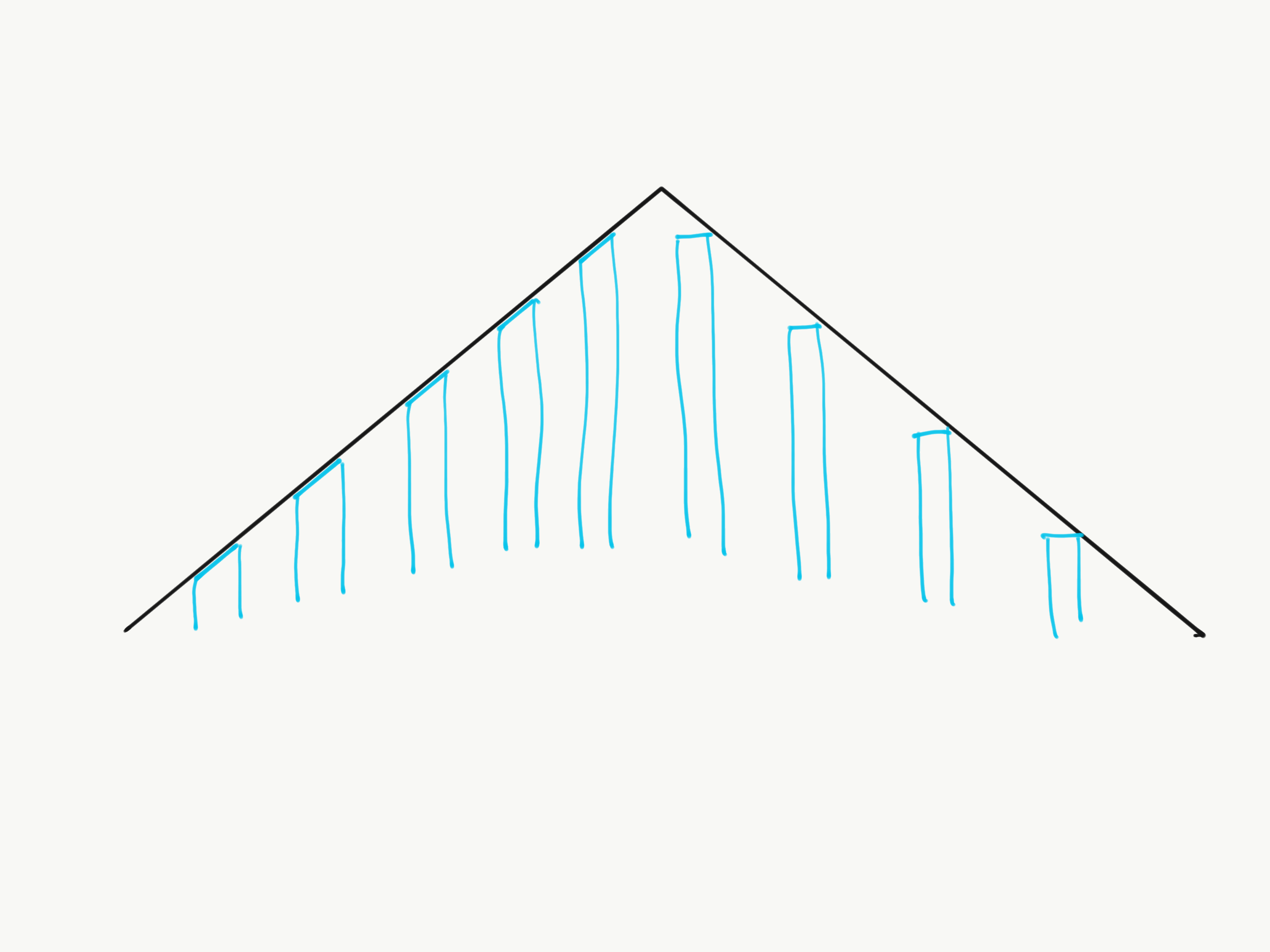

3. what do you do at gable ends. is it the done thing to cut the vertical battens to match the pitch of the roof or do you just leave them square and a little down from the top of the roof? e.g. which one of these?

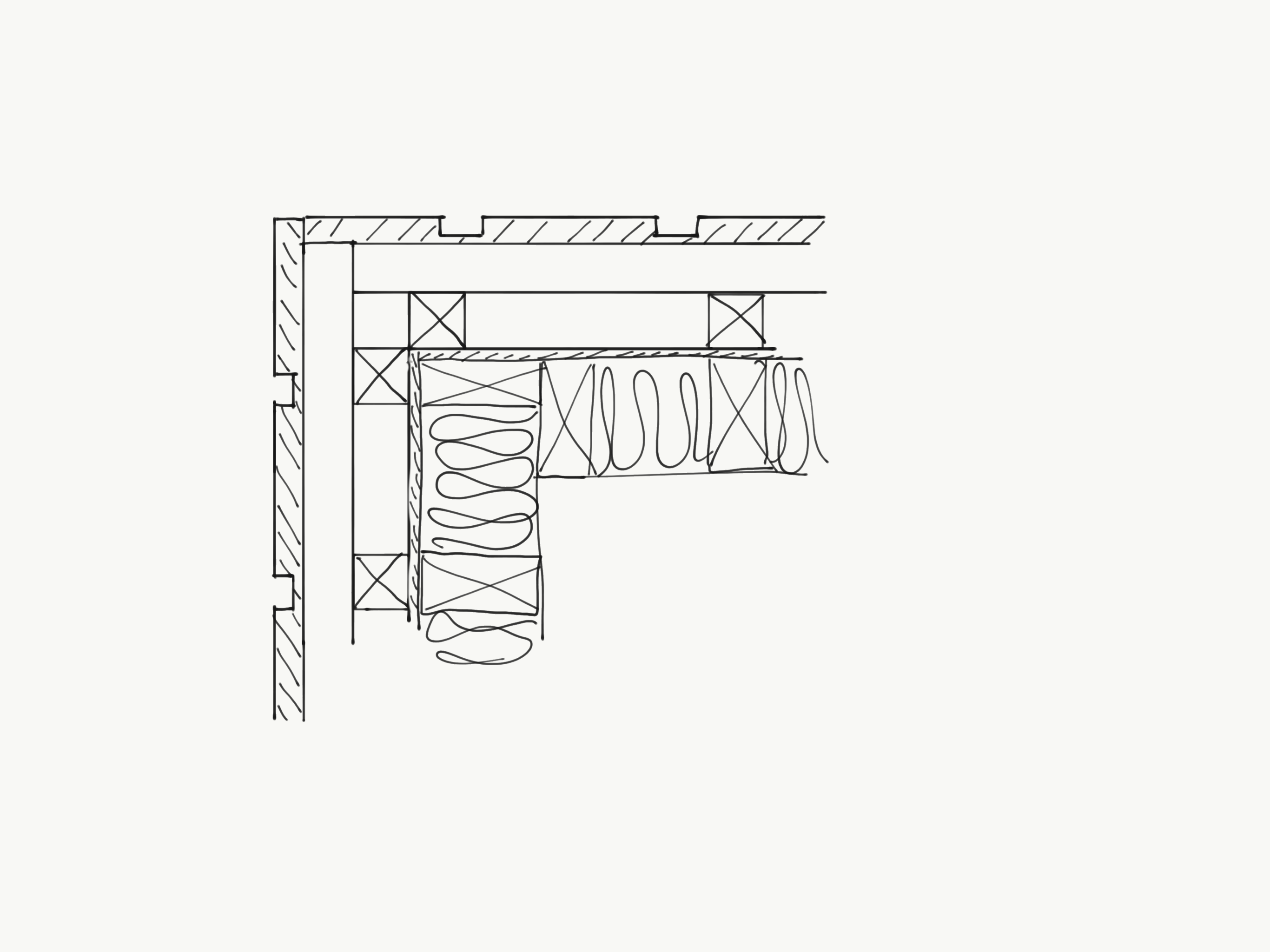

5. how do you detail around windows and doors for the battening? vertical battens in the way as the drawing in question 2 like the outside corner of a building?

3. We left them square. Under a big overhang and nobody will see them.
4. We had a diagonal batten at the same angle as the roof just below the gable, otherwise the rest were square edged.
5. It depends on the windows and also firestopping requirements. We ripped a lot of timber to size in order to get it neat.

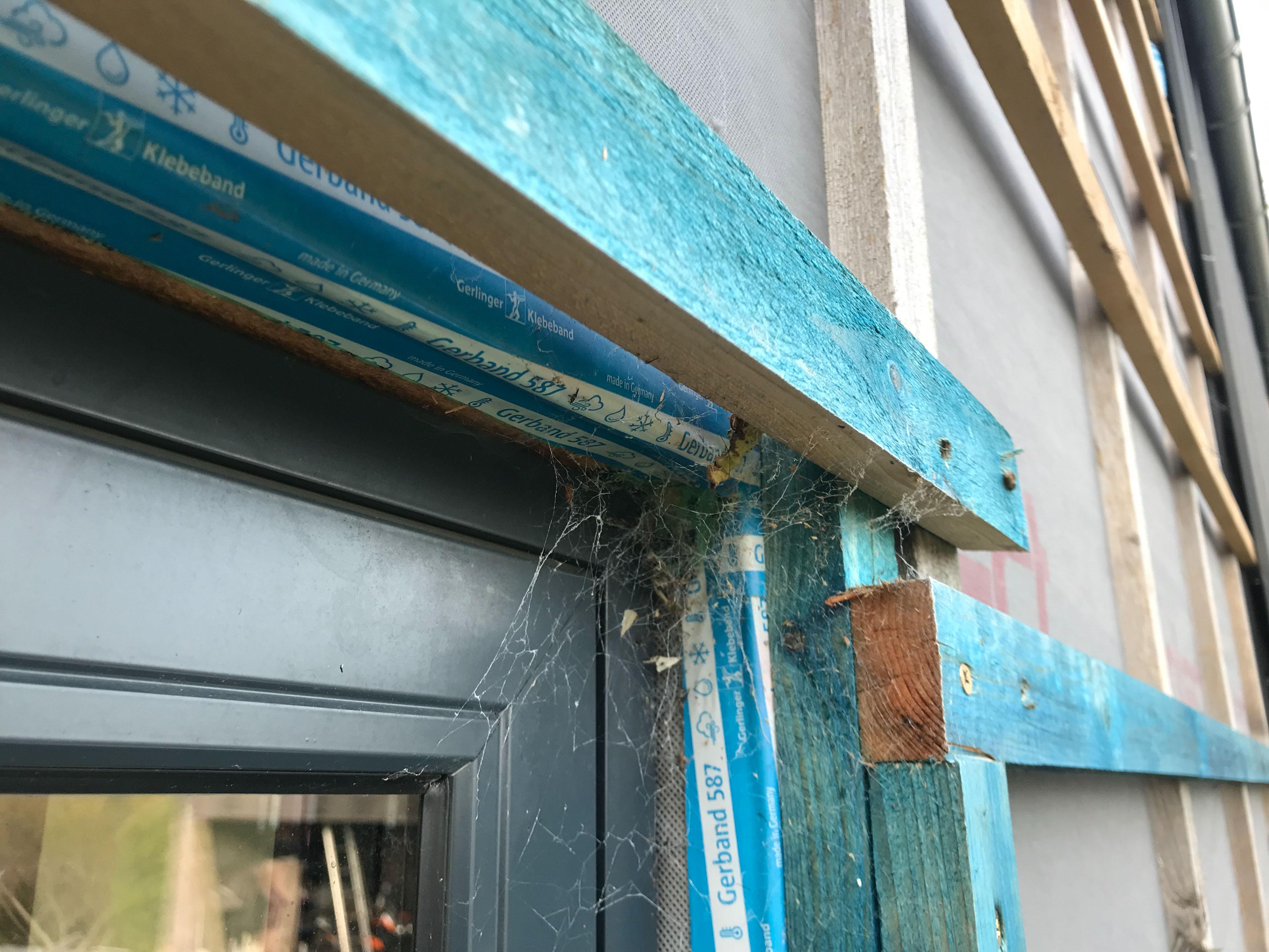

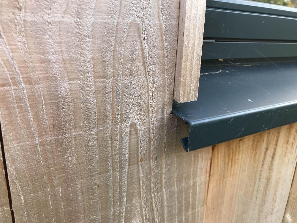

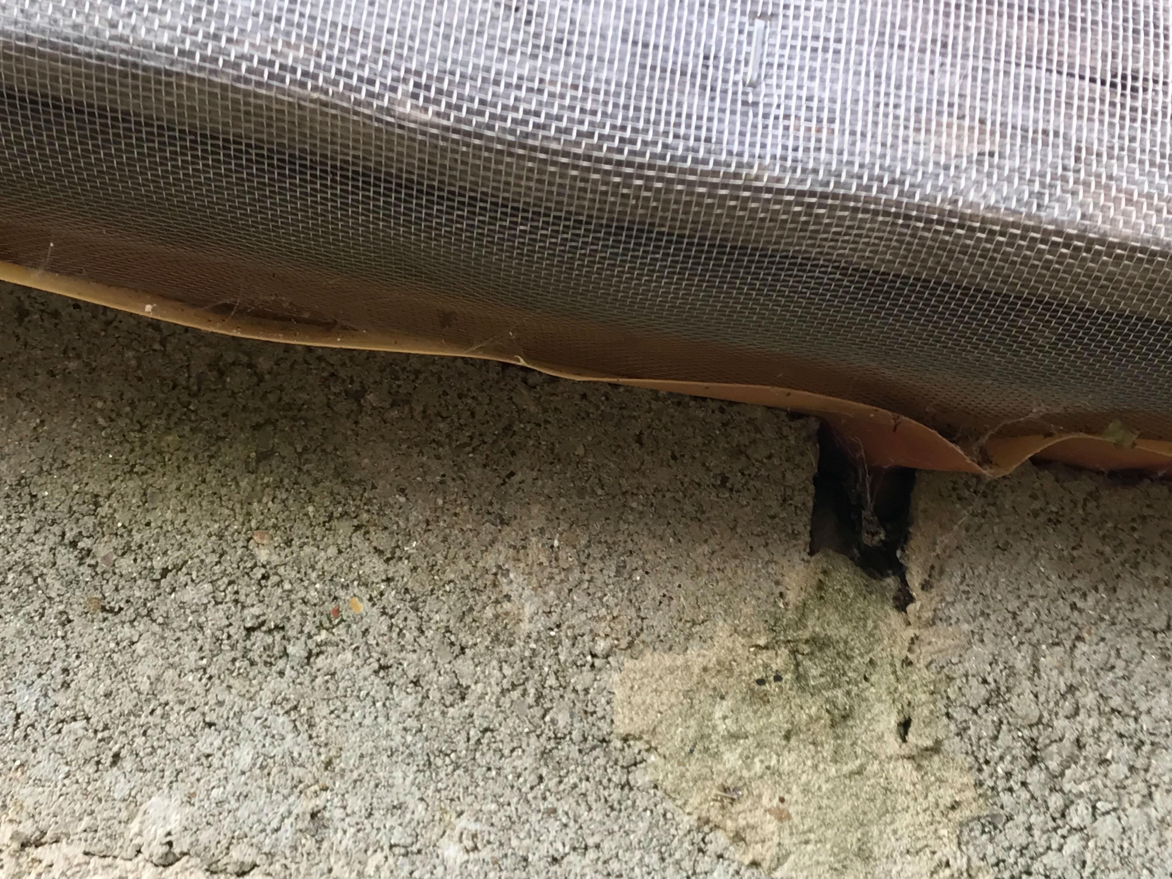

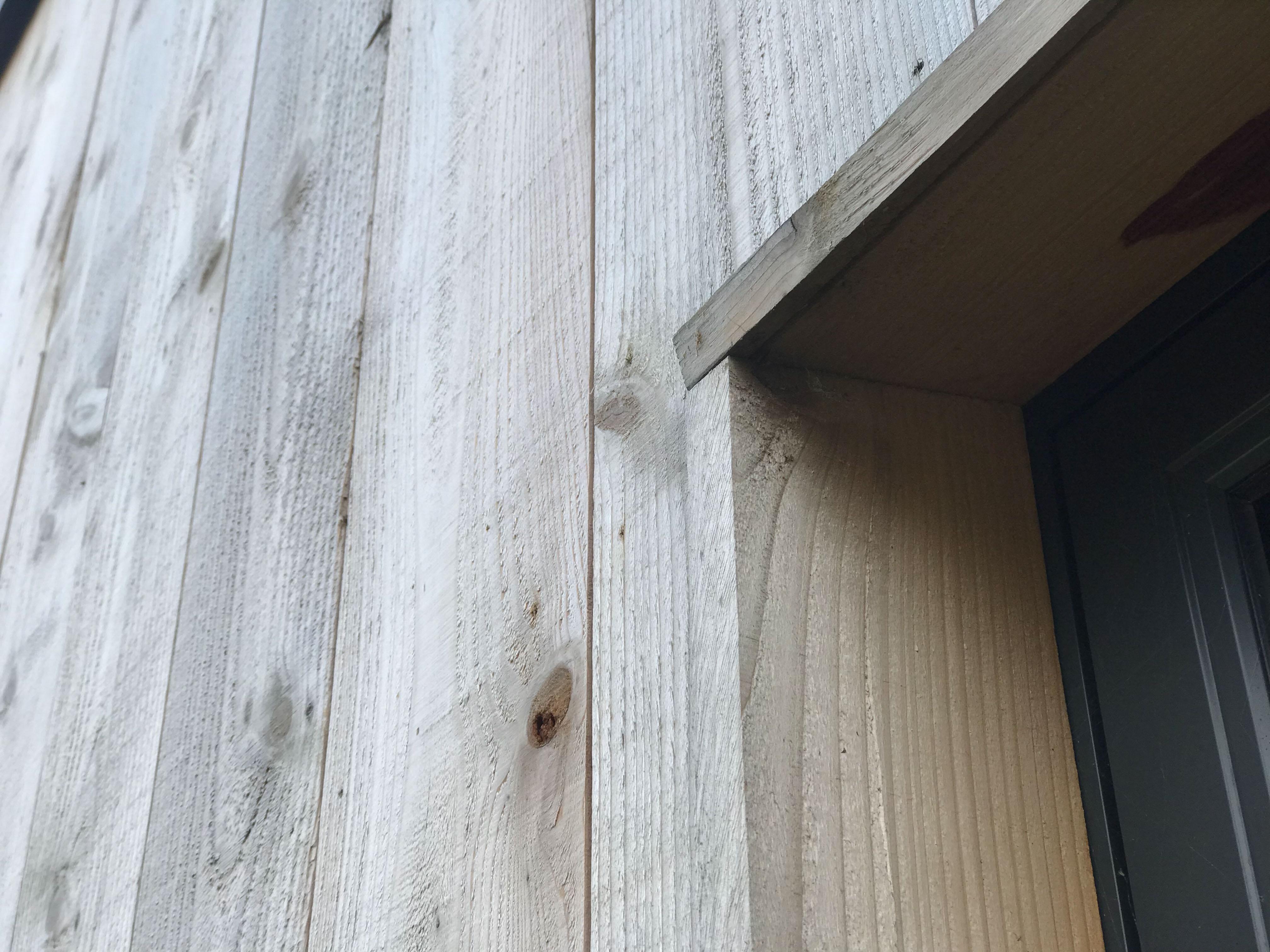

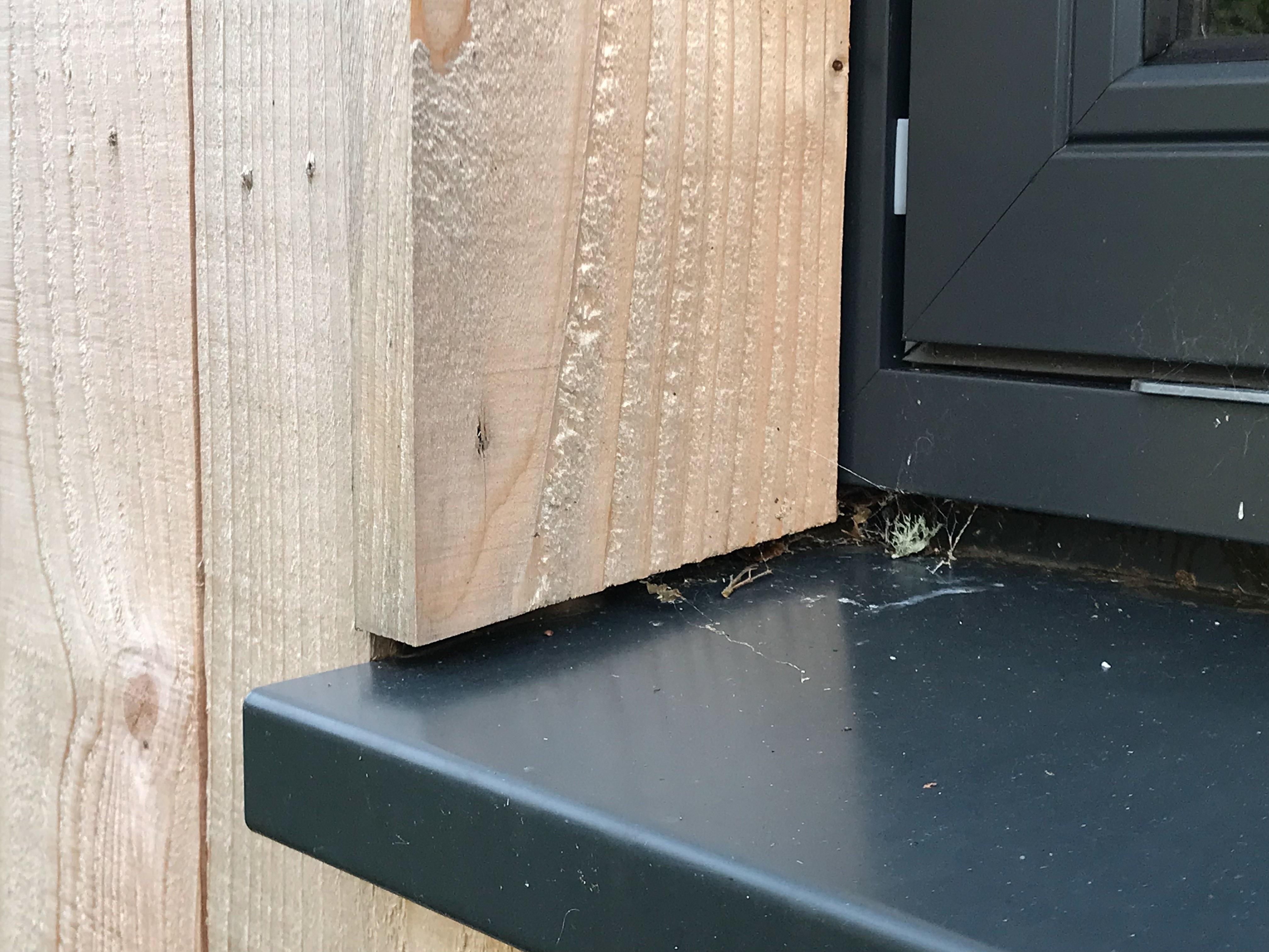

Above windows and doors you need a drain slot so if water does get behind the cladding it can drain out.
Keeping insects etc out, stainless or plastic mesh at bottom of cladding and at any drainage slots above windows and doors.
is this still necessary with the vertical battening? won't any water drain down them? or is it wise to use cambered battens so that any water hitting the horizontal battens falls rather than sits on the horizontal battens?
Page 52 on the below download link has Some details.
https://www.gov.scot/publications/timber-cladding-scotland/documents/
thanks for the link. I did have that open in a tab to read but hadn't done so yet and this is a very timely reminder! ?
we've already planned insect mesh at the bottom of the cladding. in fact one reason we decided to not use open jointed cladding and are going for shiplap tongue and groove is to negate the need for an insect mesh all over (although some say it's not necessary).

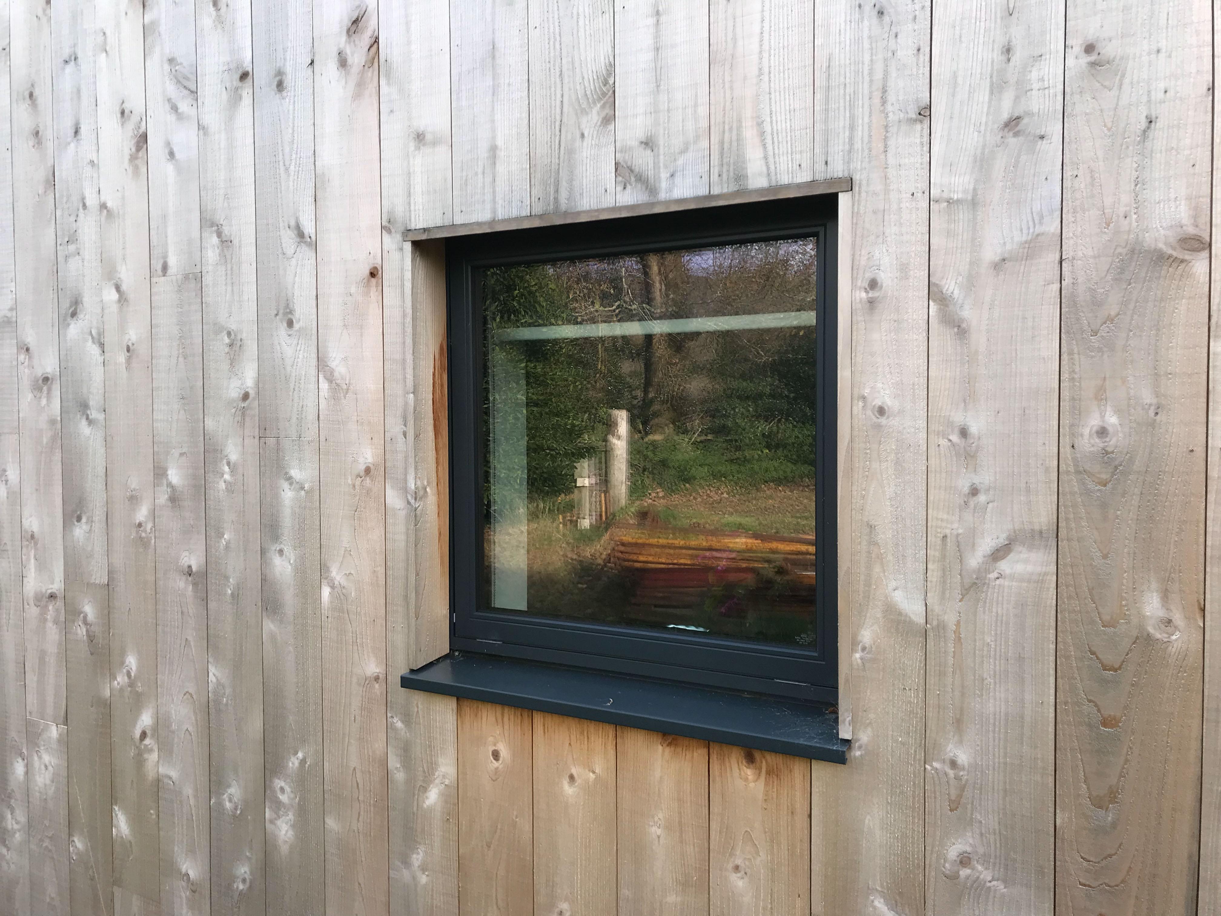

-Think through the window reveal finishes and how the cladding meets them.

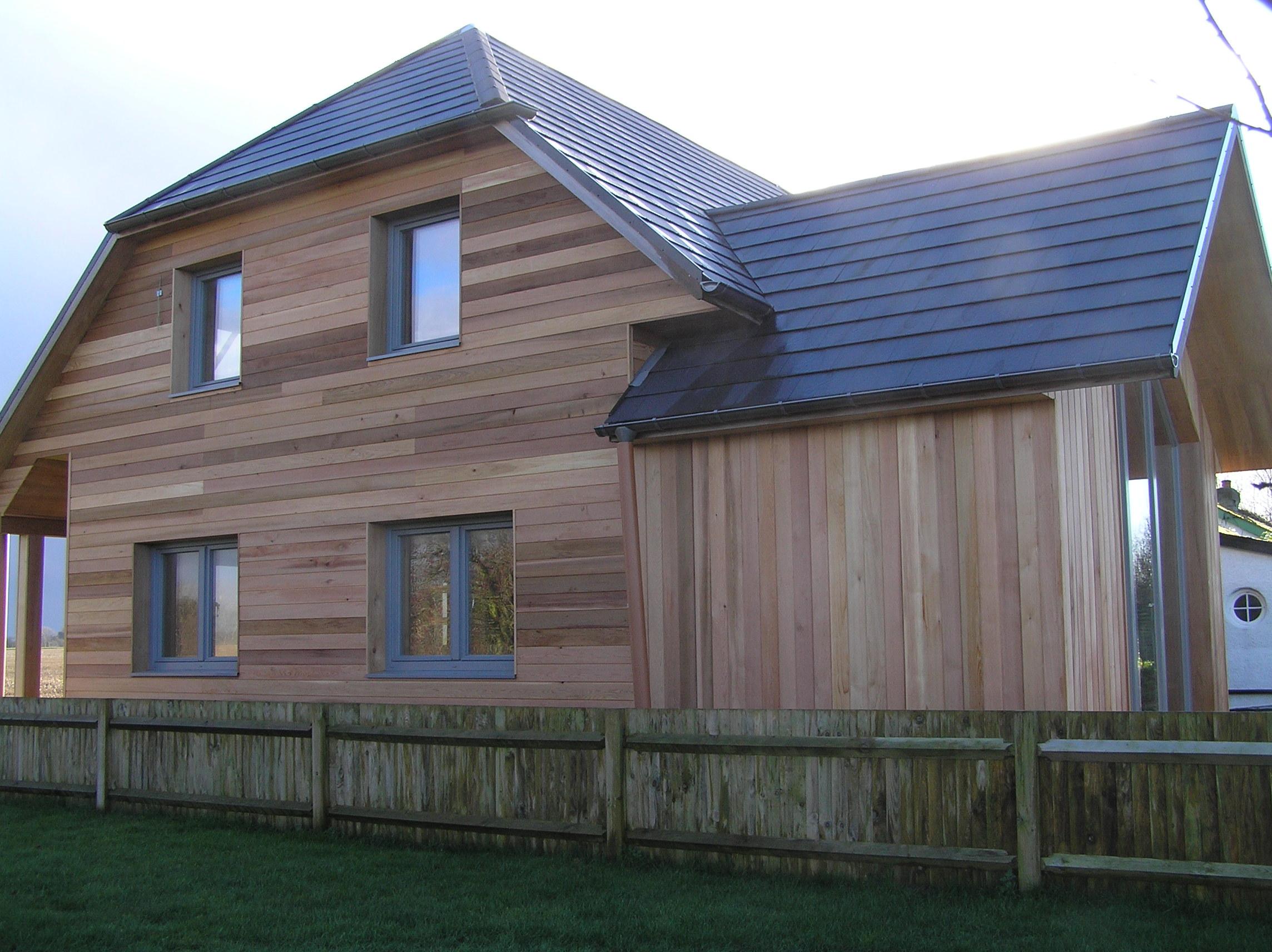

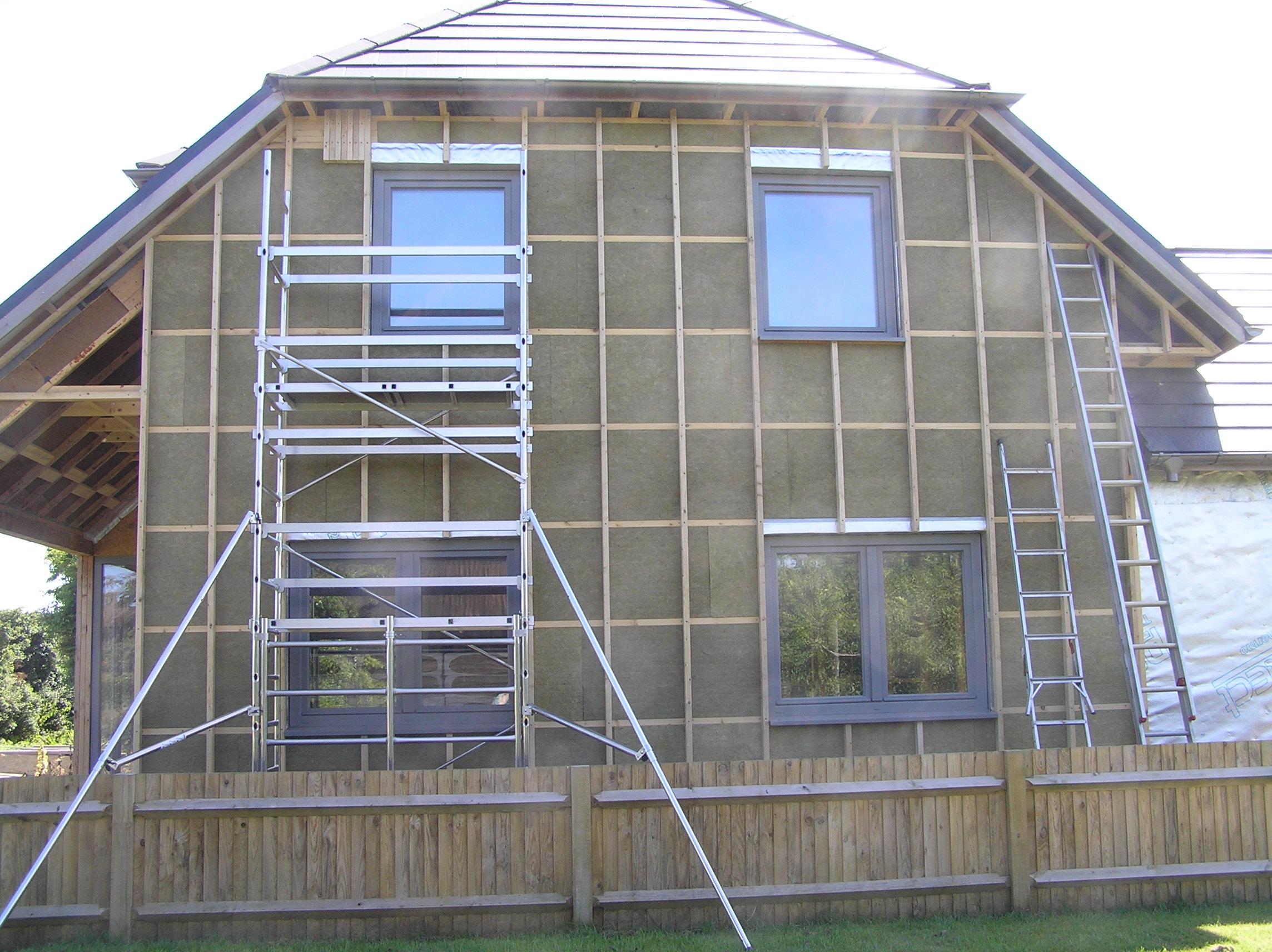

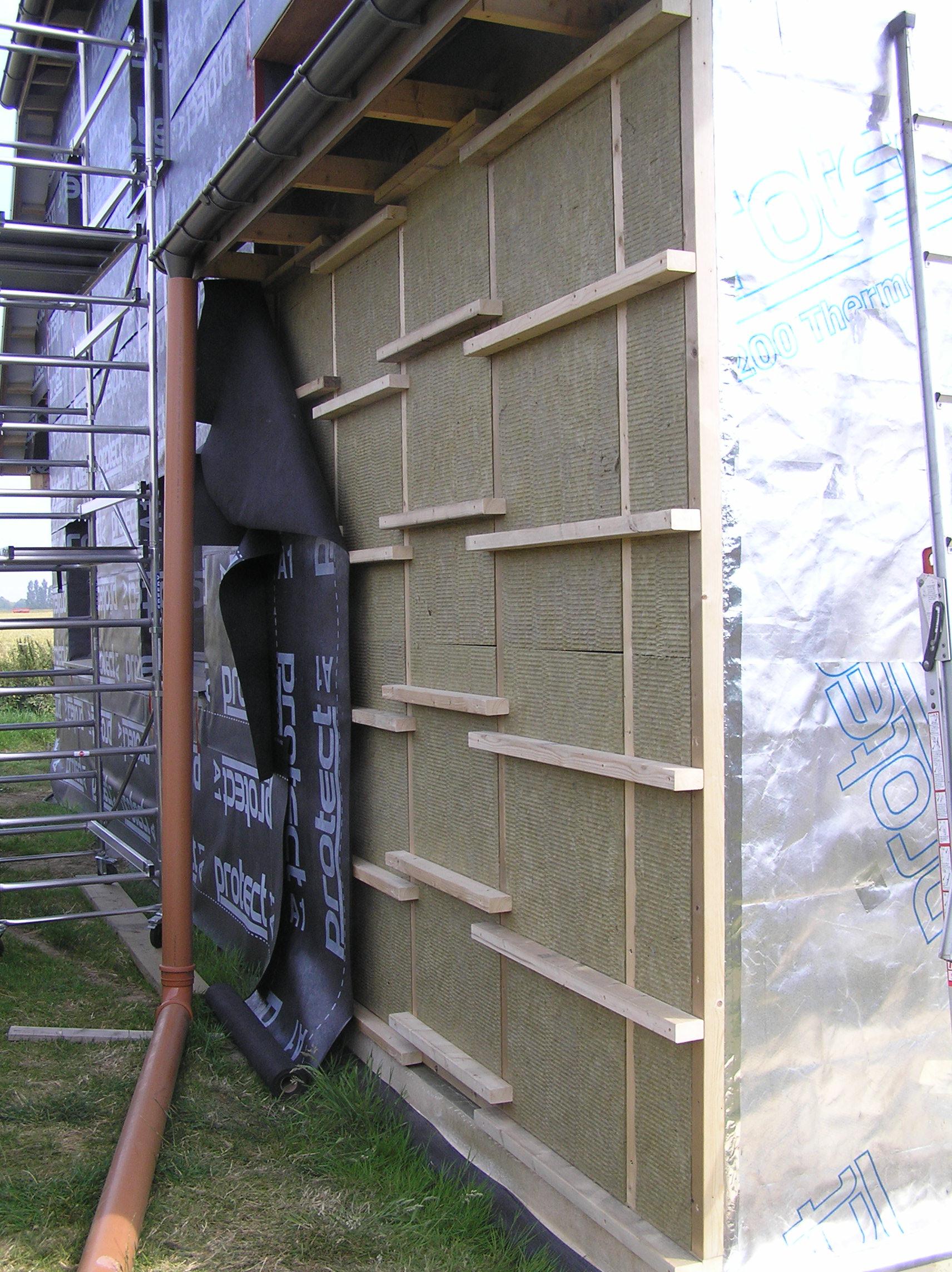

Horizontal cladding seemed straightforward with horizontal battens and vertical counter battens holding the EWI in place. For vertical cladding areas in order for air movement and possible water drainage I staggered the counter battens and had a very slight slope on them.
Edited by Gone West
thanks for the photos, they're very useful. I see the staggering of the horizontal battens, how did that affect the fixing of the vertical cladding, if at all? and when you say 'very slight slope' was that a sideways slope to drain left to right or front to back slope (which I'm struggling to think how to do unless you put packers behind the top of the batten)?
My frame had 600mm centres, underneath the membrane is 40mm Pavatherm so fixed vertical batten through to the studs. Horizontal battens at 400mm, cladding is western red cedar, about 195mm wide with a half lap. My window details took a few before I was happy. I put a 15 degree angle on the horizontal batten at the top of the window and cut a drip channel underneath the cladding. Fitted the reveals with the cill in place. Fitted some stainless steel mesh at top and bottom of batten just to keep rodents, insects out as much as possible.
great photos and information, thank you!
windows would look a lot better pulled forward rather than recessed deep into the house.
The cladding was fixed with hidden pins so the staggered battens didn't affect it. The counter battens were sloped slightly to the side so if any moisture got behind the membrane it would run off onto the lower counter batten.
They're fitted in the middle of the 400mm of insulation.

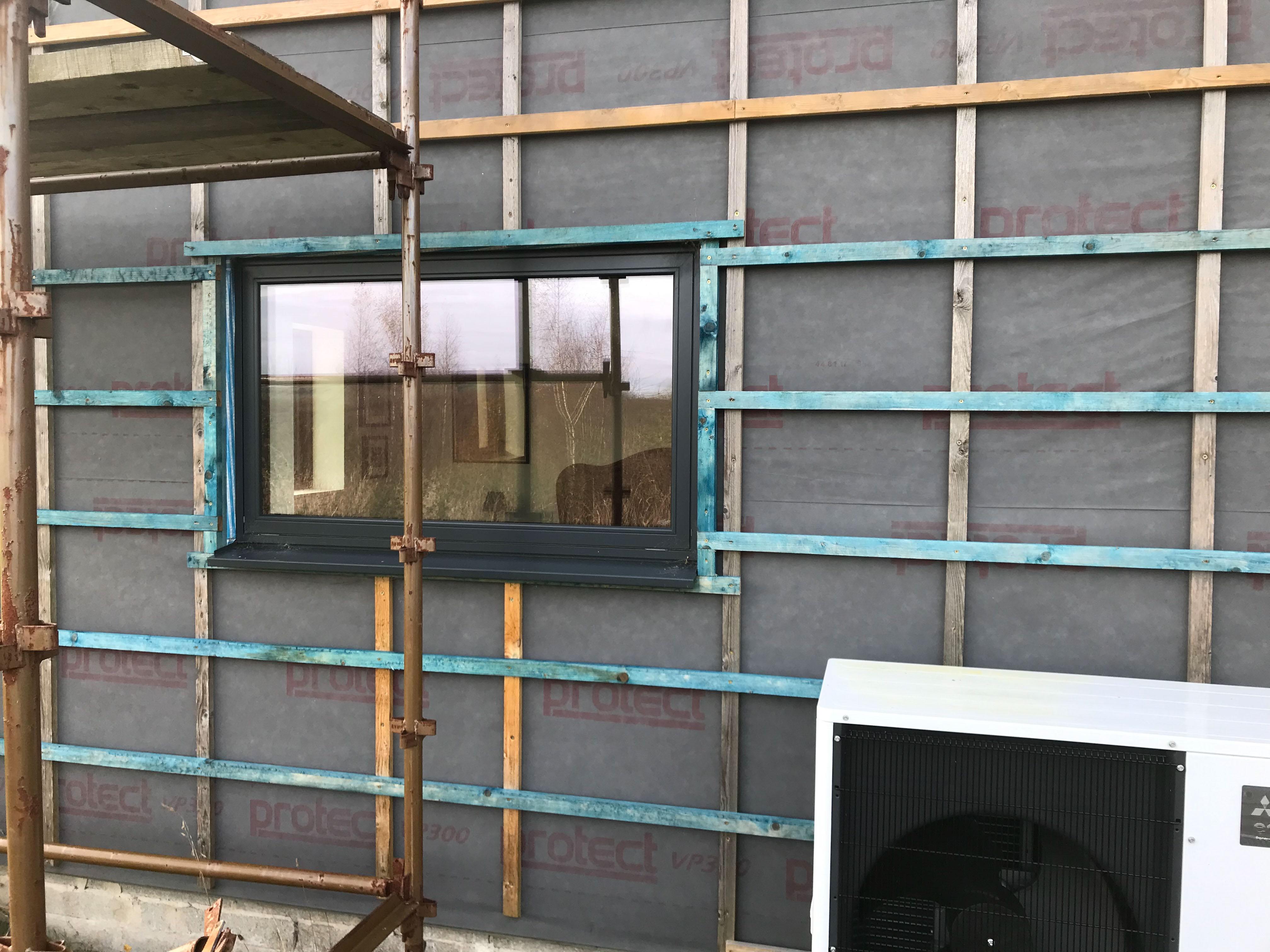

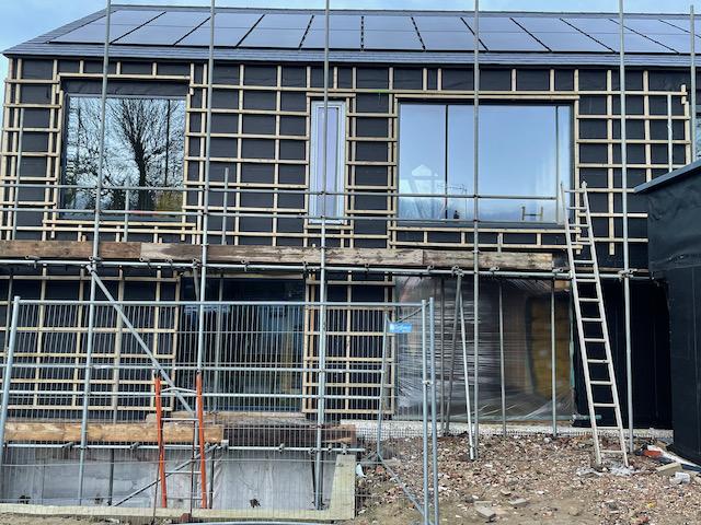

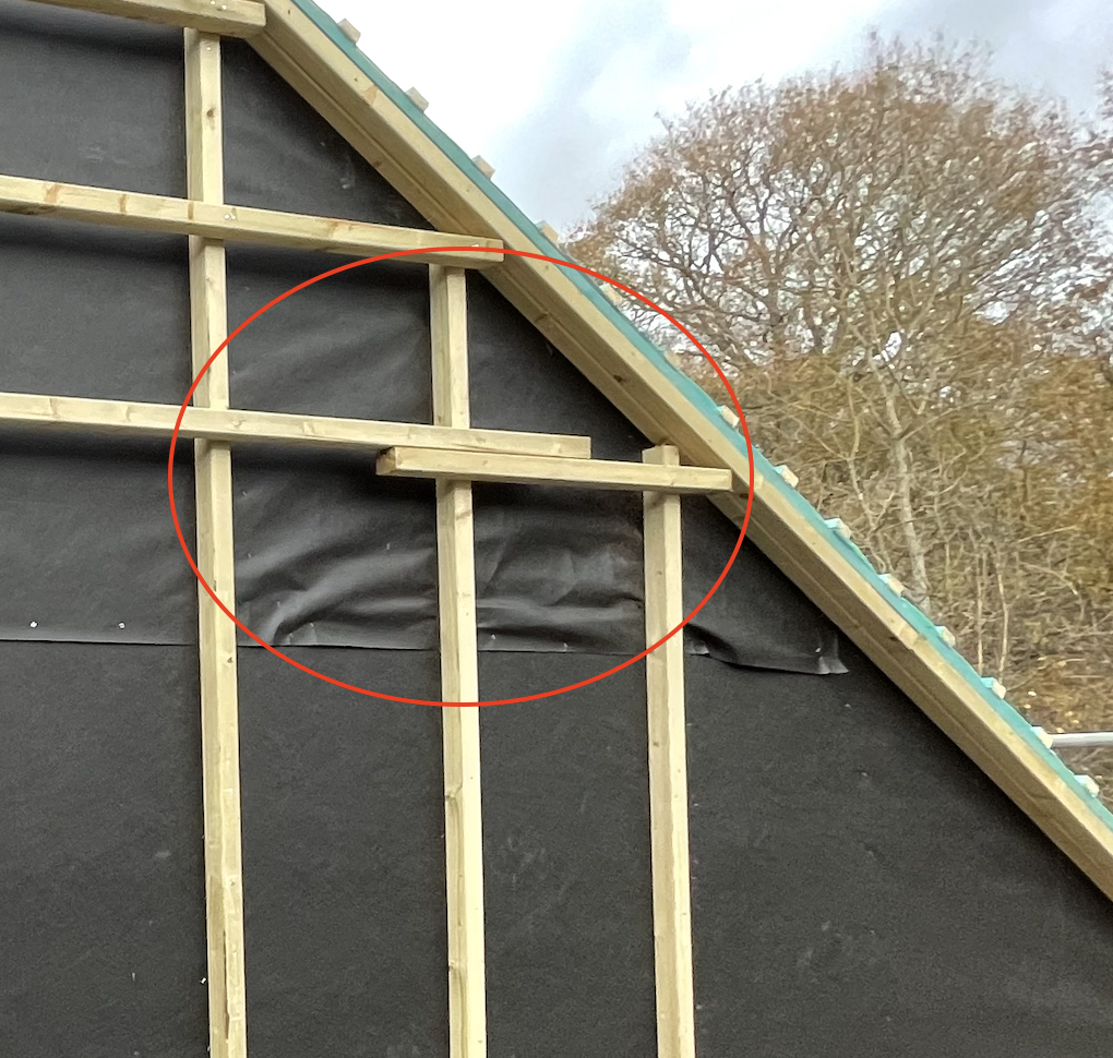

we've made a start and before we get too far I thought it prudent to post a picture so people can critique our work. I'm happy for good and bad comments! I promise I won't take it personally.
for the bit circled in red we were unsure if we should just join them half over the batten behind like @JamesP did or stagger them like @Gone West did!
2035948899_Screenshot2021-12-01at16_02_53.thumb.png.ab964836a930ca993618bbf8c1dc67d6.png
looking at it now it looks a bit 'wrong'. should we keep the run straight and sit them both joining on the same vertical?
btw, we did it like that as the battens we have aren't long enough to do that entire width.
Edited by Thorfun
I don't think it makes much difference if you've got airflow behind the counter battens. The only reason we staggered them was because the counter battens held the insulation against the racking.
It might not matter much for that little bit in the eaves, but in anywhere more prominent would the eye not be drawn to the nail line looking a bit wonky?

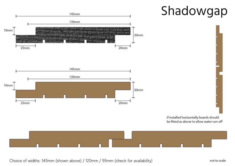

we thought that but we're planning on having hidden fixing shiplap cladding so hopefully none of the fixings will be seen!Shadowgap-Profile.jpg.7d781d424e6e3c59191be47a30ef2c83.jpg
Edited by Thorfun
added image of shadow gap profile
Hi there, I would cut the horizontals short to meet the closest vertical ( cover half the vertical and half again with the next piece). You have enough timber in the example above.
I would also start at the bottom with some batten (400mm / 600mm) spaces to hold the horizontals in place for fixing.
was discussing this all with the wife and we've come to the same conclusion. we'll do this from now on even though we're planning on having hidden fixings it's not too much effort to do it this way just in case we don't get the hidden fixings
I'm sorry but I don't actually understand what you mean here! I am special sometimes so please forgive me but can you explain this a bit more?
My poor explanation probably, I used some cut batten spacers, 355mm in. my case for 400mm centres.  Once I start with the first horizontal at the bottom I place the spaces on top vertically and put the next horizontal on top of the batten and then fix. I built most of the house myself so needed a way to support longer lengths of batten. I still measured and levelled to keep it all horizontal.
Hope that makes sense.
ahhh, yes that makes perfect sense thank you. I have my wife out with me assisting but once she gets bored and I'm out doing it on my own this is a great tip! ?

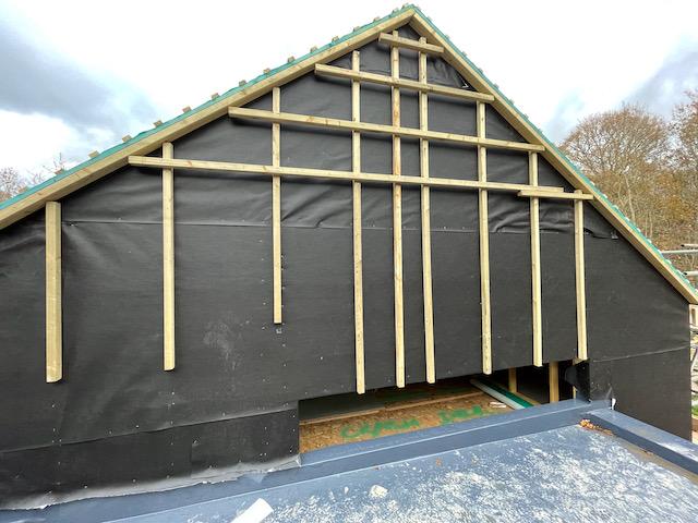

just as a quick update here's a photo of some more of our battening.
again, comments and criticisms are very welcome. it might be too late for me but for others reading at a later date my mistakes might stop them from making the same!
also wanted to thanks @JamesP again for the spacer tip. it makes it so much easier and it my number one top tip received for battening. ?

Just make sure you seal everything (ventilation gaps etc) really well with stainless steel mesh to keep rodents and wasps out. Wasps will find the smallest gap.
