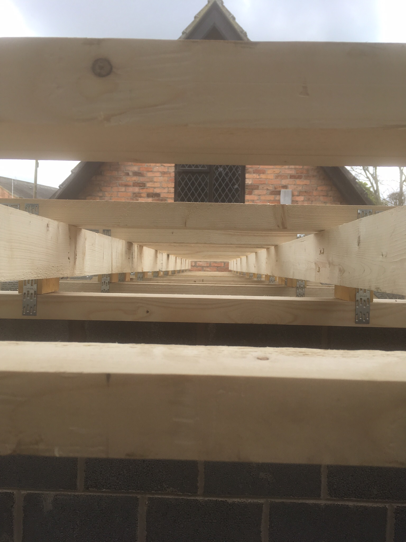

PeterW Posted April 16, 2017 Author Share Posted April 16, 2017 Yep thats the one @MikeSharp01..! Also set them so we can use one as an edge noggin on at least one room - issue is we have 2 load bearing block walls coming up through the floor so it's been a bit fun..! Didn't realise either that the posi-joists would be 95mm wide ..! Nice thing was that there is a "service run" right down the middle of the house ..! Link to comment Share on other sites More sharing options...
