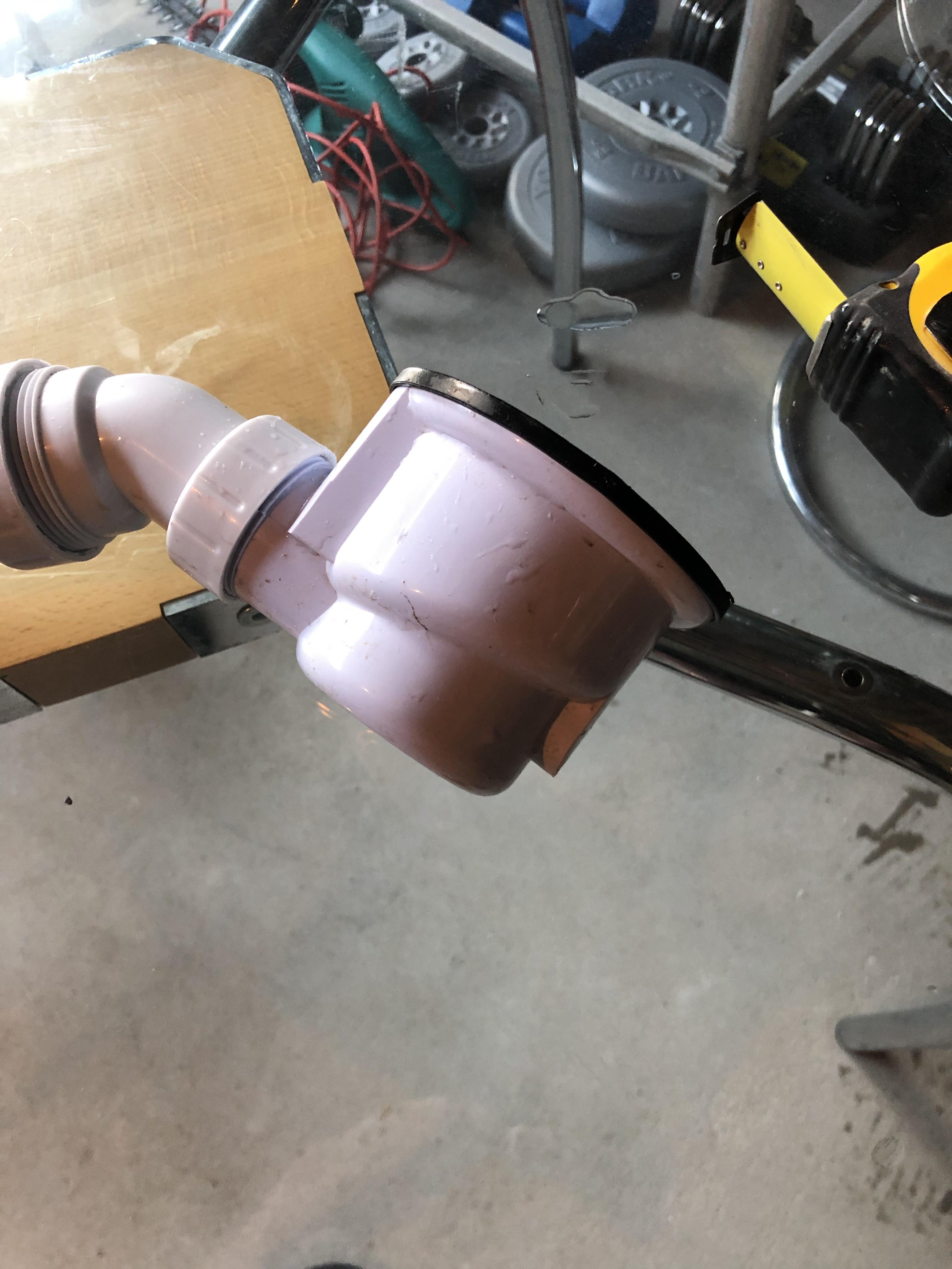

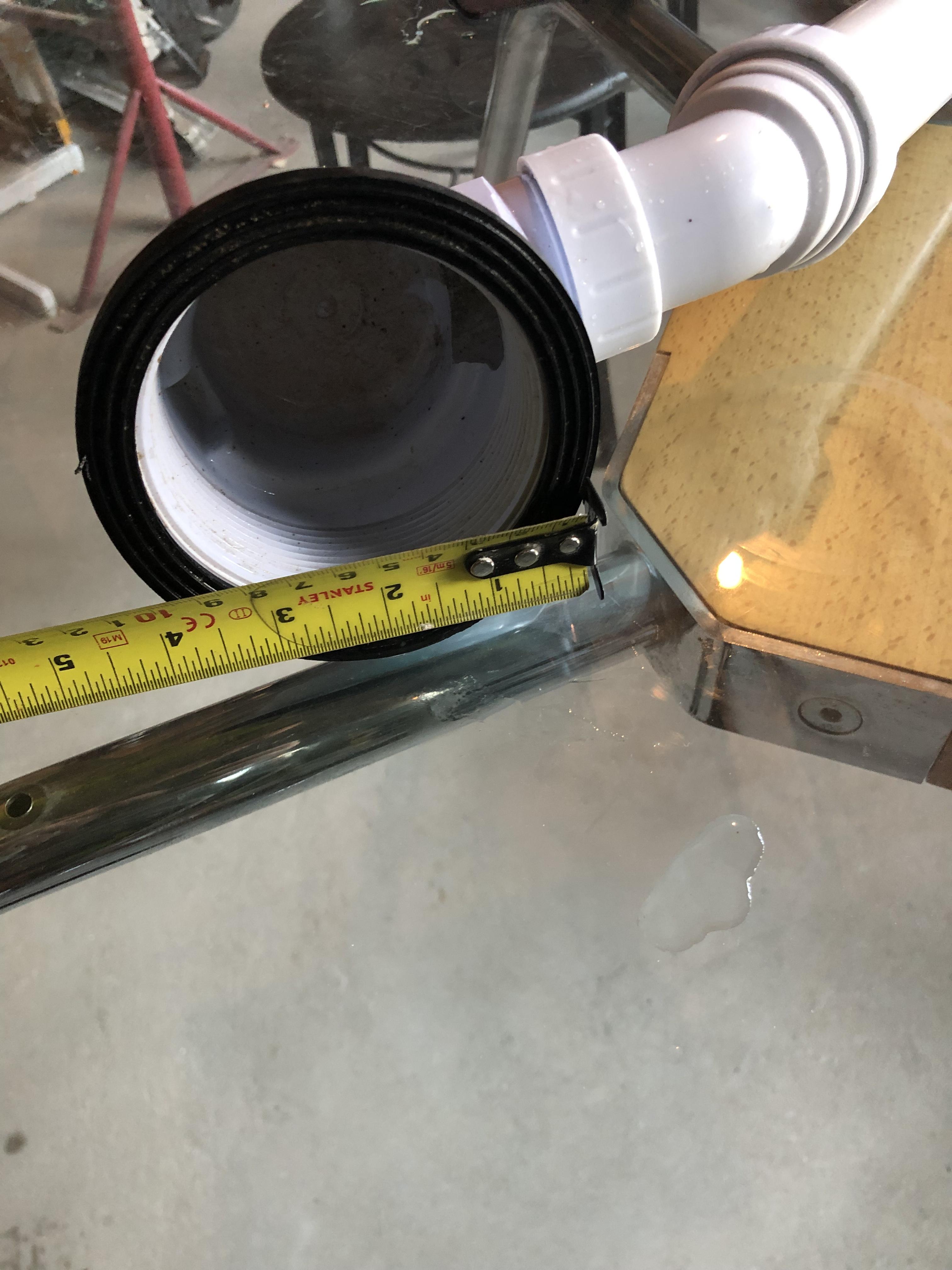

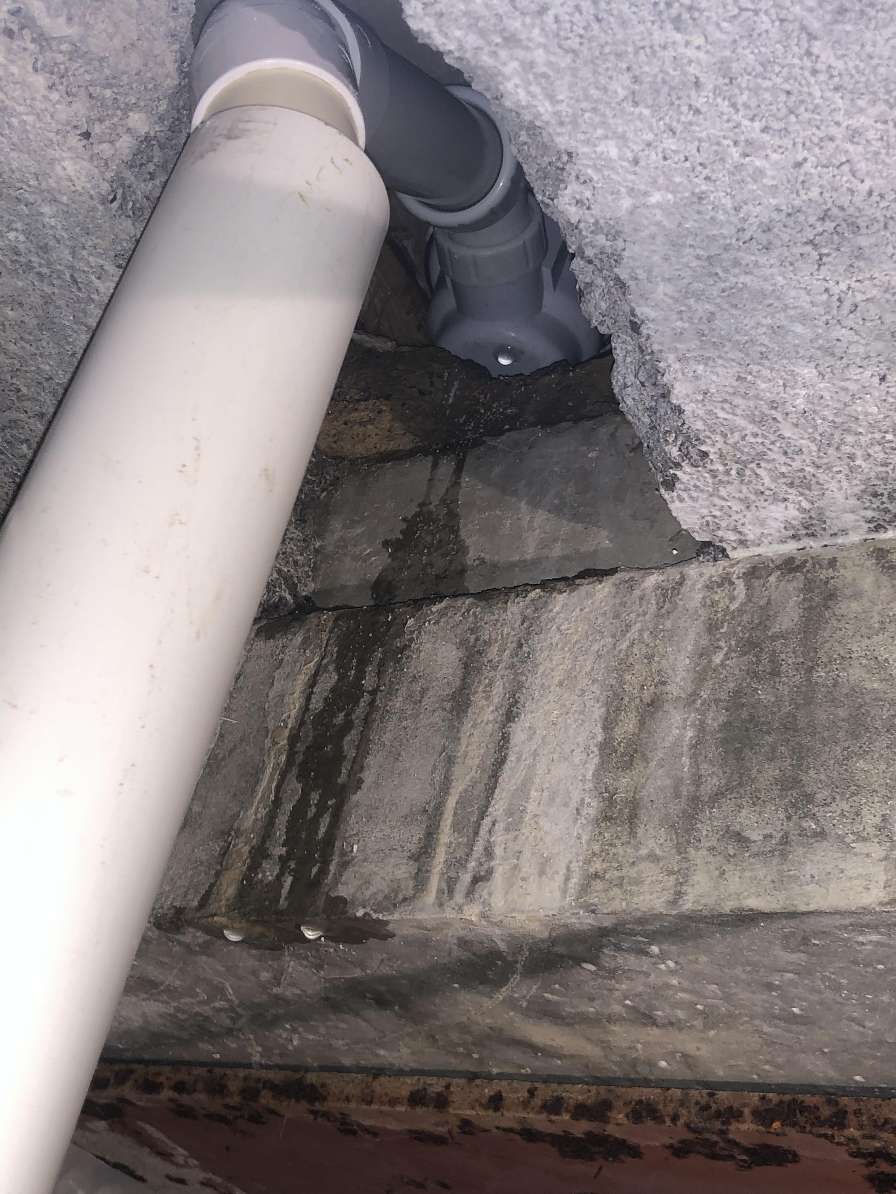

Pocster Posted November 25, 2021 Posted November 25, 2021 (edited) I have a leak from the ensuite waste . Tested this ages ago all fine . SWMBO has a shower - slight leak . I manage to tighten the trap half a turn - leaks even more !! Can’t see anything obvious. Trap seems good , rubber seal seems good . Underside of tray hole is a bit tight to that timber - but as you can see in photo’s it’s not catching in . Is there perhaps a different / better trap I can use ??? Edited November 25, 2021 by pocster

markc Posted November 25, 2021 Posted November 25, 2021 (edited) I reckon it’s the dimples on underside of tray, add a thick bead of silicon and put back in. yes the seal should work from above but I had a similar problem with my cast stone tray, Edited November 25, 2021 by markc 1
PeterW Posted November 25, 2021 Posted November 25, 2021 CT1 - thin bead between the seal and the trap, same between seal and tray then do it up and leave 24 hours. 3
Pocster Posted November 25, 2021 Author Posted November 25, 2021 11 minutes ago, PeterW said: CT1 - thin bead between the seal and the trap, same between seal and tray then do it up and leave 24 hours. I’m just worried if I do that and it still leaks I’ll never get it out .( between seal and tray I mean )
Pocster Posted November 25, 2021 Author Posted November 25, 2021 18 minutes ago, joe90 said: Is the base of the tray flat?, any “bumps” Flat - can feel round the edge from above
Nickfromwales Posted November 25, 2021 Posted November 25, 2021 25 minutes ago, pocster said: I’m just worried if I do that and it still leaks I’ll never get it out .( between seal and tray I mean ) Do as your told. ? 2

Onoff Posted November 25, 2021 Posted November 25, 2021 I used white SikaFlex EBT on my bath waste and binned the washers it came with.

Pocster Posted November 25, 2021 Author Posted November 25, 2021 1 hour ago, Nickfromwales said: Yes you will. Ok - you’re the boss !. Think I’ll ct1 the rubber ring to the fitting first and let that set
PeterW Posted November 25, 2021 Posted November 25, 2021 17 minutes ago, pocster said: Ok - you’re the boss !. Think I’ll ct1 the rubber ring to the fitting first and let that set don’t do that please, do as you’re told and don’t question it. 1
Nickfromwales Posted November 25, 2021 Posted November 25, 2021 31 minutes ago, pocster said: Ok - you’re the boss !. Think I’ll ct1 the rubber ring to the fitting first and let that set 14 minutes ago, PeterW said: don’t do that please, do as you’re told and don’t question it. This is his last warning before we move to DEFCON 5. ?. Put it all together in the same wet sealant session. Resistance is futile.
Pocster Posted November 25, 2021 Author Posted November 25, 2021 21 minutes ago, PeterW said: don’t do that please, do as you’re told and don’t question it. But you said to do that “ CT1 - thin bead between the seal and the trap, same between seal and tray then do it up and leave 24 hours“ I thought it would be better to stick seal to trap ( let it set ; also can’t move ) then silicone whole lot to tray …

PeterW Posted November 25, 2021 Posted November 25, 2021 8 minutes ago, pocster said: But you said to do that “ CT1 - thin bead between the seal and the trap, same between seal and tray then do it up and leave 24 hours“ I thought it would be better to stick seal to trap ( let it set ; also can’t move ) then silicone whole lot to tray … Do it all in one operation - that ensures that the imperfections between the tray and the seal, and the seal and the waste are all accounted for when it tightens. If you do one first, you will potentially glue the seal off centre and then end up with the seal not parallel to the flanges and it will leak. 1

Pocster Posted November 26, 2021 Author Posted November 26, 2021 Wasn’t brave enough to ct1 it so used silicone . Between trap and rubber ring then between ring and tray . Will test tomorrow ?

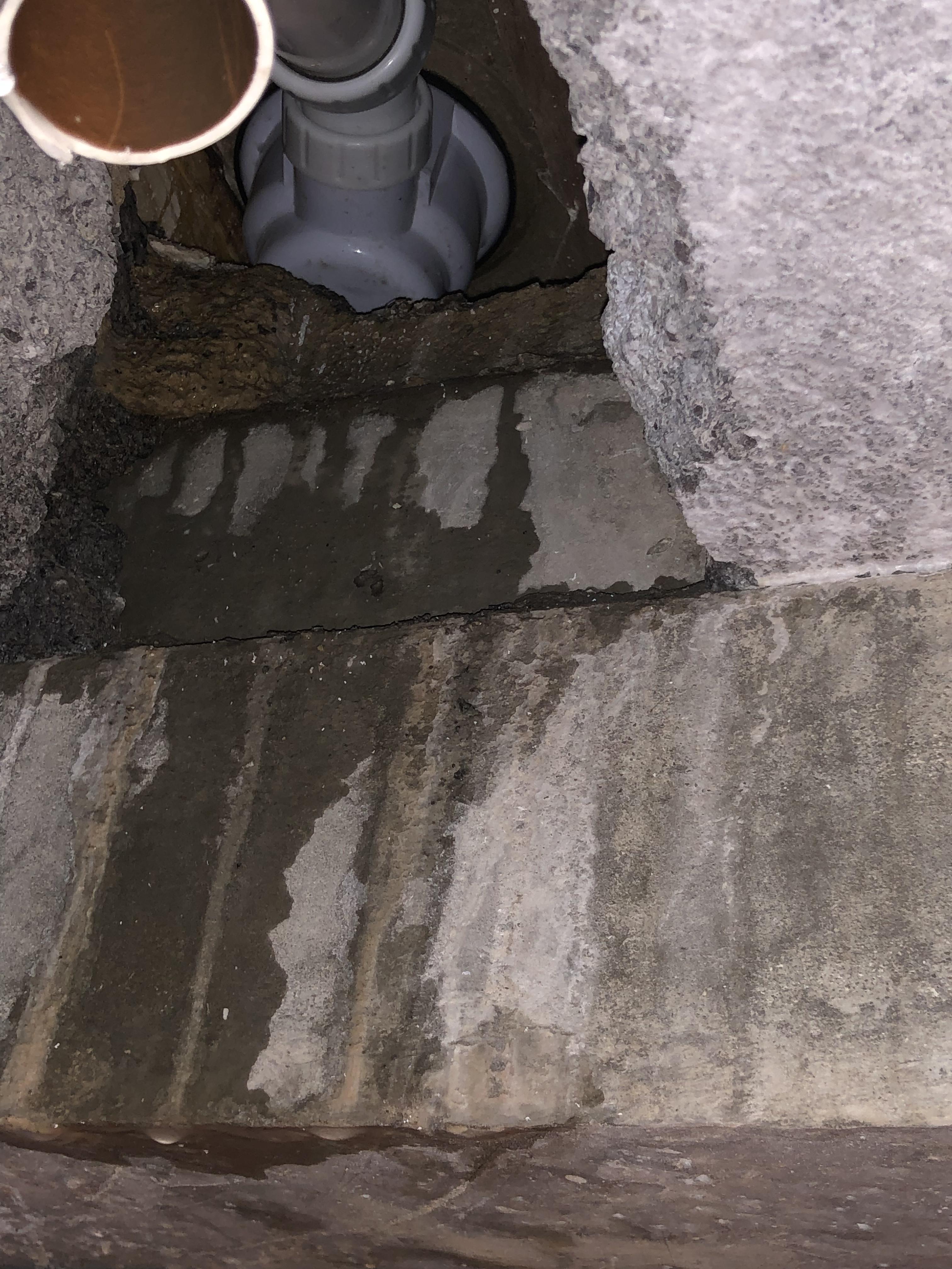

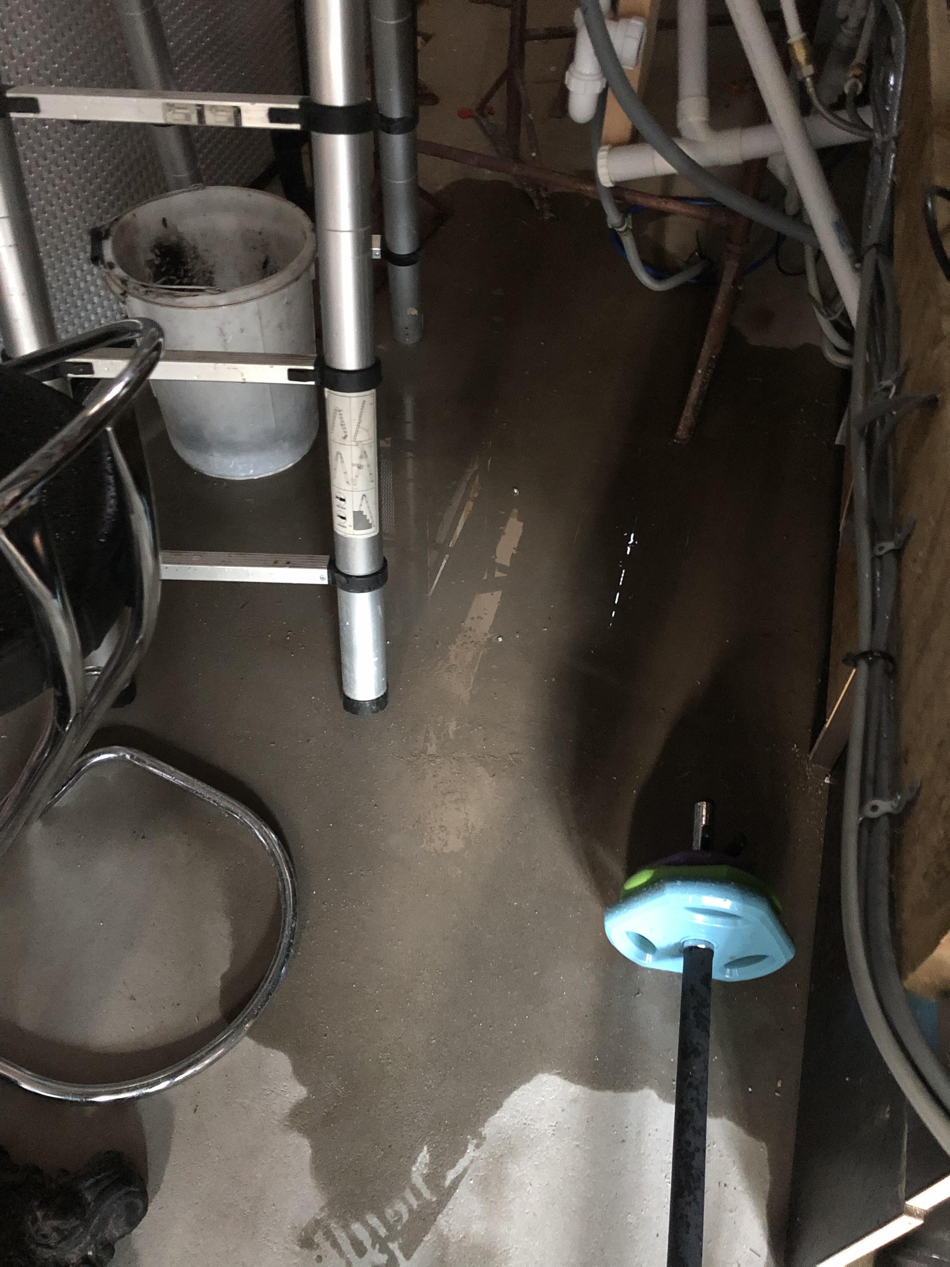

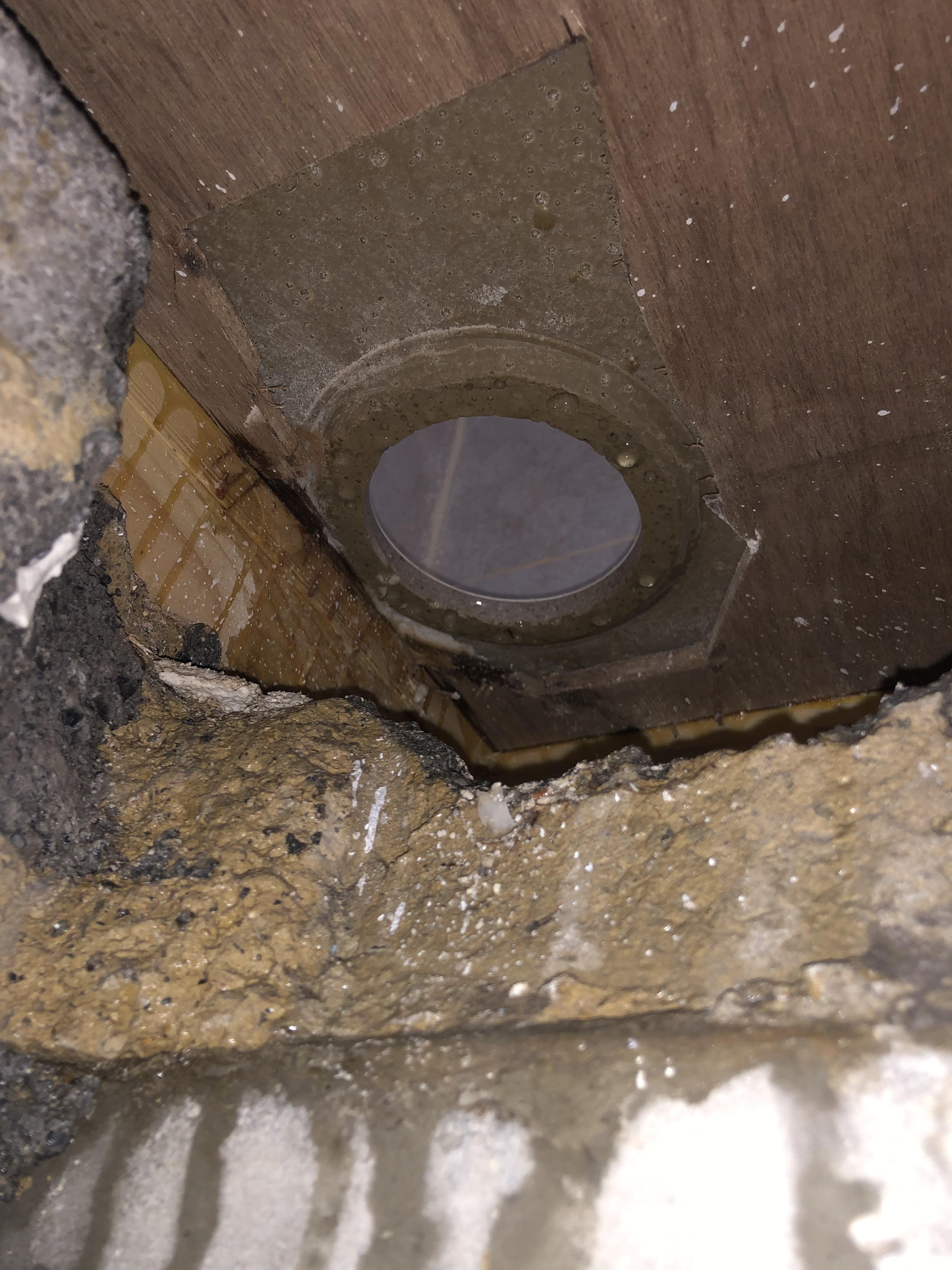

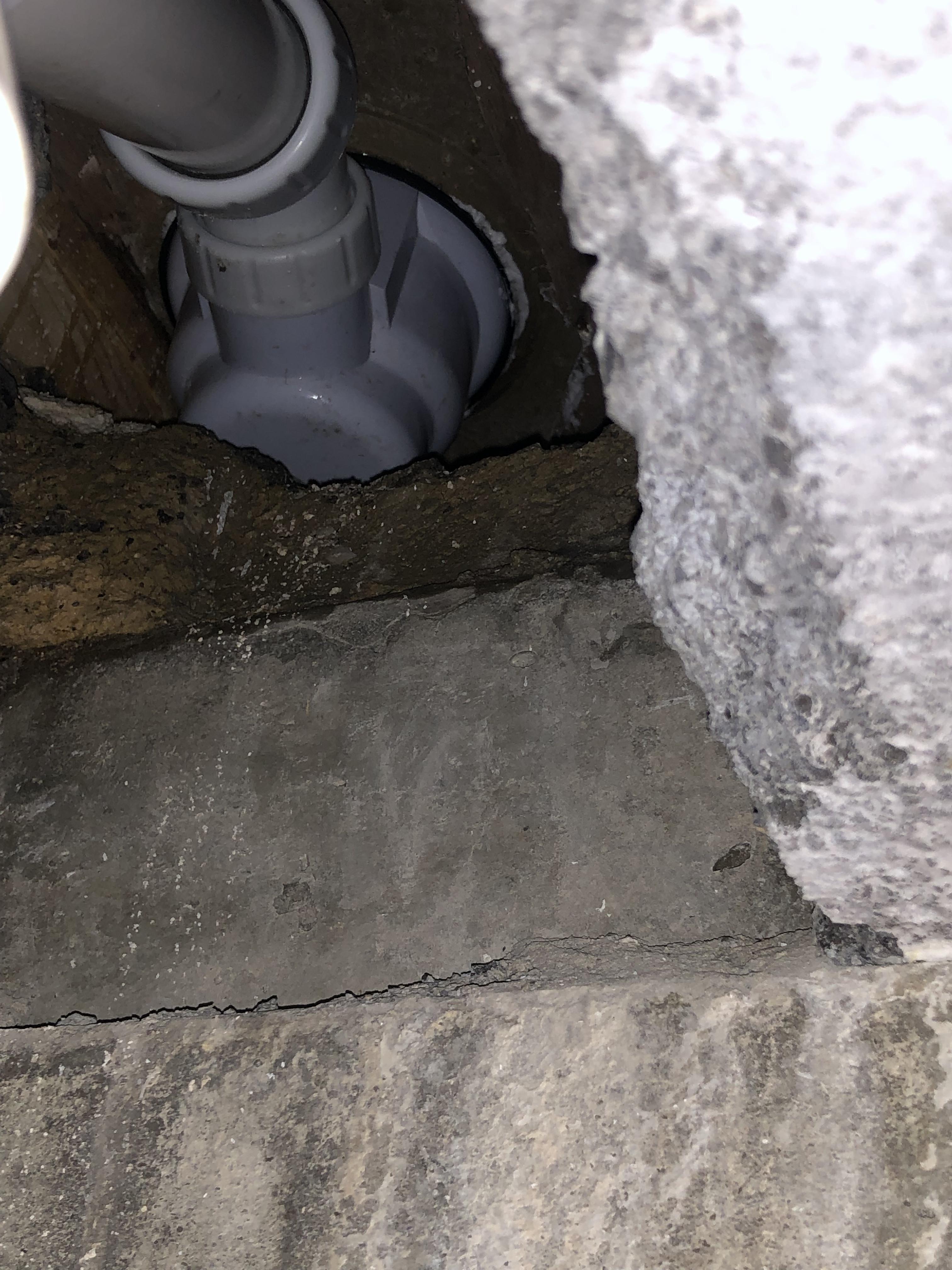

Pocster Posted November 27, 2021 Author Posted November 27, 2021 Still leaks ffs ! Now what ? Try getting it out ? Try smearing perhaps tiger seal around the trap to tray joint ? - but as you can see I can’t see the other side of the trap . It’s above beam and block and then beyond it is steel ?
