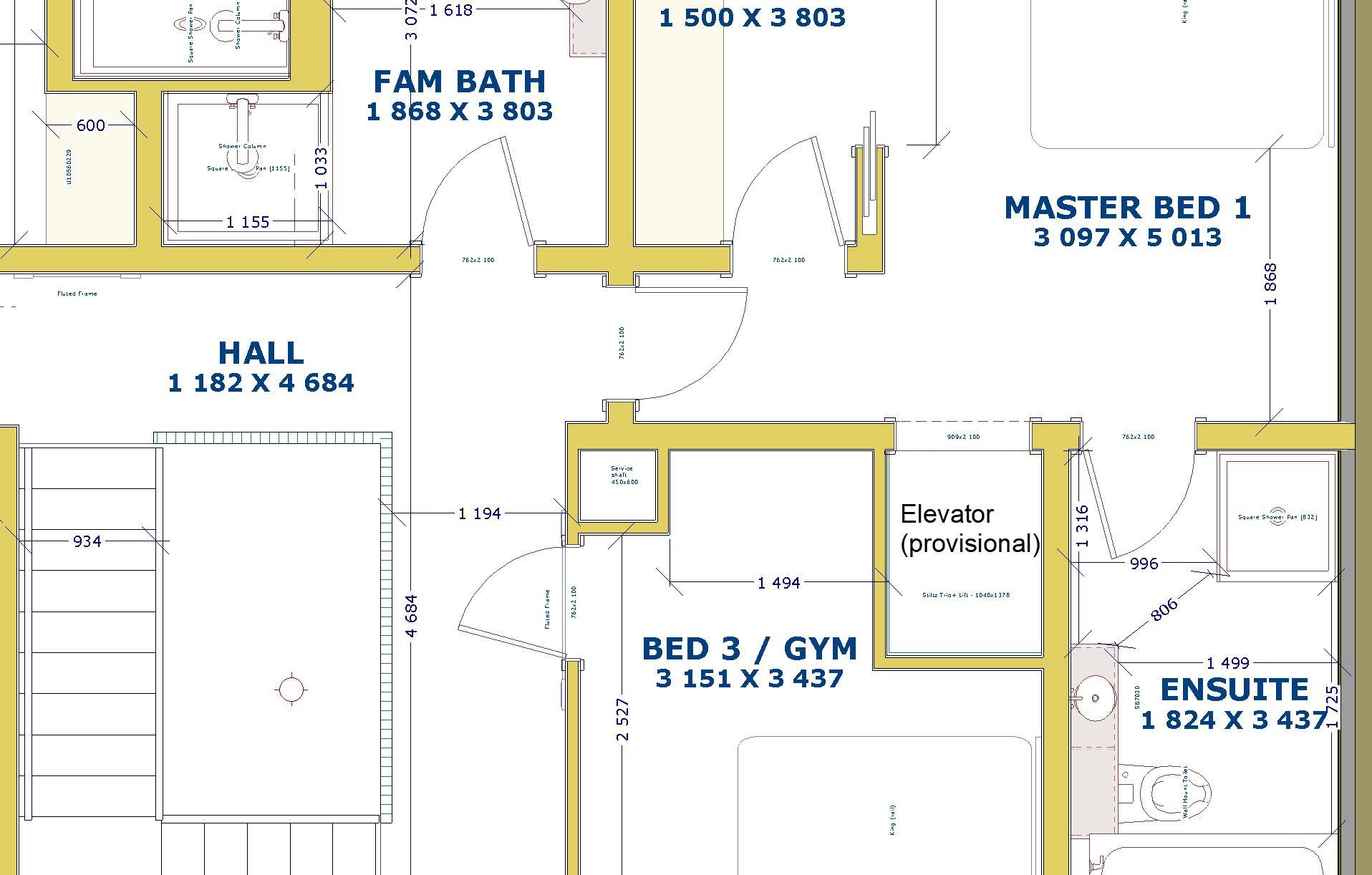

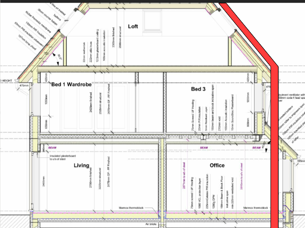

For what it's worth, this is how the "elevator situation" would look like.
While indeed there is a certain extra amount of walkway, I'm not too certain if the elevator can be anywhere else. Perhaps the onlyl thing I could imagine is swapping the service shaft with the elevator but the shaft needs to be as central as possible. Also moving the elevator down would clash with ground and loft layouts..
1 hour ago, Mike said:
  • if you're thinking ahead to a possible lift, it might be worth enlarging the doors so you could at least get out of Bed 3 and into the bathroom in a wheelchair
Good point, to be clear - as above you'd have to get out of master bed. But yes, master and bath should have slightly larger doors

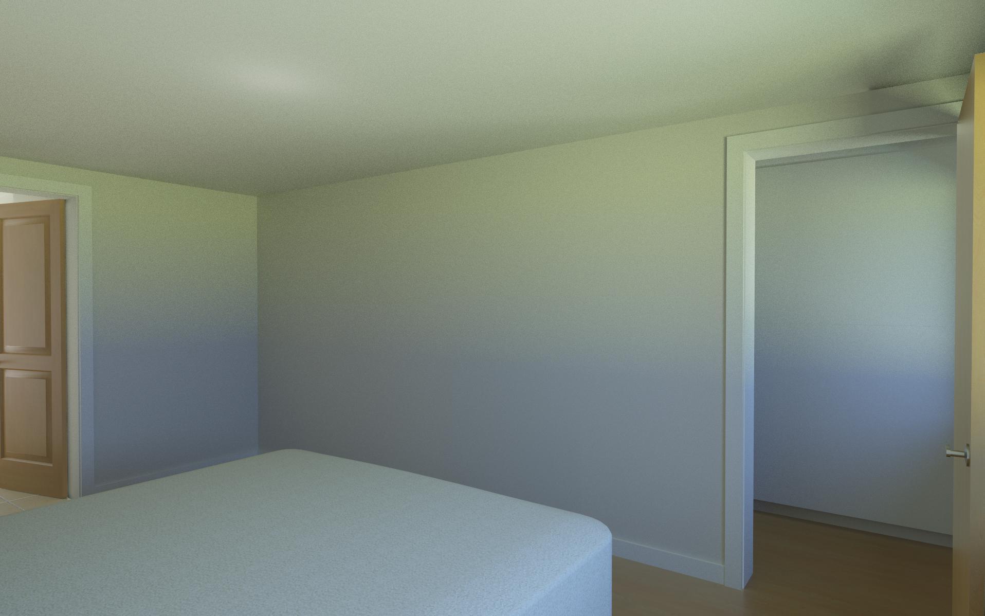

  • ditto removing the recessed doorway into Bed 2
This is the difference (while standing on the through-walkway on the ground floor)
If Bed2 were cramped I'd agree but it's not, and this costs 1m2.. not huge?

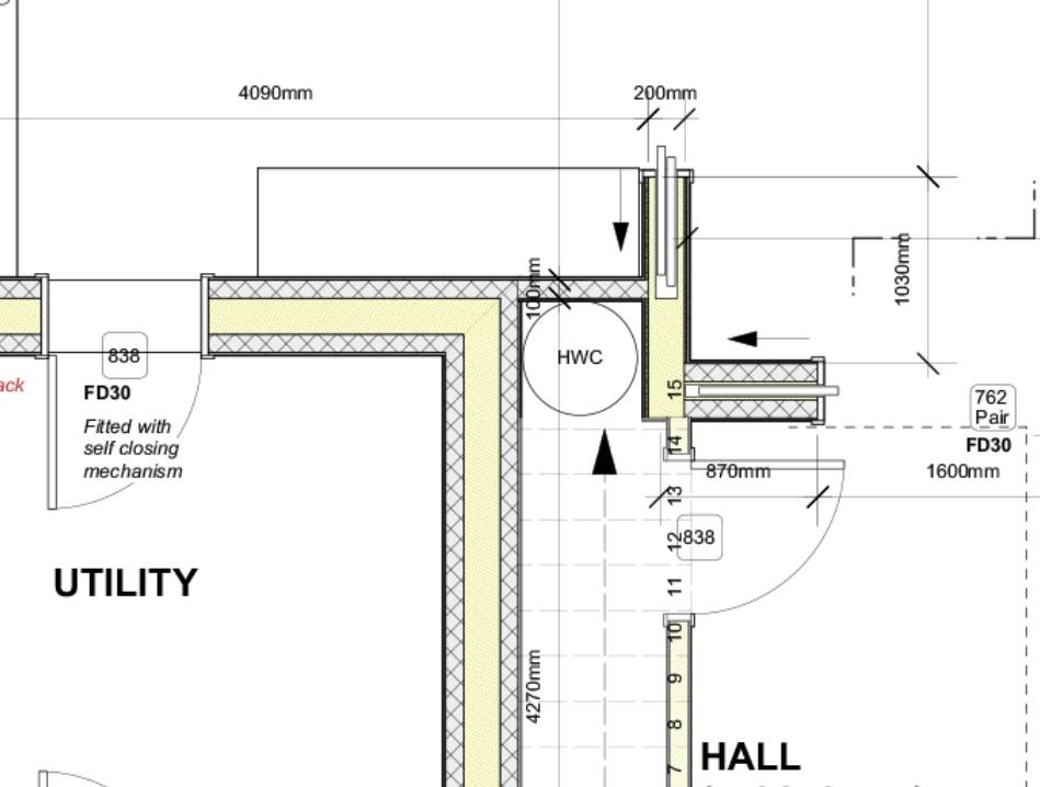

  • moving the HWC - you're unlikely to get a well insulated one of adequate volume into the space planned - into the utility room, which I presume will hold other other plant
Well, assuming you mean here:
then yes that will actually exactly fit the HWC we have in mind! Checked with manufacturer and everything. But, to keep plant together we still are likely going to move it to the loft plant room anyway

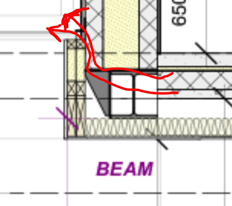

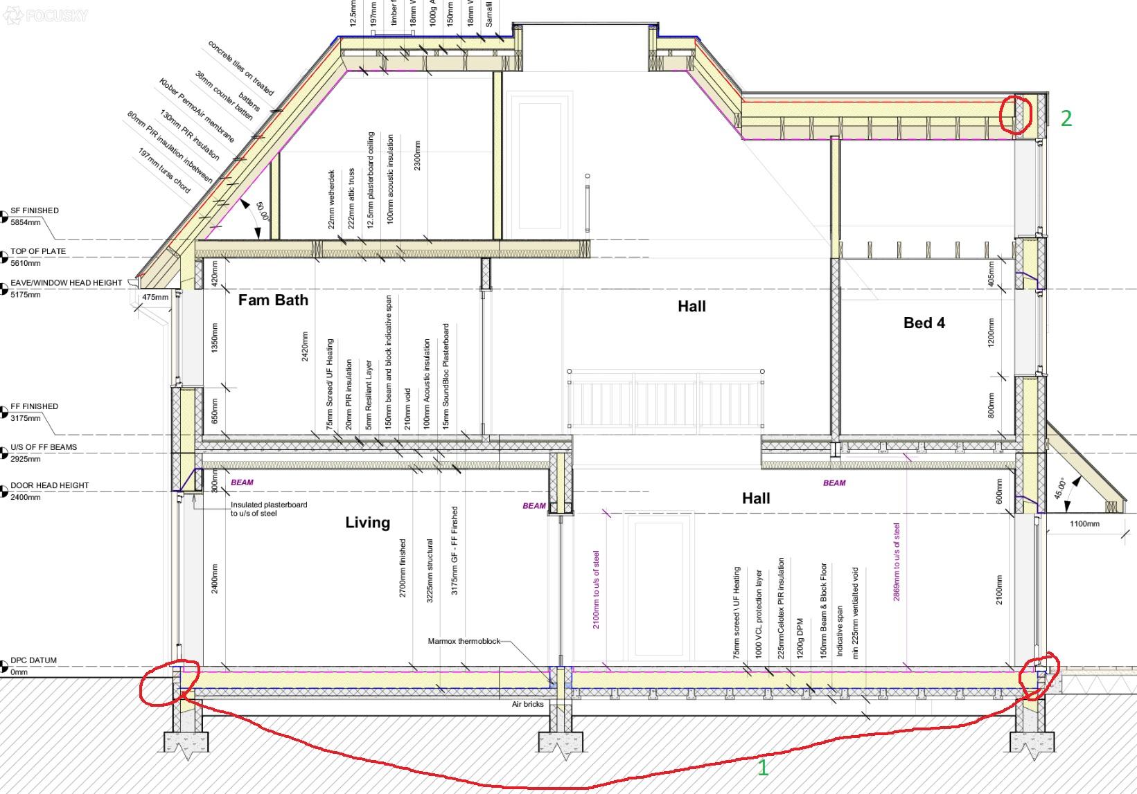

Thermal bridging isn't rocket science. You just need a completely continuous layer of insulation. If you can draw with a pencil anywhere on the plans where you can go from inside without bumping into a good layer of insulation you'll have a thermal bridge. Concrete is bad, steel is terrible.

5 hours ago, puntloos said:
Perhaps the only thing I could imagine is swapping the service shaft with the elevator but the shaft.
That's what I'd choose.
Not if you turned it 90° to open on the landing(s).

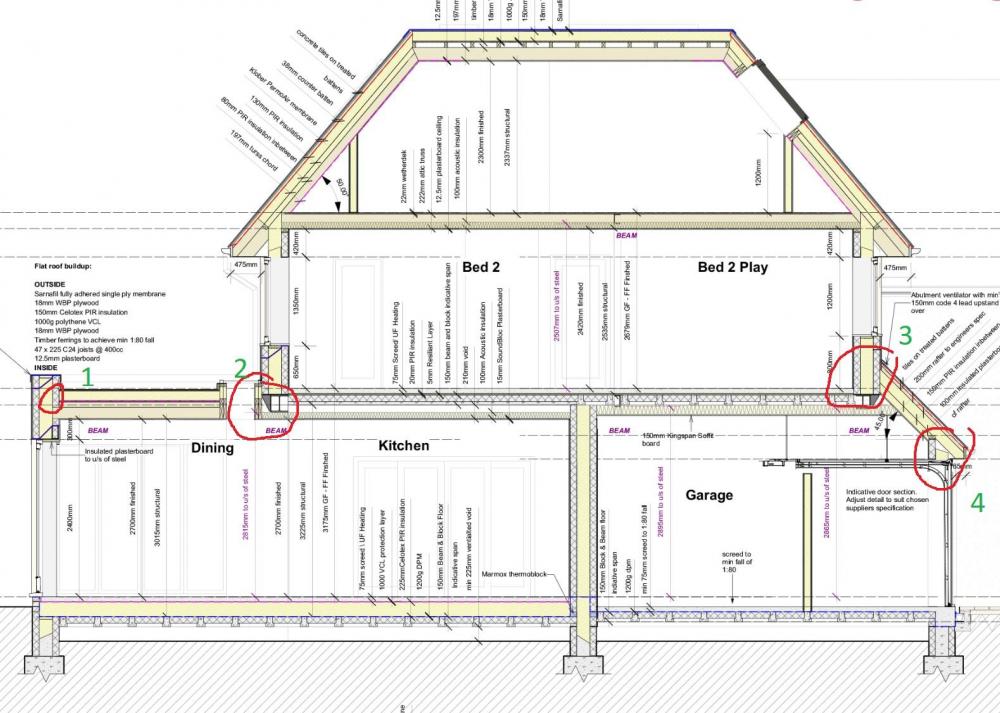

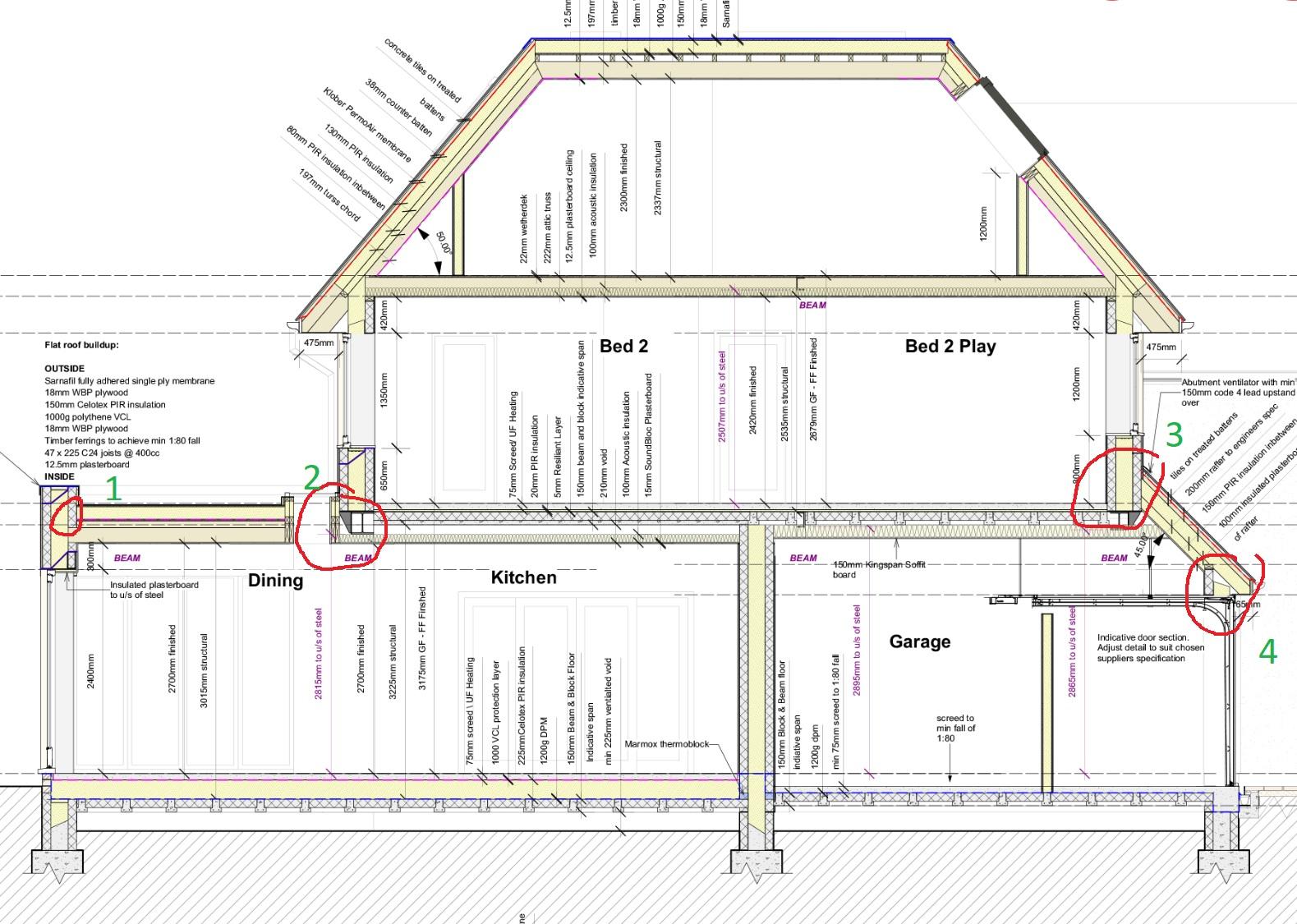

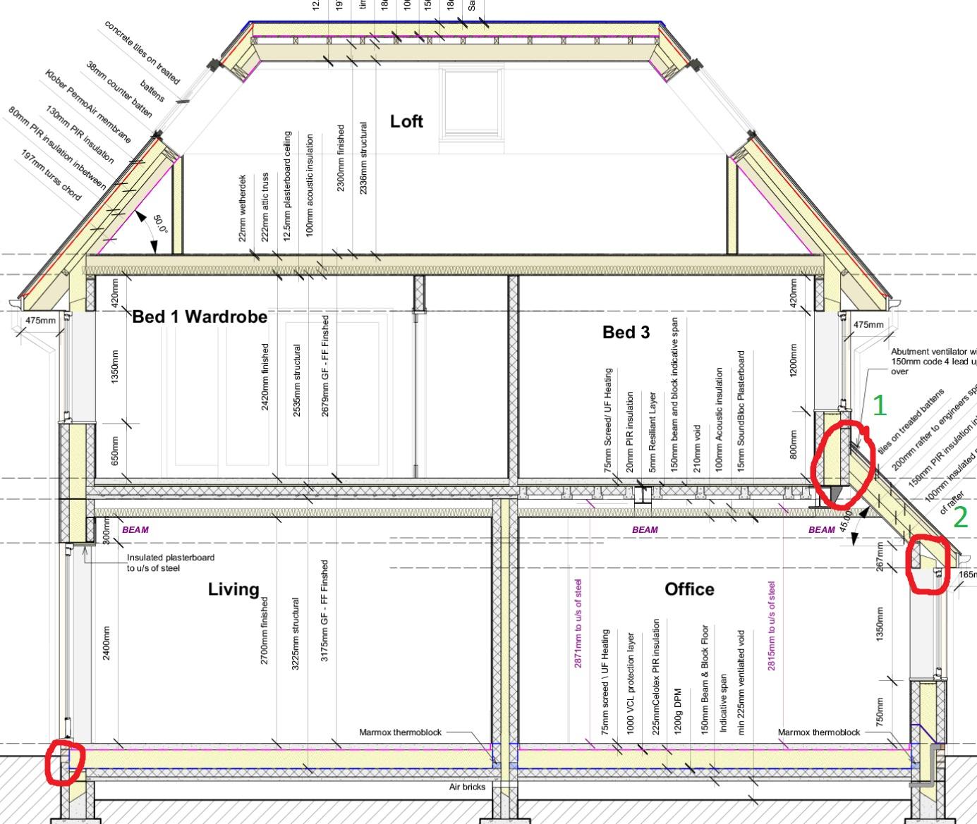

Good example.. I don't know if I personally should try to do the non-rocketsciencey homework.. but in general, how does one go about resolving these? A thermal expert architect? A builder who knows how to fix this? I do have some passivhaus builder who's helping me with this stuff (for a fee) so I suppose I could ask them..
A few general questions: the "looking for the continuous yellow" exercise of cold bridge finding turned up nothing on the floorplans (except 'all windows').. but I assume that's somehow fine?.. or?
The sections, as you point out, are much more messy:
Below:
1 - probably just add a thermoblock
2- thermoblock?
Below:
1 - Thermoblock
2 - Unknown, not sure why this is done this way?
3 - thermoblock, or at least make the wall not go there?
4 - Is the 'air gap' a problem?
In general I hope someone is able to fix this as  well as possible rather than redo ;)

On 22/11/2021 at 19:51, puntloos said:
The only snag is that at the loft, there's empty space there (no landing). It'll be a few meters straight down ;)
If I was to take the lift up to the loft, then I'd add a helter-skelter. Though if Building Control are really insistent I might just settle for a landing :)

On 21/11/2021 at 18:17, ETC said:
Oh! I completely forgot that you had updated a few designs, sorry @ETC . The lift location is a good suggestion. Your exact location doesn't work because of the loft (it would hit the ceiling) but if I provision the elevator where the ground floor office door is, that would work. We'd have to move the office door down towards the front when installing the elevator but that's not a huge deal!
The circulation space, I think I prefer the recessed aesthetic (pictures above) over the slight extra space for the bedroom I think.
I think you said you've done a PHPP model? If done properly (and/or reviewed by independent PH certifier) that should flagged it.
We had detailed THERM models done for the various potential issues flagged, and iterated on a few of them to reduce the impact. The concern was generally less about the energy losses, and more about the cold bridge causing condensation magnet and possibly encouraging mould/rot to form in the service void hidden behind the plasterboard, or in the wood flooring around the front door. So worth getting right!
