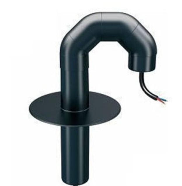

Am about to finish the flat roof!!! Need a few holes:
1) 1 x svp
2) 1 (or more) for: aerial cable, future solar panel cable, possible future air con pipe/cable

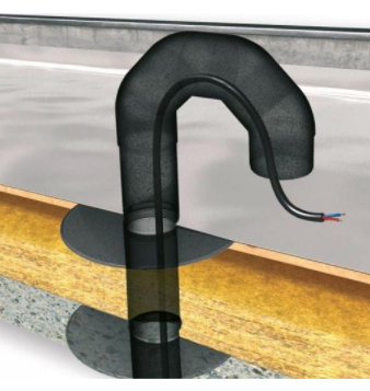

My question is - would a 100mm one like below be sufficient for item 2?
I was thinking to put a large block of PIR into each end to minimise air leaks - not sure how perfect that can be though.
Is there a better/simpler way to do this?

AC pipework typically goes through a 70 mm diameter hole ... including the drain pipe and the insulation and the cables etc
It'll either be 1/4" and 3/8" (mine is .. and runs through an old silicone sealant tube through the wall along with drain and cable) or 3/8" and 1/2" depending on size.
Insulation is about 15 mm thick and soft.
100 mm you could almost throw it through. ?
Buy from the likes of Saturn air sales if you want to preinstall. Leave oodles of slack. Flare some brake fittings and bleed nipples onto it for closing it off. Or pinch shut/bash flat, fold over on itself, and seal with a blob of solder. Don't get flux inside it.
1.5 mm x4 core more than enough for most ac units. (most power tends to be supplied to the outdoor unit, with only a little power needed by indoor unit)
Throw 5 core 2.5 mm SWA up and out to cover all possible scenarios...or just a good bit of UV resistant rope/galv fencing/draw wire. (most rope dissolves in UV by the time you get roundtuit)

Many thanks @markocosic most helpful. I've gone and bought a couple of swan neck penetrations kits which seem well made, if expensive for some moulded plastic. seems like that will be more than enough.
They are demountable so for now I can install this with a duct running down to a service cupboard and a drawstring taped inside for later use. Will cut some sections of PIR to fill in the tubes to avoid ventilation losses etc in the meantime. Will check with my electrician as mentioned earlier re cable prep to ensure safety/compliance.
The detailing on the single ply seems to be excellent and they can install a well made section to cover this and weld it to the existing membrane so although penetrations are not ideal I'm OK with this based on what I've seen so far
