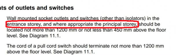

cwr Posted November 8, 2021 Share Posted November 8, 2021 So, buildings regs are nice and clear regarding heights of sockets, light switches etc. This is good. The internet, great thing it is, is full of additional advice and recommendations... For example, there's a few sources that recommend min 350mm for sockets from corners. Is this a regulation or just good practice? I've tracked a few at 200mm, so hoping the latter. There's also various recommendations for heights of sockets above kitchen worktops. Keeping within the 1200mm limit of course, what would be advisable? Thanks Link to comment Share on other sites More sharing options...
ProDave Posted November 8, 2021 Share Posted November 8, 2021 Scottish regs have the minimum distance from an internal corner and slightly different height limits. The important thing is these regs only apply to general purpose sockets, so you are allowed high up sockets dedicated to a tv or projector for instance. Link to comment Share on other sites More sharing options...

cwr Posted January 31, 2022 Author Share Posted January 31, 2022 I screen shotted it out of NI building regs. Link to comment Share on other sites More sharing options...
Mike Posted February 1, 2022 Share Posted February 1, 2022 On 08/11/2021 at 20:31, cwr said: there's a few sources that recommend min 350mm for sockets from corners That's not a Building Regulations requirement for regular homes, though I wouldn't normally put them closer than that anyway. On 08/11/2021 at 20:31, cwr said: There's also various recommendations for heights of sockets above kitchen worktops If you can plan far enough ahead, coordinate the positioning - vertically and horizontally - to suit your planned wall tiles (if you're planning to have any). For light switches, I always have them coincide with the axis of the door handle, where possible. Link to comment Share on other sites More sharing options...
ProDave Posted February 1, 2022 Share Posted February 1, 2022 7 hours ago, Mike said: If you can plan far enough ahead, coordinate the positioning - vertically and horizontally - to suit your planned wall tiles (if you're planning to have any). Last time I did a tiled kitchen, I left long tails on the sockets and temporarily surface mounted them. Only when I did the tiling did I cut the final socket box holes to line up with the tiling and flush mounted them. 1 Link to comment Share on other sites More sharing options...
MortarThePoint Posted March 12, 2022 Share Posted March 12, 2022 Interesting that NI building regulations limit the requirement to the entrance and principal storey, i.e. the ground floor in most cases. Not so for the English Regs which apply to all habitable rooms so include first floor bedrooms. 1 Link to comment Share on other sites More sharing options...
