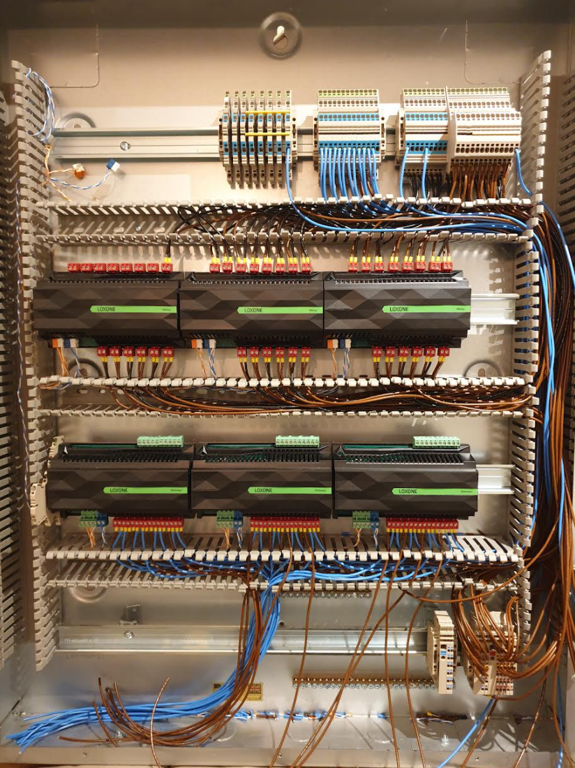

Hilldes Posted November 16, 2021 Author Posted November 16, 2021 On 15/11/2021 at 00:15, Dan F said: @Hilldes Did you decide on a colour code? Off the top of my head (but welcome advice)... 230v - brown and blue. 24v power supply - Orange (+ve) and white (-ve) as per Loxone. Loxone Tree - assume using pairs extracted from Cat6 so green and green/white. Loxone link - assume using pairs extracted from Cat6 so blue and blue/white. RGBW 24v - using this cable from cabinet to LED strips. Hmmm colours of cores in this cable are: Brown, Black, Grey, Blue and Green/Yellow. Not sure I could used these colours inside the cabinet.
Dan F Posted November 16, 2021 Posted November 16, 2021 I've been taking a look at this too: 4 hours ago, Hilldes said: 230v - brown and blue. Some people use black rather than browm, but (light) blue is a must, as is yellow/green for earth. 4 hours ago, Hilldes said: 24v power supply - Orange (+ve) and white (-ve) as per Loxone. This one is interesting: - Loxone use orange/white. - The US (and the old version of the IEC standard) use red/black - New IEC standard is brown/grey - EN 60204-1 recommends dark blue + white (with blue). Most people seem to use a mix of red/black (tri-rated) and orange/white (twisted pair) in practice from what I've seen.

Hilldes Posted November 25, 2021 Author Posted November 25, 2021 Many thanks for the replies @joth, @Dan F, @Rob99. Next step for me is to think about how I'm going to fit everything in the (LXN4) cabinet. Here are the totals for incoming cables: 48 x 1mm2 T&E 6 x RGBW 1.5mm2 4 core Flex 28 x CAT6 Assuming the T&E terminal blocks occupy 10mm of DIN rail each, that is 480mm of DIN rail for these alone.
TonyT Posted November 25, 2021 Posted November 25, 2021 You get double deck din rails that 1 rail could house 1 L&N.
Hilldes Posted November 25, 2021 Author Posted November 25, 2021 10 minutes ago, TonyT said: You get double deck din rails that 1 rail could house 1 L&N. Thanks @TonyT, will take a look at this, but the cabinet is quite shallow.
TonyT Posted November 25, 2021 Posted November 25, 2021 Sorry forgot to add link https://www.cablecraft.co.uk/double-feed-through-connectors-accessories?gclid=Cj0KCQiAhf2MBhDNARIsAKXU5GTMkbdlyflRJF-orjl4oomaVuzPnoYN4qzsSV06zkPgKB3NobtypvUaApssEALw_wcB it doesn’t add that much extra.
Rob99 Posted November 25, 2021 Posted November 25, 2021 2 hours ago, Hilldes said: 48 x 1mm2 T&E Yes, use double/triple deck terminal blocks. I use the Wago 2002 range which are the push in type (screw terminals are a pita) and are 5.2mm wide. You can mount the DIN rail to the back of the cabinet if you need to create more depth for the terminal blocks. You can get around 100 of the Wago terminal blocks on a single LXN DIN rail. 2 hours ago, Hilldes said: 6 x RGBW 1.5mm2 4 core Flex Why 4-core? For RGBW you need 5 surely. Again, use the same double or triple height terminals, in blocks of 5 to connect all cores on a single level. For example you only need 10 triple height terminals to connect all 6 RGBW. 2 hours ago, Hilldes said: 28 x CAT6 Wow, thats a lot of cat6! Do you need all 224 cores to connect into your cabinet, or just some of them? I would terminate cat6 outside the cabinet on a patch panel or a 110 block and then only bring into the cabinet the cores you actually need. 1

Dan F Posted November 25, 2021 Posted November 25, 2021 5 hours ago, Hilldes said: Assuming the T&E terminal blocks occupy 10mm of DIN rail each, that is 480mm of DIN rail for these alone. Most terminal blocks (apart from the 8-level ones) are just over 5mm wide each. Wago also do the T&E terminal blocks with the earth "foot" which would address your previous question to. What I did before I built anything, and before buying most terminal blocks, was to: - Choose a terminal block manufacturer. - Study the product range (sticking to 2.5mm push-in reducing reading time) so you understand what's available including multi-tier blocks, and those with earth incorporated. - Design the layout using the manufacturers design-tool to make sure everything fits and then export a shopping list from the tool. 5 hours ago, Hilldes said: how I'm going to fit everything in the (LXN4) cabinet. Here are the totals for incoming cables: Assumung you can get all terinal blocks on the top row, how many Loxone extensions do you have? Will these all fit on the two middle rails, leaving the bottom rails for PSU's and RCBO's?
