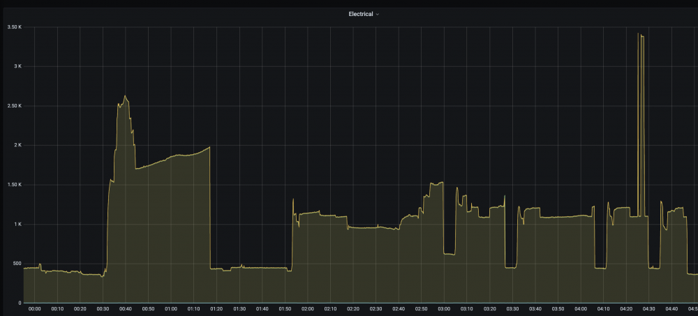

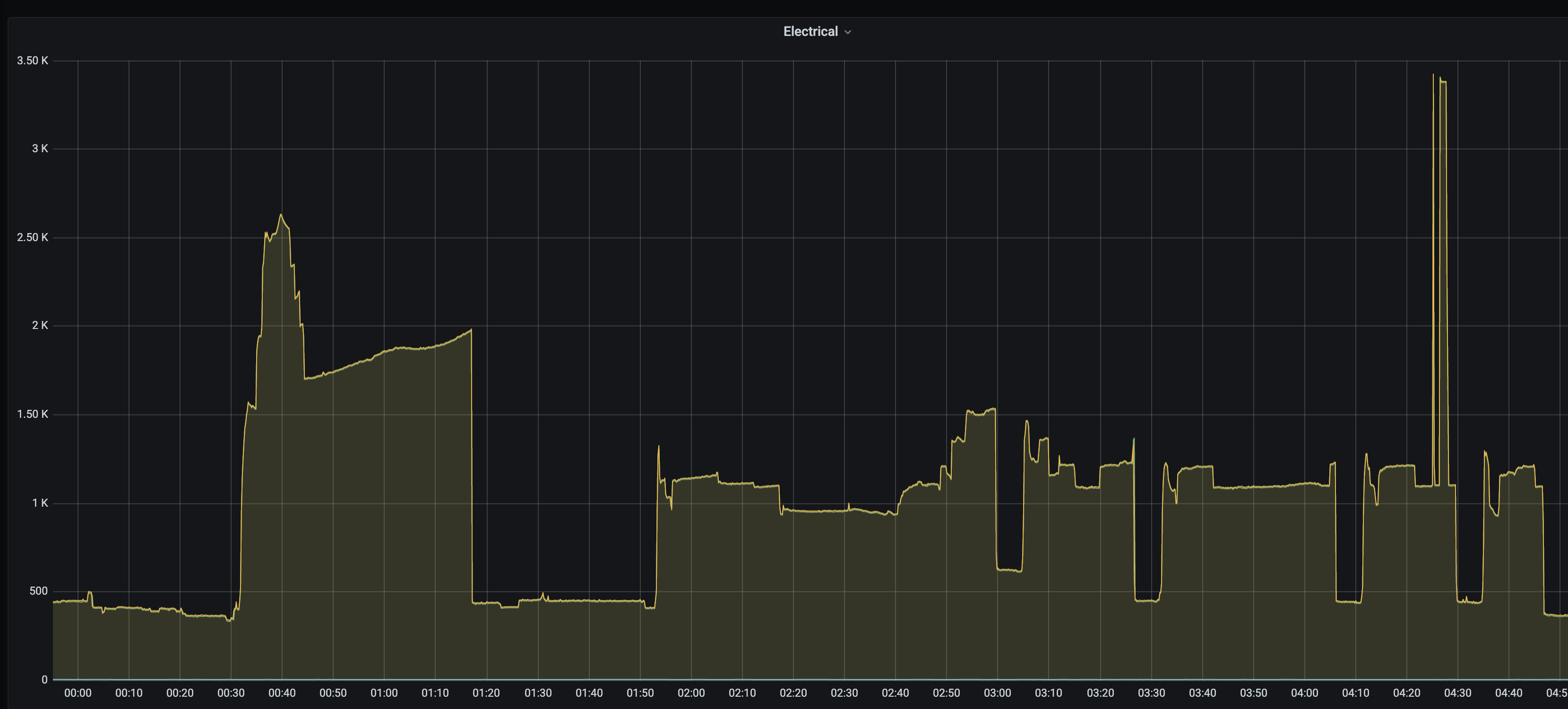

The 30mins is based on the power consumption graph. e.g. here you see the DHW run from 00:30 to 01:17 and then it's all systems idle until 01:52 the UFH starts running. So yeah, 35mins idle ?
The tank temerature graph also lines up with this - it reaches target temp right on 01:17 so isn't any overrun while the pumps circulate to get it finally to temp or anything.

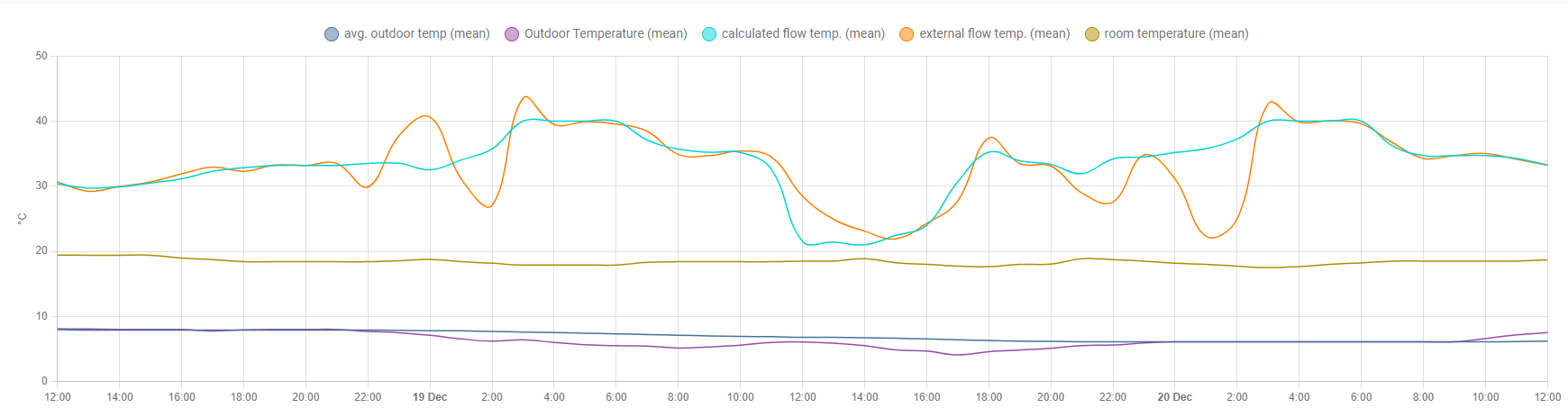

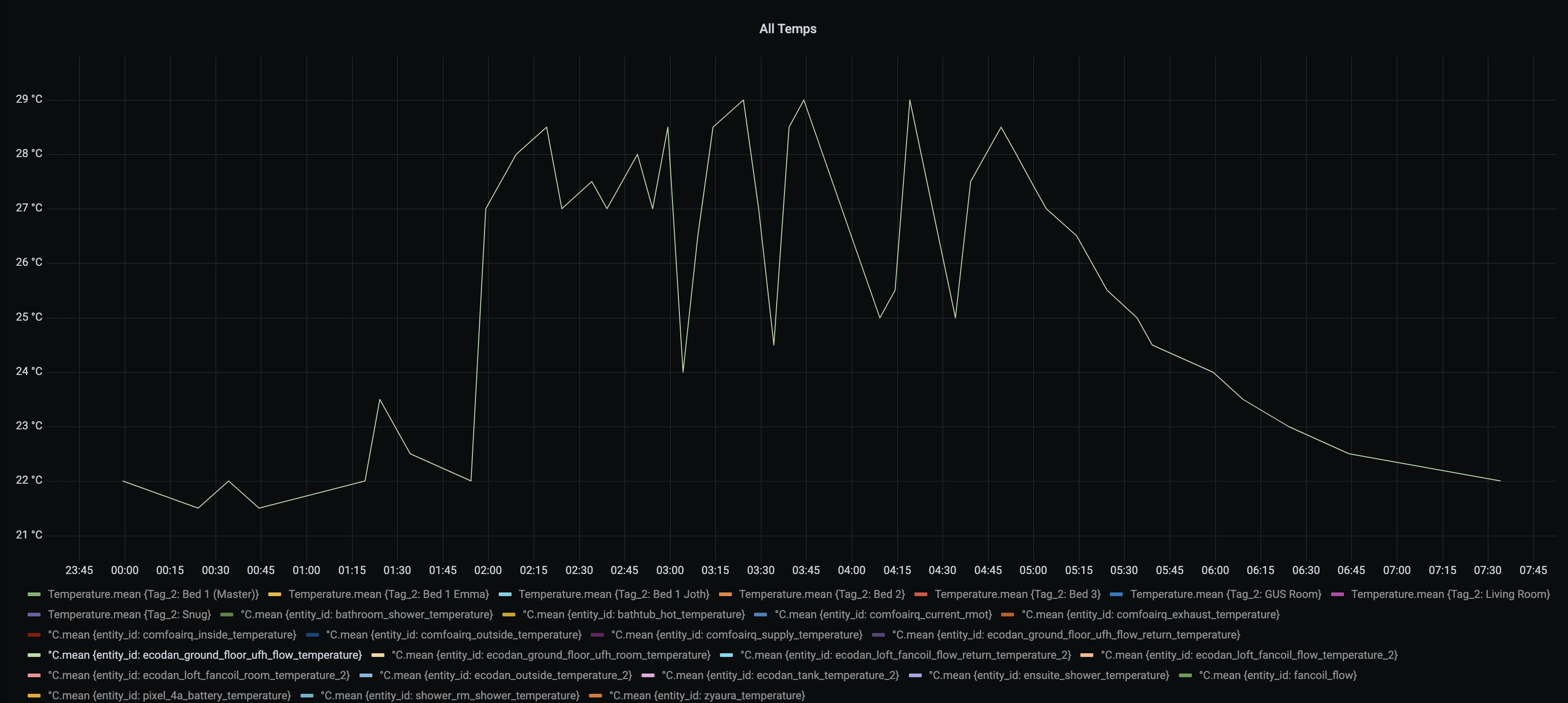

Ah good thought, I think it could well be something along these lines. This is the UFH flow temp at the same time
1235743964_Screenshot2021-11-05at17_15_34.thumb.png.89118f5e812a26e7a4416b07694046ea.png
There's a small slug of 23ºC water at the moment the DHW turns off 01:17, then at 01:52 it starts running the UFH proper. If for some reason that initial slug is just as the electronic mixing valve shuts down, it will indeed take a bunch of time for the water to cool if it's just circulating in the primary circuit and low loss header. (I definitely wish we'd put a large buffer tank in, as then this would be filling that up, rather than most likely being wasted to outdoors in the external pipework.)
And again I think you're right that running the DHW at the end of cheap rate is going to be the only/best way to solve it. I've not programmed it to do UFH first and if that reaches target it will do a "boost" on the DHW. I need to program in an extra test that if the tank middle stat temp is too low (below 40?) it will force override the UFH with 30mins of DHW from 0400-0430

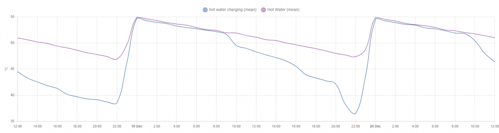

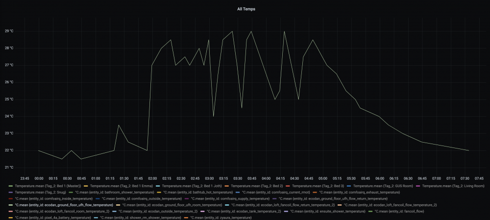

Just to close the thread here: setting the DHW to heat at 4am for 30mins mostly solved this, giving me 3.5 hours of cheap rate heating (octopus Go) followed by 30min DHW heat up with no time wasted in system cool down.
One thing I found was my dry-contact relay control was a bit blunt and also messed up historic charts making it hard to see what was going on (as I was descreasing the thermistor reported resistance to emulate a "setback" temp, which causes it to report a higher tank temperature than actual).

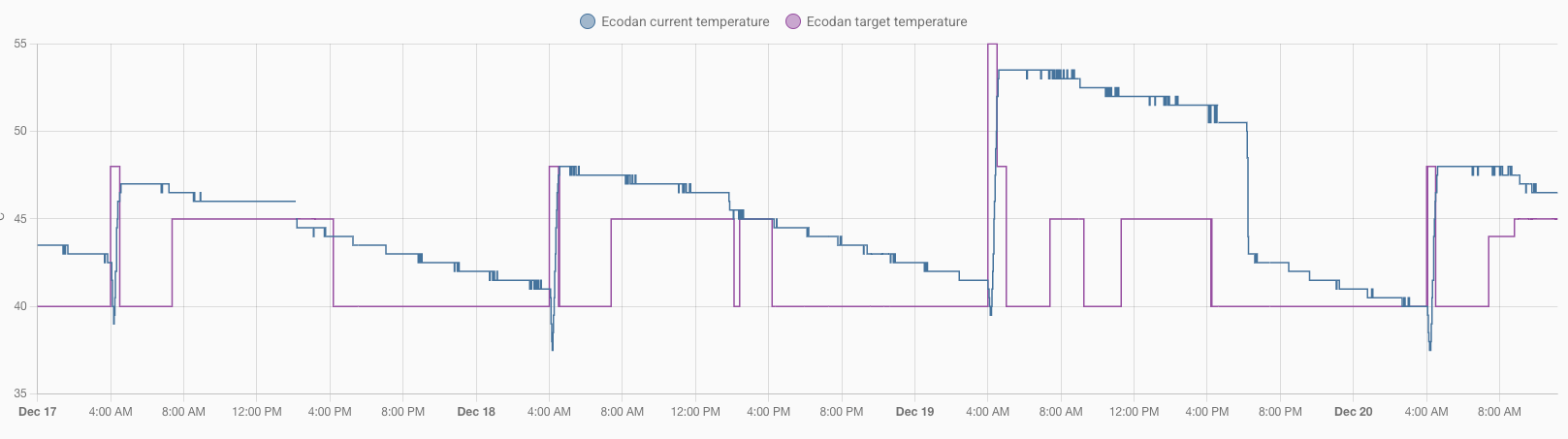

 So I've switched to a 100% software approach: the Home Assistant Ecodan integration works very well to set target temp and also enable "force heat hot water mode".  So I now have very fine control, based on the electricity price, PV generation, number of people staying in the house, and forecast sunshine for the coming day, I can tweak the target temp from 40 right up to 55C, set force heat mode, and turn on the immersion heater as needed.
Here's a few days of it working nicely. (Spare room was in use on the 19th so you can see the elevated target temp at work, and some extra showers in the day causing a larger DHW draw off)
