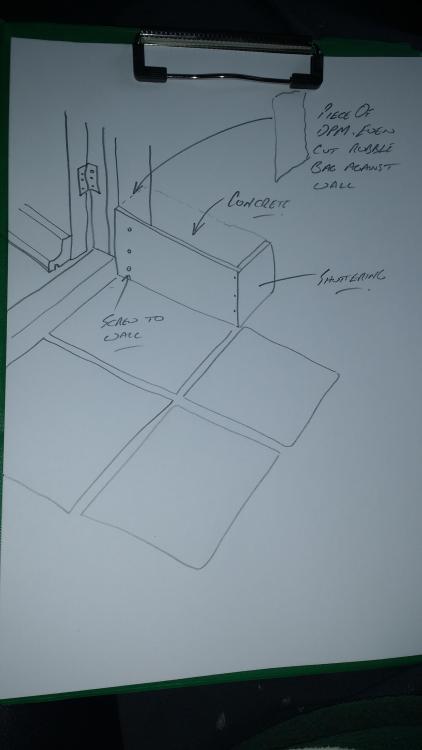

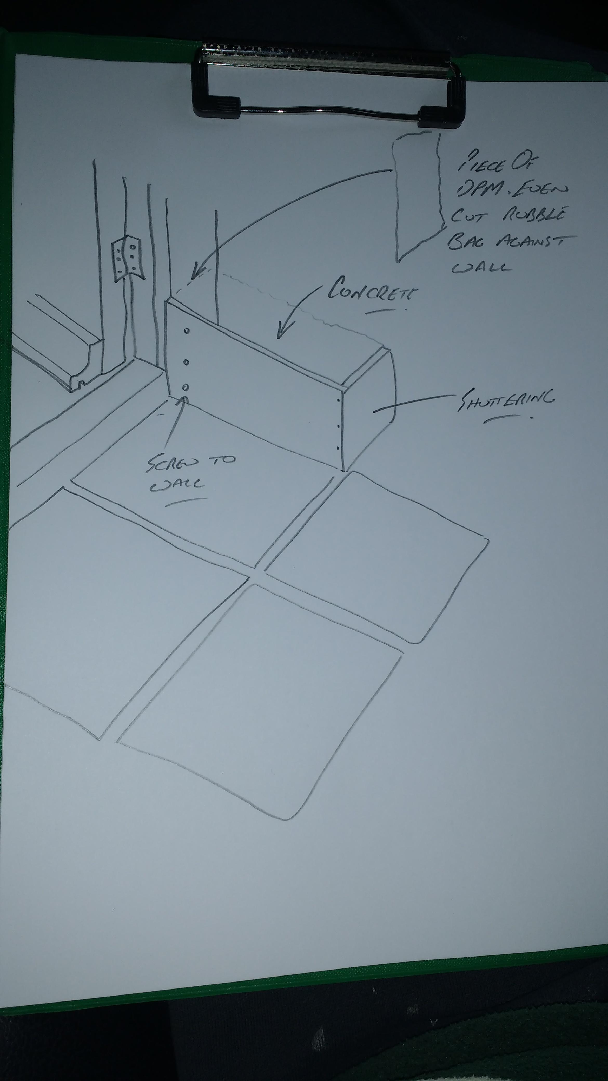

Onoff Posted November 14, 2021 Posted November 14, 2021 Just make sure to clean that rough face really well of any moss, algae, little seeds etc. I'd add water proofer to the mix. If you do you could probably do away with the bit of DPM. 1 of cement, 4 of all in one ballast. Belt and braces would be to drill the existing face and put some Rawlplugs in with stainless screws poking out for the new concrete to key onto. How thick will this new facing/tidy up piece be?

zoothorn Posted November 18, 2021 Author Posted November 18, 2021 On 14/11/2021 at 10:56, Onoff said: Just make sure to clean that rough face really well of any moss, algae, little seeds etc. I'd add water proofer to the mix. If you do you could probably do away with the bit of DPM. 1 of cement, 4 of all in one ballast. Belt and braces would be to drill the existing face and put some Rawlplugs in with stainless screws poking out for the new concrete to key onto. How thick will this new facing/tidy up piece be? Hi Onoff. Thanks fir this I wondered how shuttering works.. so Id need to drill into my stone coin to get rawlplugs in to fix the ply sheet? I can hear the welsh miner ancestors ( my builders' in fact, so small a community it is, & deep links go back) complaining.. hmm. I might go Joe90/ markc's idea & see if Ican live with it, then if not come back to this idea. Id prefer on paper your idea. Cheers. An Onoff sketch gets me all revved up/ where's me spade?! Step down ti do 1st. This the finishing job. Thx zh
zoothorn Posted November 18, 2021 Author Posted November 18, 2021 On 14/11/2021 at 12:19, markc said: Got to agree, the reason I would clean out the loose from underneath and stabilise the soil with concrete or similar. I used the term underpinning loosely to try and describe what I was thinking. I tend to agree now too perhaps. Last small job. Mark just got my step down to do first: Is this plan any good? I need to build up the ground you see under the RHS step, as it slopes right down this side, so maybe skim off ground level with my 4 slabs this RHS, then put a block down ( presume the same sandcastle mix bed ). LHS step ground underneath seems well compacted enough. Slab ' halves ' on, then stone bits mortared in behind to the deepen steps to maybe 12"... lastly cover the bare block visible side & front with mortar & slate bits. Steps w each = 450. Block w = 440. Thanks, zooter.
markc Posted November 18, 2021 Posted November 18, 2021 53 minutes ago, zoothorn said: I tend to agree now too perhaps. Last small job. Mark just got my step down to do first: Is this plan any good? I need to build up the ground you see under the RHS step, as it slopes right down this side, so maybe skim off ground level with my 4 slabs this RHS, then put a block down ( presume the same sandcastle mix bed ). LHS step ground underneath seems well compacted enough. Slab ' halves ' on, then stone bits mortared in behind to the deepen steps to maybe 12"... lastly cover the bare block visible side & front with mortar & slate bits. Steps w each = 450. Block w = 440. Thanks, zooter. Yes that looks like a good plan squire 1
